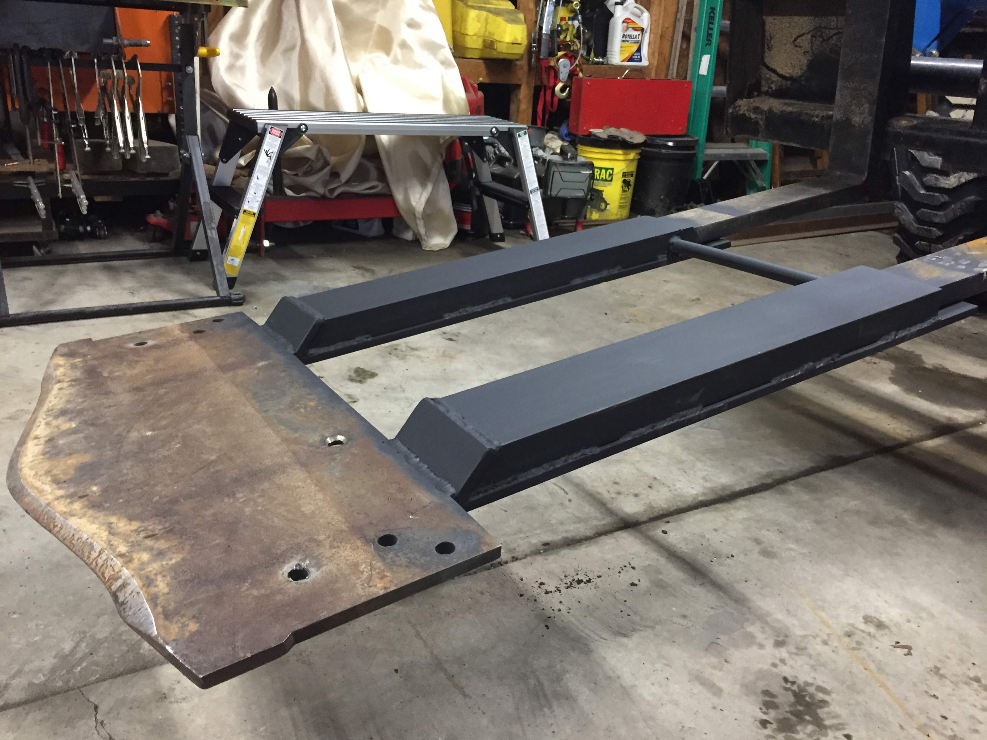

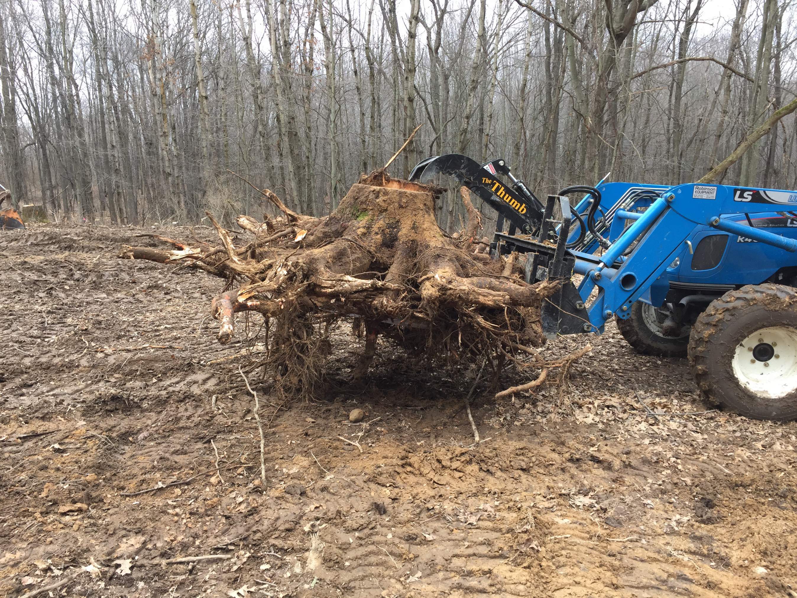

I would just invest in a set of pallet forks and do your digging and rooting with the forks and then pull the stumps out. I do a lot of digging and popping out small trees with just the forks. And you could build attachments to slip on the forks. I know it's not recommended, but if you know your limits it works good for me, plus the forks can be used for just about any other job you might have to do! I installed a "thumb" on my forks too. Disclaimer: (I didn't dig that stump out, I just moved it!!!!)
