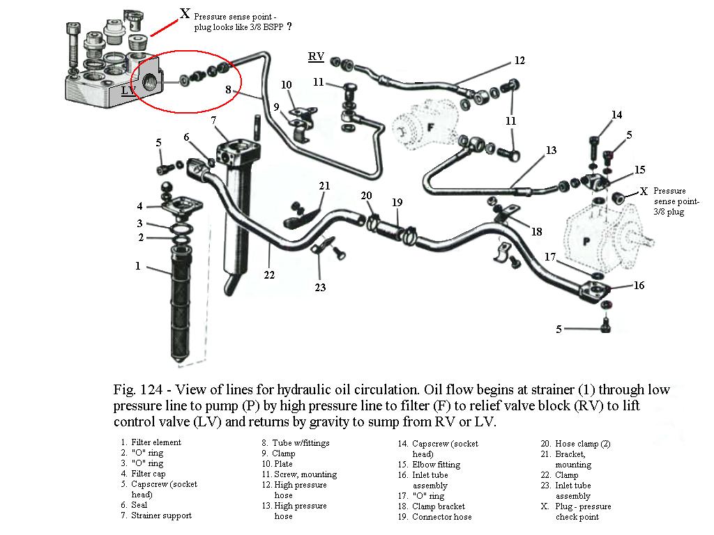

Starting project to add 4 more remotes to an old AC 160, planning to cut 12mm tubing just before the red-circled area in upper left corner of the attached drawing and insert this valve https://www.surpluscenter.com/item.asp?item=9SV-4-X&catname=hydraulic - am I correct in assuming that, since the tractor will be lucky to make 2000 psi and the valve is rated for 3000, that it will be OK inline with the input to the 3PH valve (the block to the left of the red circle) ??!?
The SCV in the link can supposedly be converted to PB, but I'm not sure what (if any) in my case this would do. Seems to me that, with the 4-spool valve, open centered, inserted BEFORE the 3PH valve, that any of the 4 spools would divert pressure to its cylinder and allow the other port of that cylinder to exhaust thru the OUT port of the SCV and on thru the 3PH valve and to tank.
Anyone disagree, and why? The valve, t-n-t cylinders and assorted fittings are either here or will be by tomorrow, hoping I don't need to send anything back :confused:

The reason you want to use PB is that that PB port is designed to handle high pressure.
Sure you could just do as you say, but you run the risk of failure when high pressure destroys your valve.
If you look at the specs on most valves, it will say return or OUT port , no more that 300 to 500 psi.
If your valve is in line and connected as you stated, and you cause the 3pt relief valve to activate to max, then you have put the 3pt relief pressure on the return port and all valves up stream. It is advisable not to do that.
On most hyd valves the return/OUT ports go to tank, as low pressure.
Items 12 and 13 are high pressure hose.
The area you have circled, is the port on hyd block LV a high pressure port?
You should order option Y which is PB end section. It is only $5 more.

Wow, 11 minutes til the guy I'd HOPED would respond - JJ, thanks a LOT. Your comments finally clicked, I looked at the specs again and finally realized what "Maximum Tank Pressure................... 500 psi" really meant. (duh)
Sooo, cut the line, pressure IN to the new valve, PB out back to the 3PH valve, and a SEPARATE out from the new valve's outlet back to tank (there's a 1" clear hose in that line where I could add a tee.
Closer, or am I still off? Steve

JJ, sorry I missed one of your Q's "is the port on hyd block LV a high pressure port?"
Yes, it is - it's the inlet to the valve (LV = Lift Valve) for the 3PH. It's the last pressure point in the system, and the ONLY place that's practical at all to tie into.
That 12mm tubing coming into the lift valve will be cut, 12mm flareless-to-#8 JIC male adapters inserted, then tubing/hoses run to inlet and PB of the new valves, and outlet of new valves back to tank.
