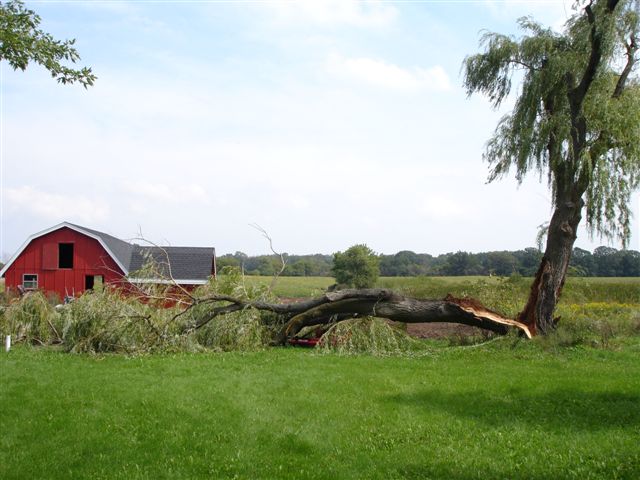

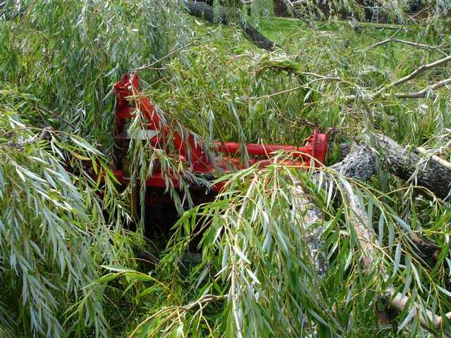

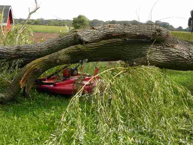

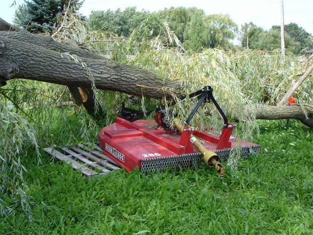

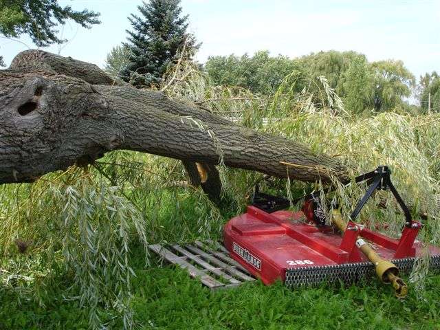

No wind, bright sunny day and this old rotten willow just fell without warning. My NH TN70A was parked right where it fell 2 hours earlier! Had the tractor been there, serious damage would have occurred. Instead, my Bush Hog, Tiller were covered but no damage. Missed everything by inches. Now, how do I get this thing cut a part and keep everything safe? I have an 18 inch chain saw.

Your 18" chainsaw should be plenty to cut up this tree. On the thickest parts, the technique is to cut from both sides.
Here's how I would tackle the task, apart from Randy's good idea. The biggest problem you face is how to get it all on the ground with no air space underneath any sections. It would be exceedingly dangerous to just start cutting. There is tremendous energy stored in that prone old willow. Without taking other steps, you would just be asking for a pinched bar and potential mayhem if you were to actually cut through a section, mainly from twisting forces.
I would use your tractor's fel. Hopefully you have hooks on your bucket. I would start by lifting the base of the tree, say 8' in from the end, by wrapping chain around the trunk and back to your bucket hooks. The tighter and closer to the hooks the better. The idea is to prevent the portion that you haven't cut from spinning/twisting off your bucket when you relieve the uncut portion of the weight of the piece you do cut off. You don't have to lift it high at all, just enough so the base end is off the ground.
Now you can proceed to make a top cut. Given that it's an old rotten willow, it is doubtful that you will have to make a cut all the way through, it will start cracking. Once it does that lower the bucket and it will probably break off. An alternative to this is to make an undercut, not very deep, maybe 1/4 or less, to establish a break point and lower the tree ubruptly to the ground. I consider this somewhat more dangerous since the trunk is likely to be hollow or rotten in the middle.
Regards the biggest branch in pic 1 and 2, I would place my bucket under the tops of that branch and see if you can't break or crack them enough to take the tension off. Once you have accomplished that you can cut that branch from the trunk. Make it easy on yourself, cut from what ever angle is most comfortable for you. Again, to take the pucker factor out of the operation, as Eddie put it, you can support the branch with chains/bucket, but don't lift it, you want gravity in your favor.
Repeat the above as appropriate. The main idea is to have a section hanging in the air when you cut it off. Once everything is on the ground, it's just cutting up firewood.
That's how I'd do it. Good luck.

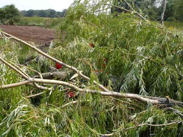

I would remove any small branches around the tops, cut loose, then take away, do not leave any slash under feet. best working with 2nd person diong this. start out near the tips, sutting the small stuff, untill you an get close to the main parts of the tree & to get the equipment out of harms way.
