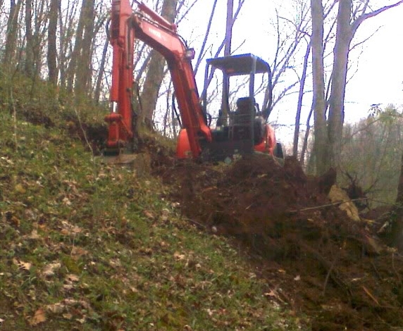

CalG & James have pretty much said it. My 27 acres is mostly on a hillside with a river below. The tractor has very limited access on the hillsides and also limited access in the riparian zone - both because of mud and lack of road. I can imagine using ingenuity to find ways of pulling logs 90% of the time with the drawbar. There will be situations where a simple winch pull will be the obvious solution due to terrain constraints.
