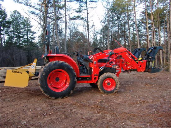

I am looking at adding an electric winch to my ever growing list of "must have" tractoring tools. Pulling logs and brush piles out of ravine around the property, pulling truck and car out of mud, and multiple other really good reasons (please help fill in the blanks here, my wife needs to really understand the huge return on investment I will gain from owning a winch). Several questions, will my 3130 electrical handle it? If so, quick disconnects the way to go front and back or, battery jumper style clamps, and best mounting system (Warn chain and plate system?). I am looking at the Warn 4700DC winch, Northern has as good of a deal $450 as I have found on the net. As always, thanks for any advice.
Finally, I have attached pictures of my new tractor at it's new home. Rory
