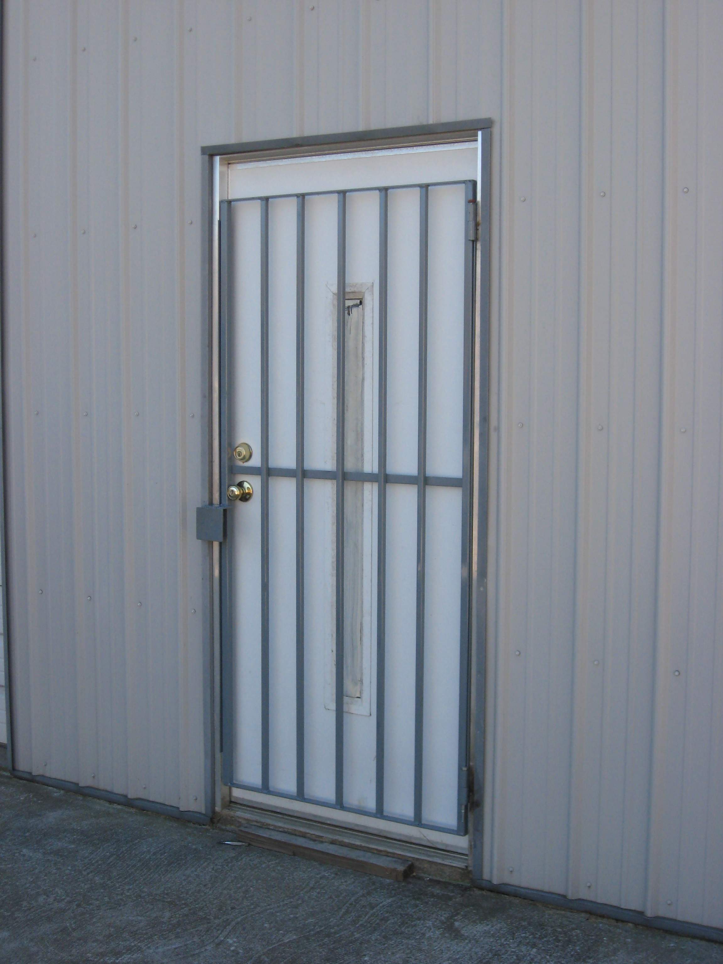

I built a security grille for my shop door out of bar stock and steel tube. IMG_3886.jpg
