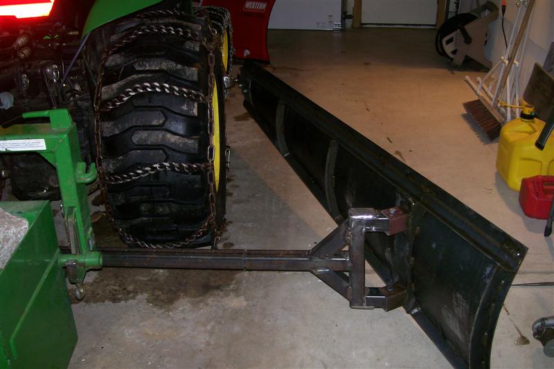

Finished fabricating the new wing plow for my Deere 4300 and gave it a trial run last night. It works great. Better than I had hoped for, with pencil design and good friend who is handy with welder and fabbing.
Is quick tach, only two pins to drop in and a chain to secure to the 3 ph lift arm. Will fit on either side and attaches only to the FEL post and to the drawbar. The push bar is telescoping (manual now) to vary the rear of the wing from 5 1/2 ft from tractor center to 8 1/2 ft.
Here is a pic from the rear, but will show more later when outside pushing snow.

yes, more pics on connections please. Very nice job. You'll move some serious snow that that set up.
   / Wing Plow #3
Thumbs up..oh yeah now I am drooling..more pics the better. :)
   / Wing Plow #4
That is cool! but it needs some hydraulics:D
   / Wing Plow #5
How dare you merely wet our appetites with just one picture. Very creative build. I want to see more.

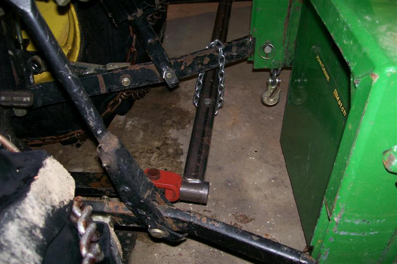

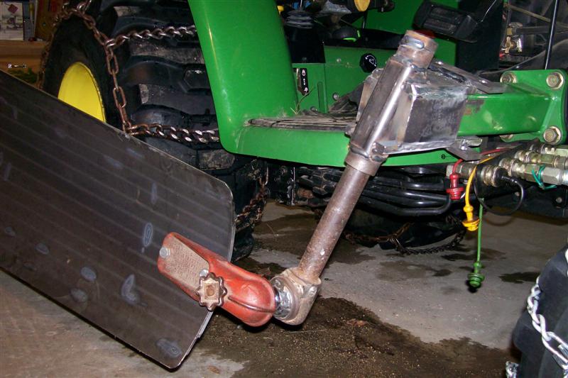

Yeah, sorry 'bout that delay. I thought I'd get some outside pics today, but too busy during the daylight hours. And the rust is beginning in earnest, so have it in for some paint tonight - where it is warm.
But here are a couple pics of the front attachment and the rear drawbar arrangement.
And the 2" ball and trailer hitch was just the ticket. Hydraulics to raise the front up and down, and a ram to move the push bar in and out would make it a pretty flexible wing. But not planned at the moment. More pics in the daylight - hopefully tomorrow if the painting goes well tonight. :)

I take it that the 3 pt hitch moves the wing up & down? Nice set up.
   / Wing Plow #11
Interesting use of the trailer coupler, and it's ambidextrous :) nice build.

Good read, and the wings' job is to push the snow berm over 2 - 5 ft. I've not tried the push bar extended as far as it will go. And correct, the front of the plow is about 6" off the ground. Partly by design (don't want to have to have a heavy wear strip added to the edge) and partly by default (the width of the front of the blade ended up a bit narrower than expected). Also, designed to "shelf" the berm and to push it over the edge of the ditch bank so the wind from the north will not drop the snow onto the drive.
One "fix" that may happen, is to lengthen the front plow support, to get the front of the blade closer to the ground (cool place for a hyd. ram :) ). But the wing not intended to just add width to the "cleaned" path, as this wing on will not easily allow the rig to be parked inside the shed. So it is off for the initial clearing of the drive, and not needed. But expect it to be very handy to push back and be more prepared for the next snow fall, and not feel trapped with close berms of snow and heavy drifting.

I believe from the picture, that the rear brace is pinned to the drawbar and remains in a fixed position.
Actually by fastening one end of the rear brace to the drawbar and using the 3pt arm to lift he has increased the vertical height he can lift the blade, versus running the brace across both arms and lifting it in a horizontal position.
Great idea that I would have probably missed until I realized I couldn't lift it very high!!! ;)
