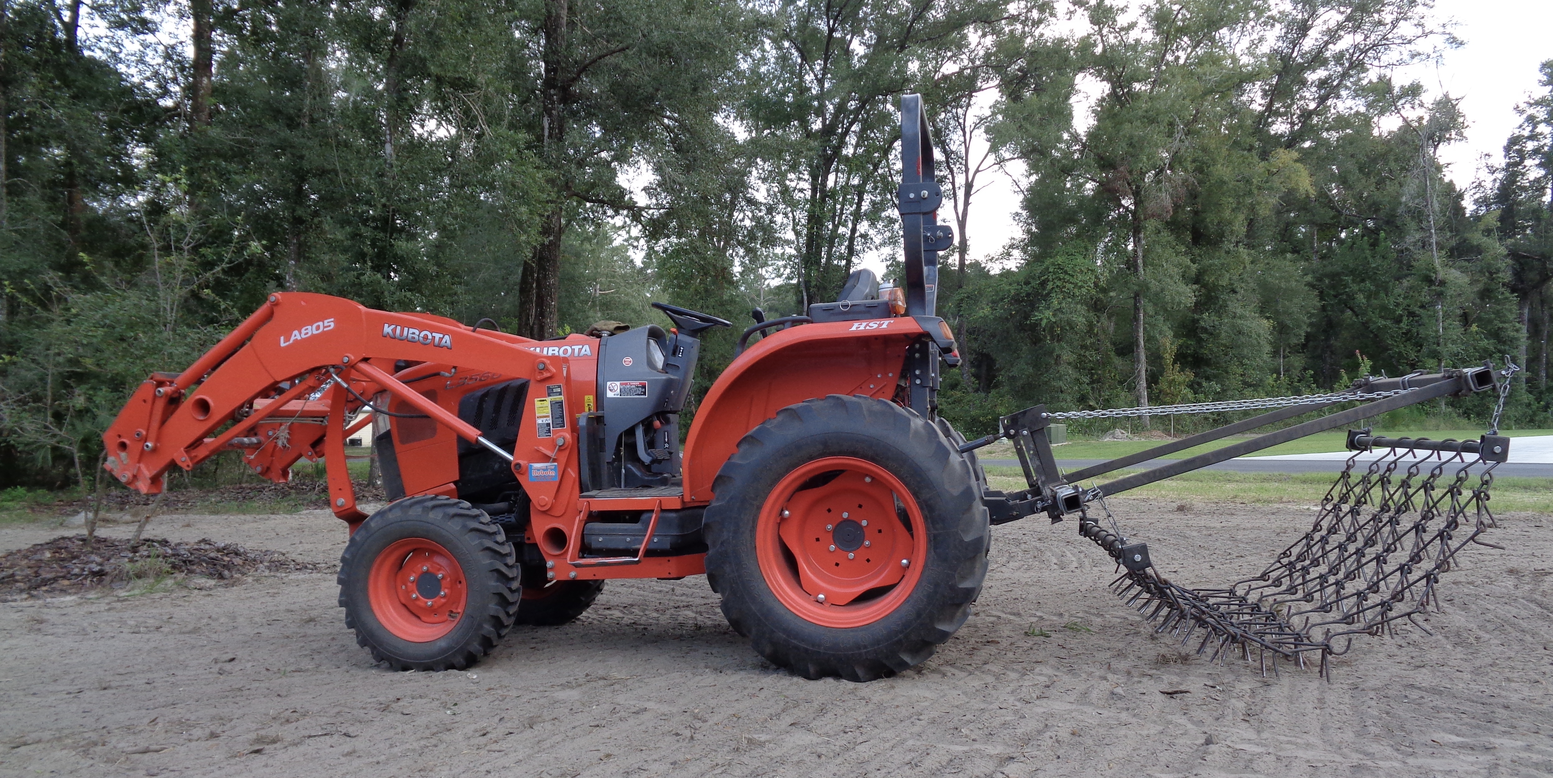

I have Wingfield's model ED3PT57 "Econodrag" framed Chain Harrow. ED3PT57 is 67" operating width. Outside to outside width of my R4/industrial tires is 62". Width is just right for my use, which is trail grooming and following my Disc Harrow in food plots and small fields, no field individually larger than three acres.

The assembled Chain Harrow mounts to the Three Point Hitch easily when new. I use Chain Harrow mostly in its most aggressive mat orientation and I know it is behind the tractor. I use harrow occasionally in the one increment less aggressive mat position. In both mat orientations harrow skips over tree roots barely below soil surface. In both mat orientations harrow slips over tree stumps without 'catching'.
Wingfield lift Chain Harrow reliably drops 'trash' accumulated in mat, when harrow is raised and tractor moved a short distance in reverse. Self cleaning is perhaps the major advantage of framed Chain Harrows over unframed, mat Chain Harrows pulled from the tractor drawbar.

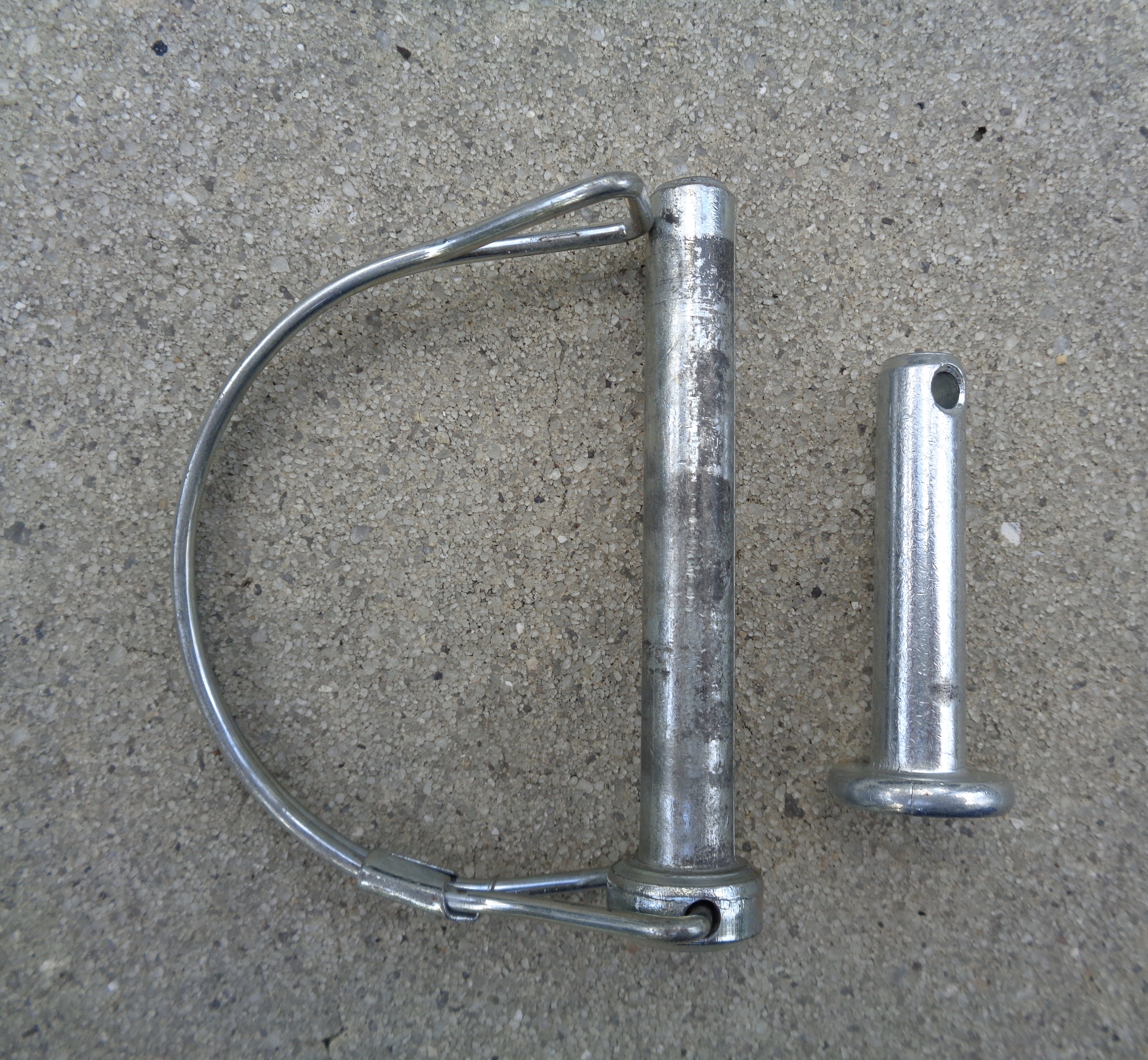

I sometimes forget to raise and pin the three parking stands after mounting, however I still have all three stands. The chain mat height adjustments works well, although I replaced long clips provided by Winfield with short clevis pins with small hair clips, less likely to flip off. I mailed Winfield short clevis pins I believe superior.

PHOTO #1 ED3PT57 at work. Top Link 50% extended.
Optimal smoothing adjustment has row of tines nearest the tractor in light soil contact, succeeding rows of tines proceeding to the rear in heavier soil contact.

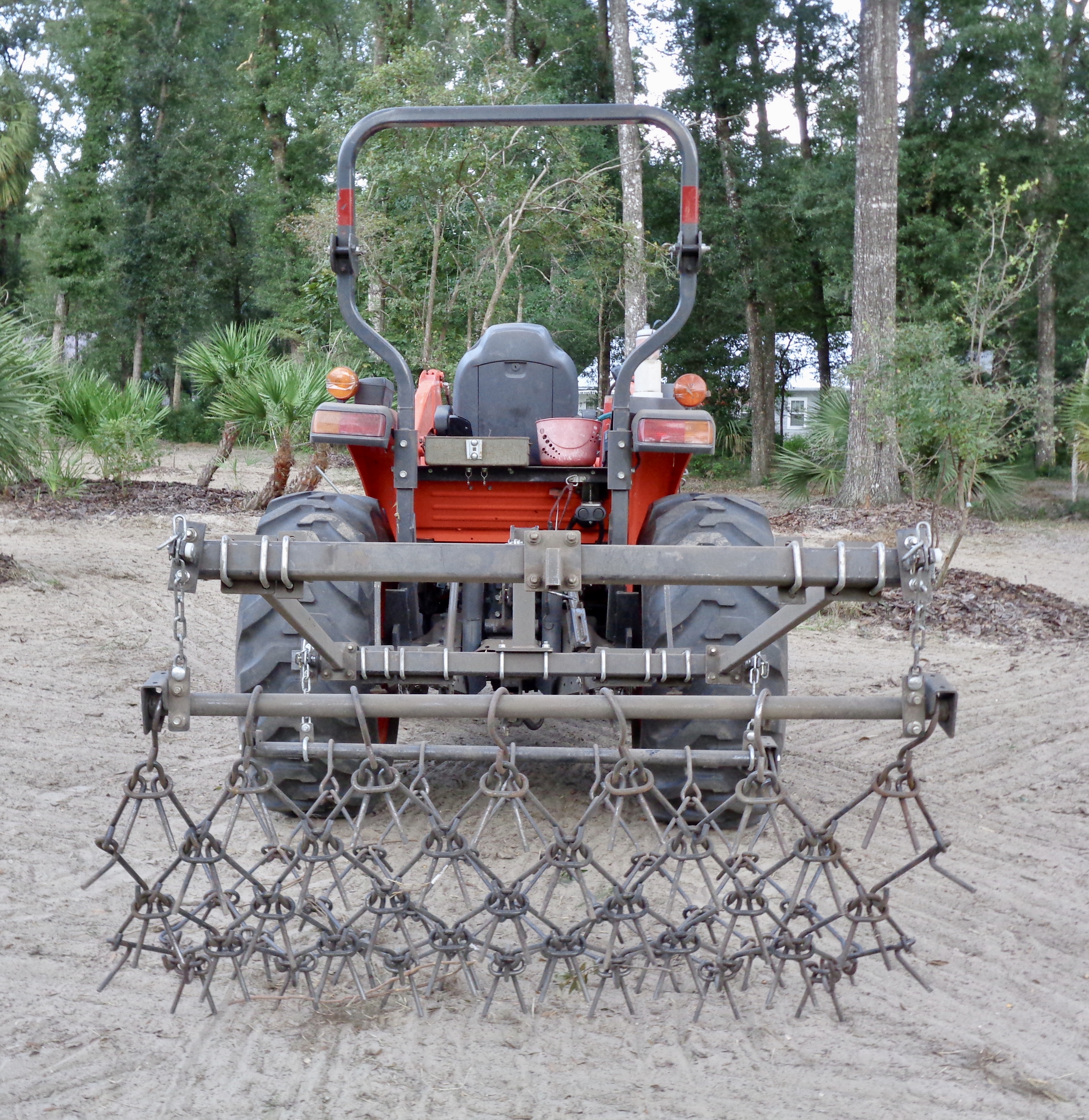

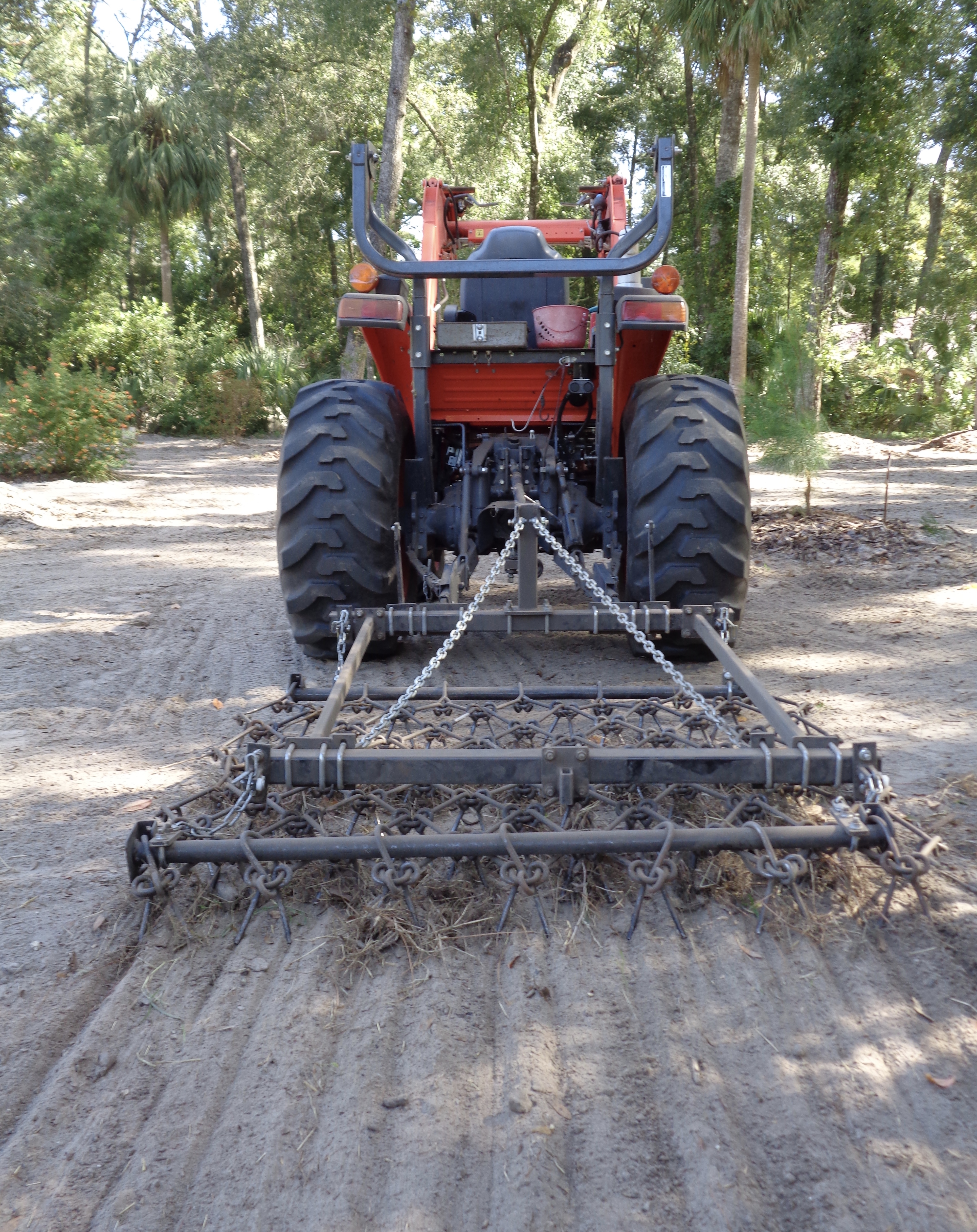

PHOTO #2 + #3 ED3PT57 travel position. No tine in ground contact. Top Link completely screwed in.
PHOTO #4 Over long factory clip pin and replacement short clevis pin.

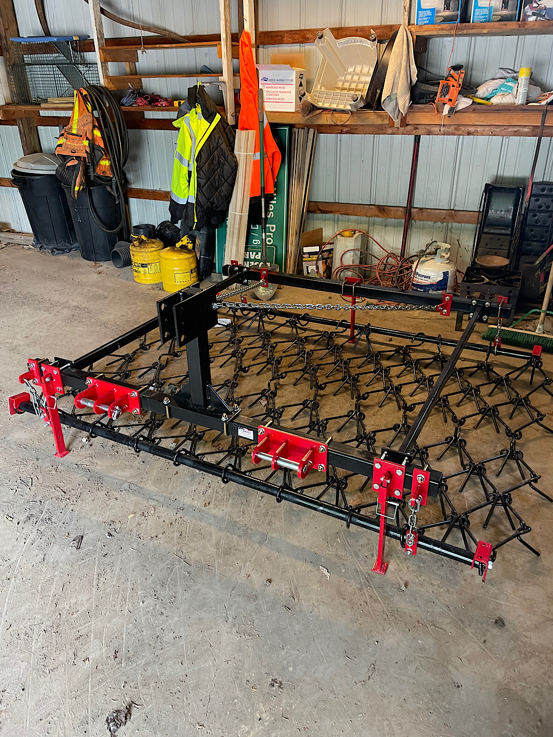

My Wingfield Chain Harrow has three short stands for supporting the frame when the harrow is stored, two in the front, one in the rear. The stands are painted black, like the rest of the harrow. I have overlooked raising the stands repeatedly after attaching the harrow to the Three Point Hitch. As a result the stands are distorted and difficult to raise and lower. I have to tap the stands up and down with a nylon mallet.
WINGFIELD SHOULD PAINT THE STORAGE STANDS BRIGHT ORANGE OR BRIGHT YELLOW.

They are painted red now Jeff. I’ve had a problem with the rear stand getting pinched by the mat bar so I have to reverse it when using the harrow. I’m with you I really like the quality. I use the most aggressive when going over mulch and flipped it other way over gravel parking lots. I’m thinking that a short piece of full width chain hanging at back end might be beneficial for a more smoothed out look. I did find that you can just lower it all the way or you’ll have drag marks from the bar ends - having just the mat in contact with ground eliminated that. Probably something you already knew.

Thank you for the exceptionally clear photo.
The red painted components are an improvement.
Attachment of the TPH tower to the frame with U-bolts is another improvement.
