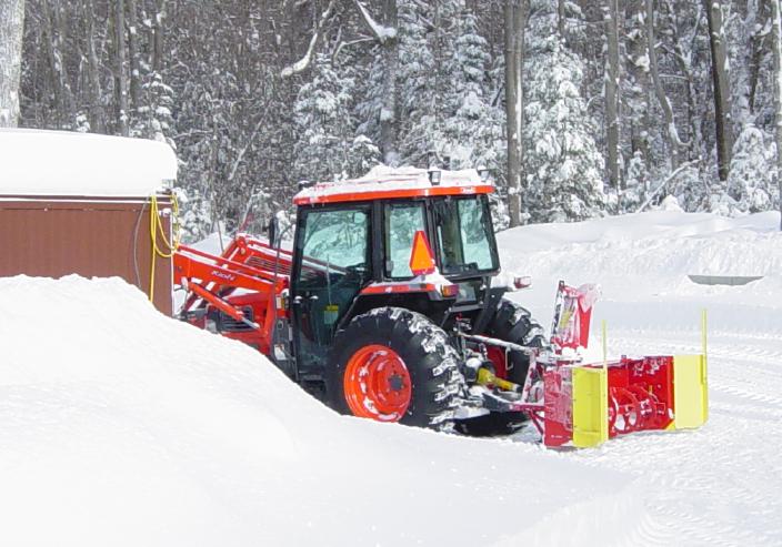

   / Wings on Snowblower? #7
I've got wings. They go straigth ahead but if you bent them and then reinforced they would work great. Here is a pic.
   / Wings on Snowblower? #8
here's a pic of my wings

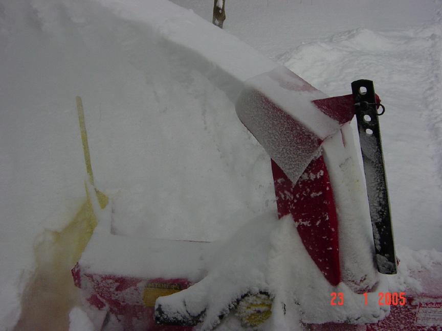

   / Wings on Snowblower? #9
here's a pic of the blower working the snow
