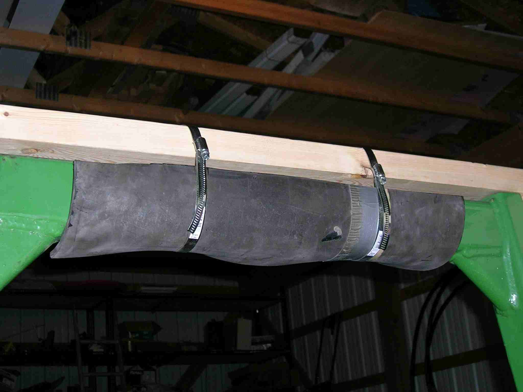

First picture-the rear roof support is attached to the roll bar. Heavy rubber is used to protect the metal.

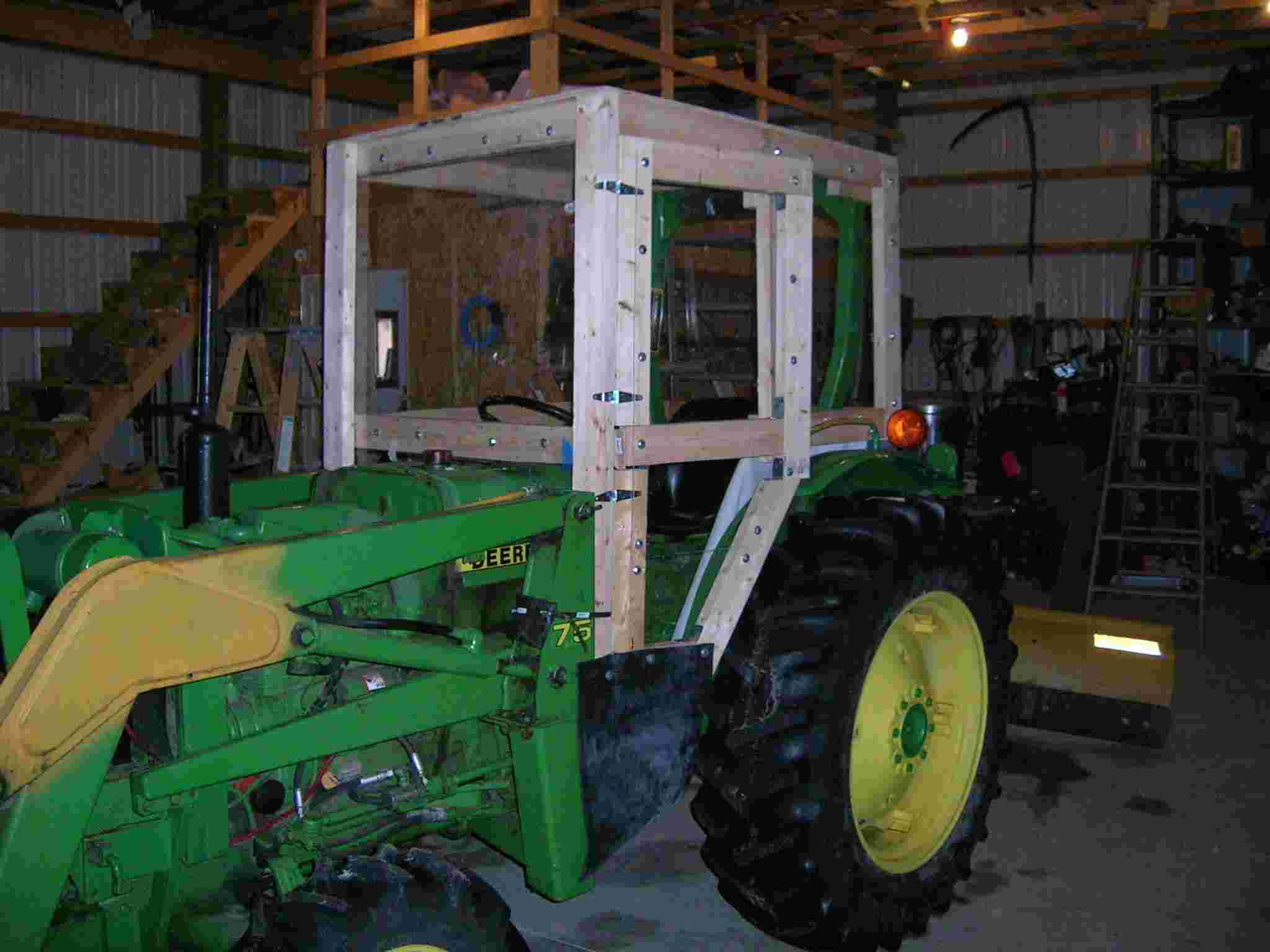

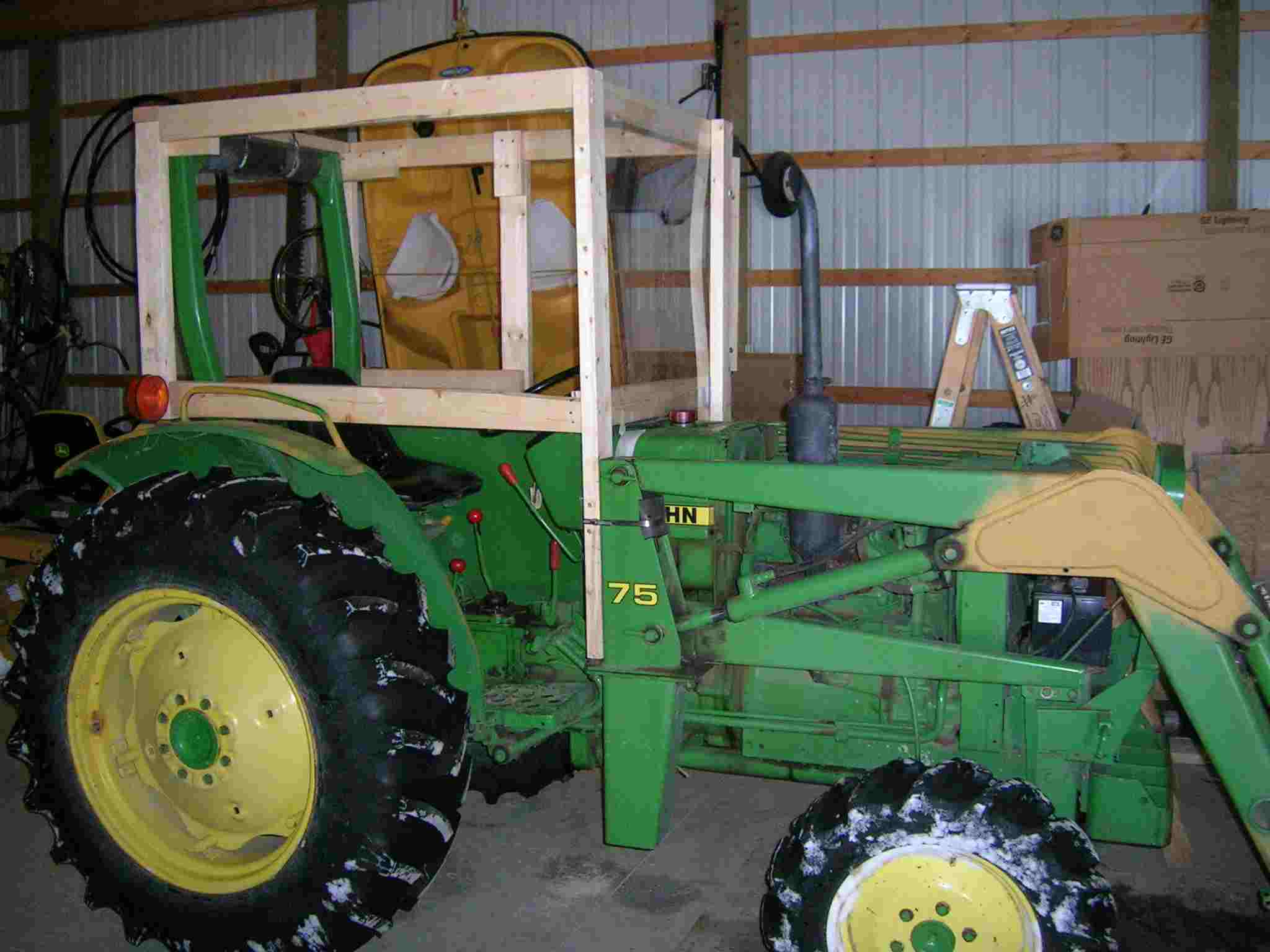

Third picture-wooden frame work with front windshield. The windshield had to be attached before finishing the frame. When cutting the plexiglass, tape both sides or the glass won't cut smoothly. The glass is cut out to fit down the right and left sides of the engine. Notice the black rubber protecting the metal on the rollbar and supports.

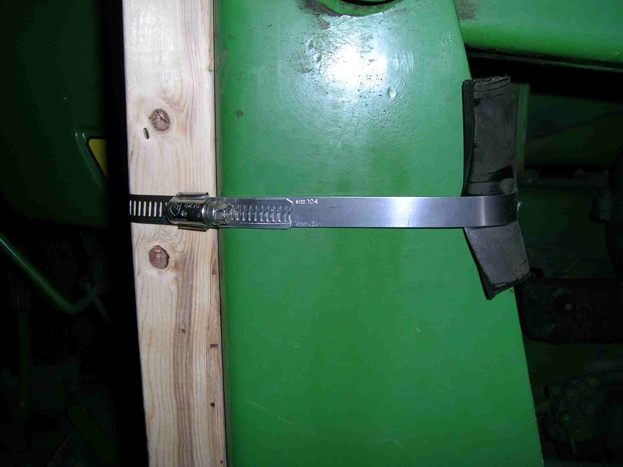

The sides were mounted directly to the grab rails on the fenders.

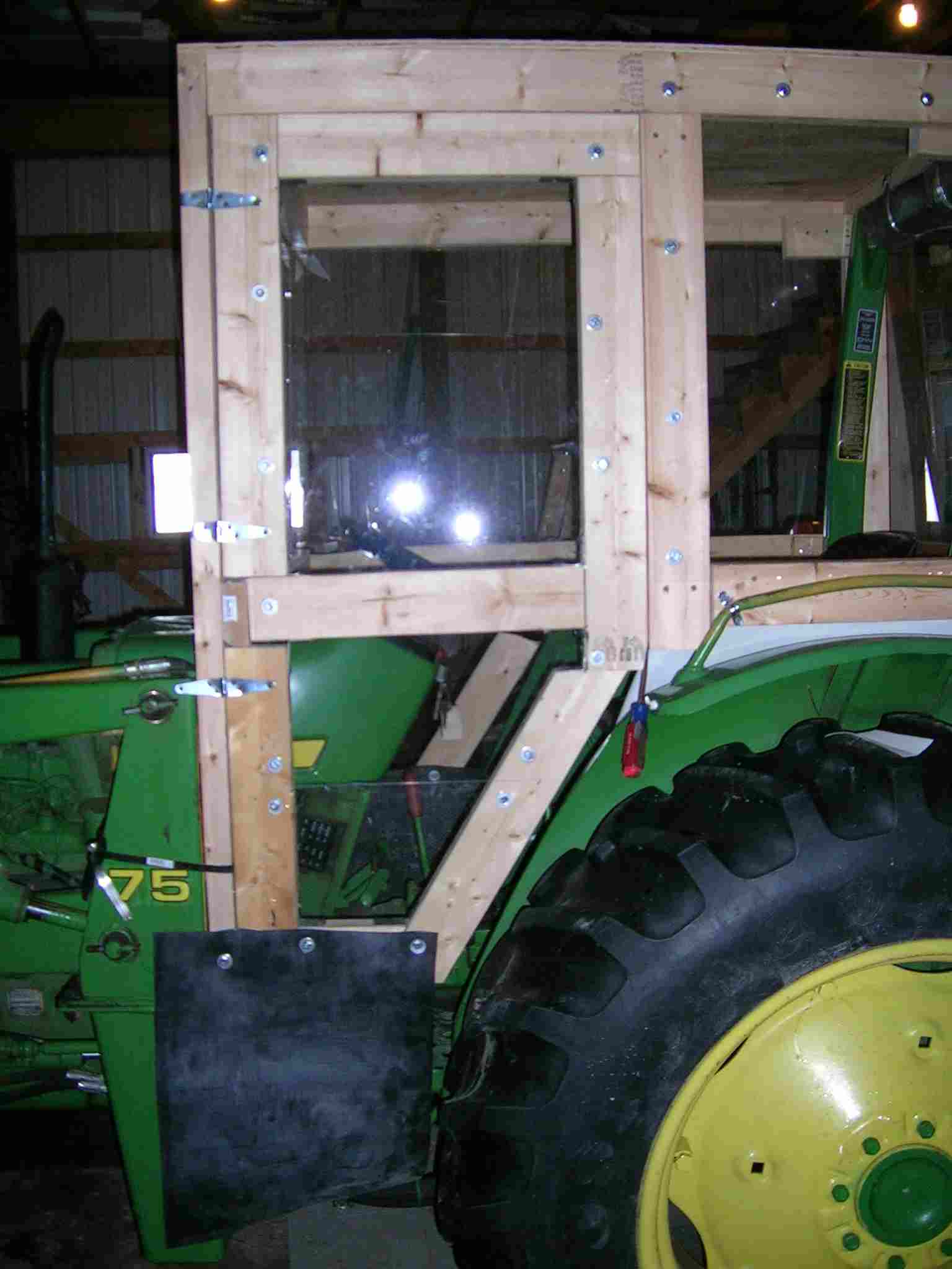

The door was added. Notice the rubber on the bottom to block the wind. No exterior handle was added as the door was designed to naturally spring open /forums/images/graemlins/smile.gif
Creating the cross beam in the door was more than just for structural support. It allowed us to use the smaller pieces of plexi-glass and not have to buy another big sheet.
The plexi-glass holes were first drilled with a small bit, then a larger bit. Lag bolts with large washers were used to attach the glass to the wood.
If you notice the white between the top of the fender and the bottom of the 2x4 (between the hand rail) is vinyl to block the wind. I'll go into more detail later.

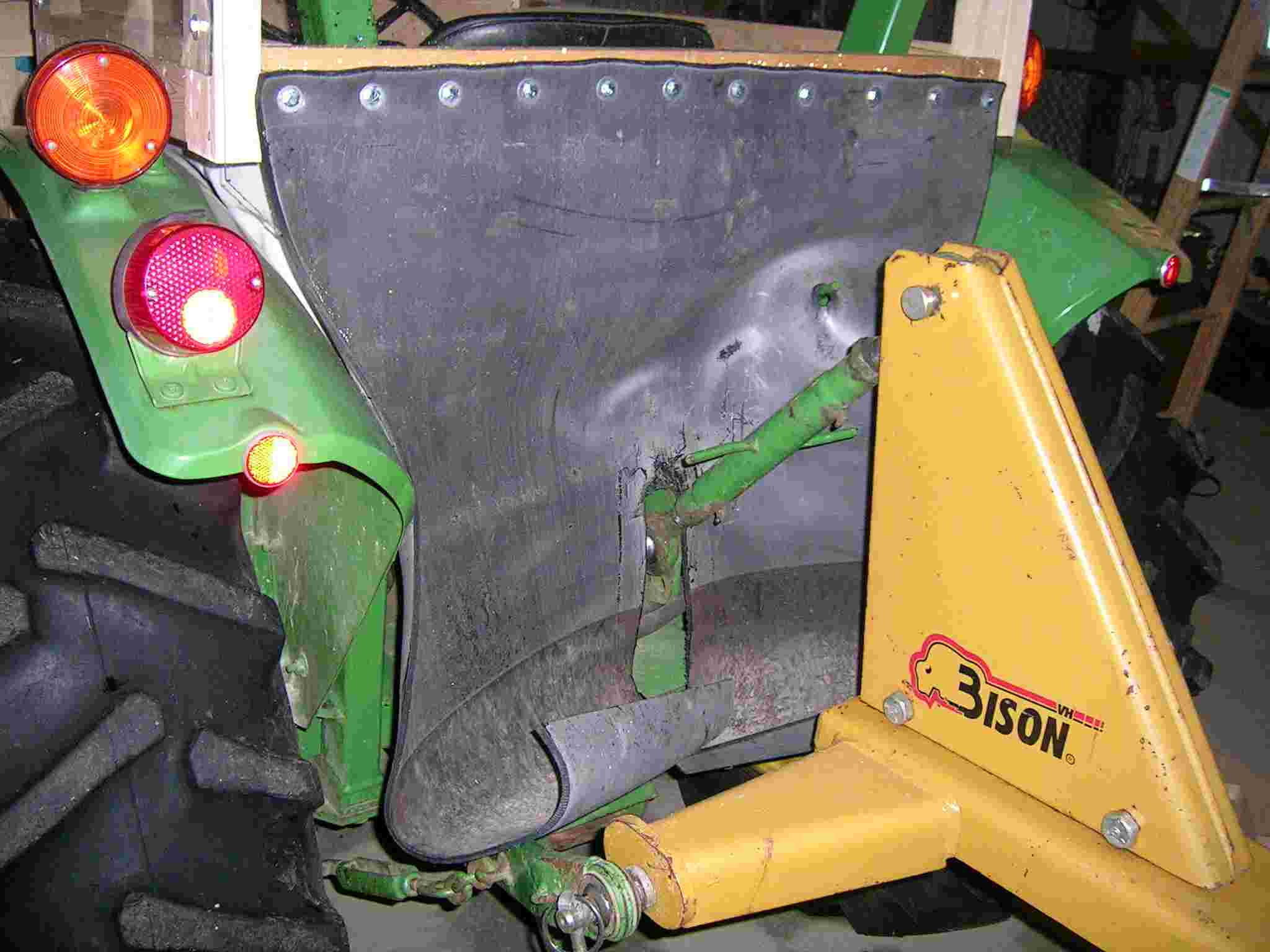

The bottom rear of the tractor was blocked with more of the heavy rubber. Notice the slot for pto arm and the small hole that was cut for the pto arm adjustment.

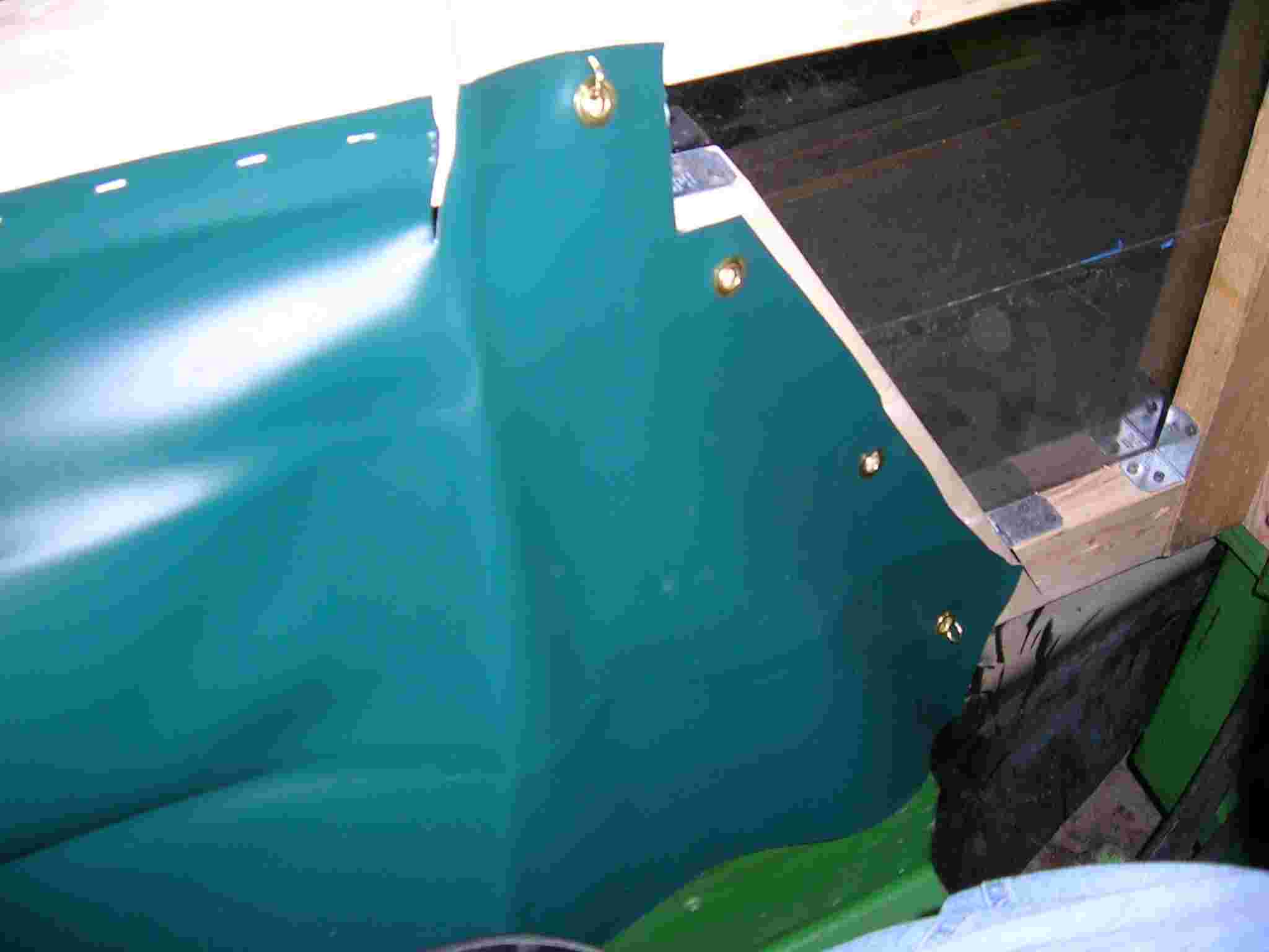

With all this hard work we had to add a custom interior! I bought some what matching green vinyl at the fabric store. It was only $1.15 as I grabbed it from the scrap pile. If you can get it cheap, the vinyl works excellent for blocking the wind. If I had thought of it at the time, I would have cut a larger piece and let it extend all the way to the floor and then some. I picked up a grommet kit at Meijer and added some grommets to the vinyl. The left arm rail is stapled to the wood. The vinyl extends over the door when closed to block the gap between the door and the wheel well. Small hooks were screwed into the door.

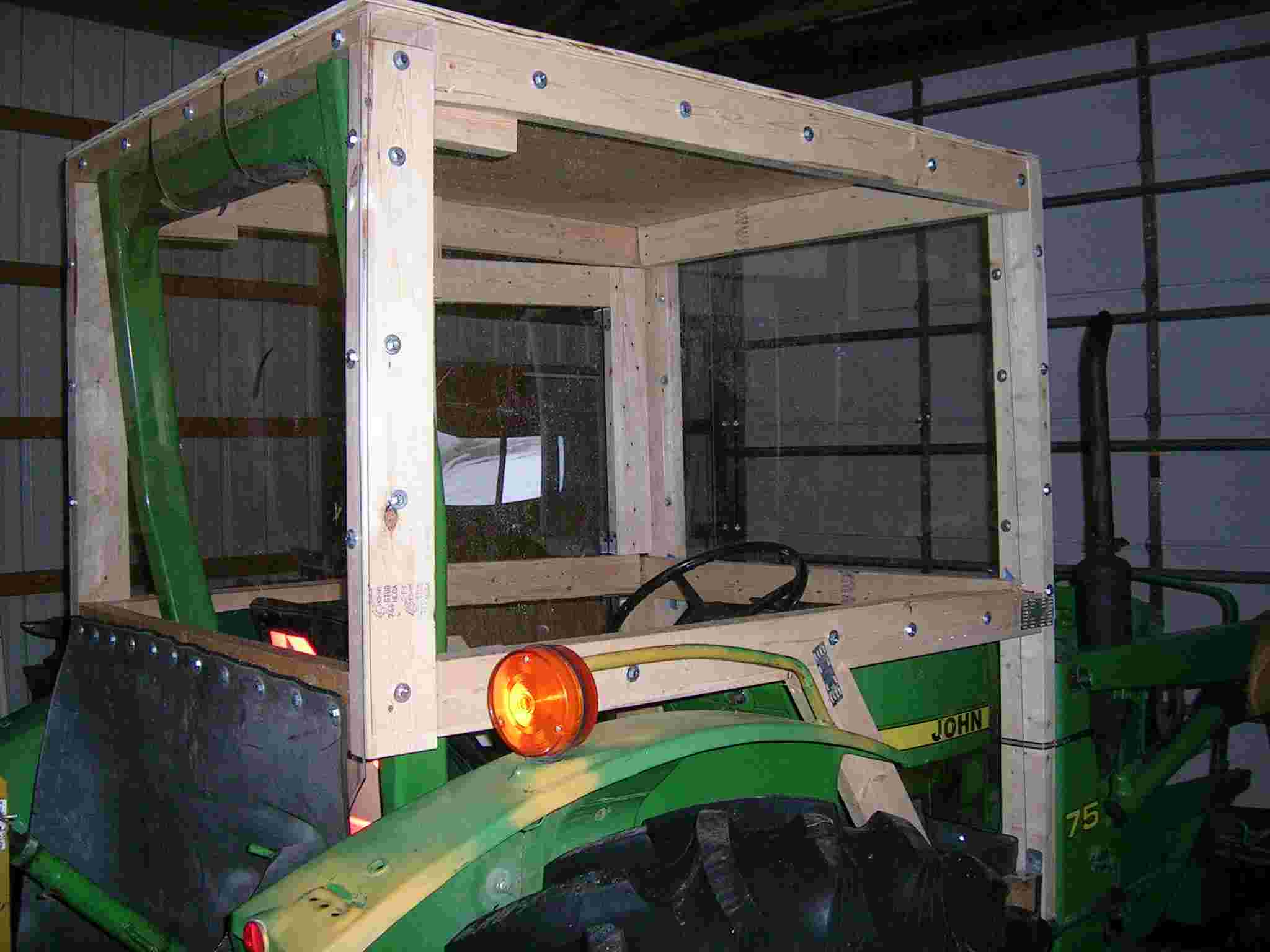

Attached are the final pictures.

Screws were used to attach the 2x4's. We had to drill the holes first as the wood was splitting. L-brackets were used in most places to provide additional support. In addition, flat truss brackets were added in certain spots for additional support.
