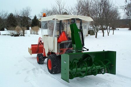

The best I think the best set up is a 3 pt snowblower and the FEL. Here is my set up, 54 inch Puma, and home made cab from a golf cart cover, works great. You DO NOT want to blow snow without a cab.
Good luck
