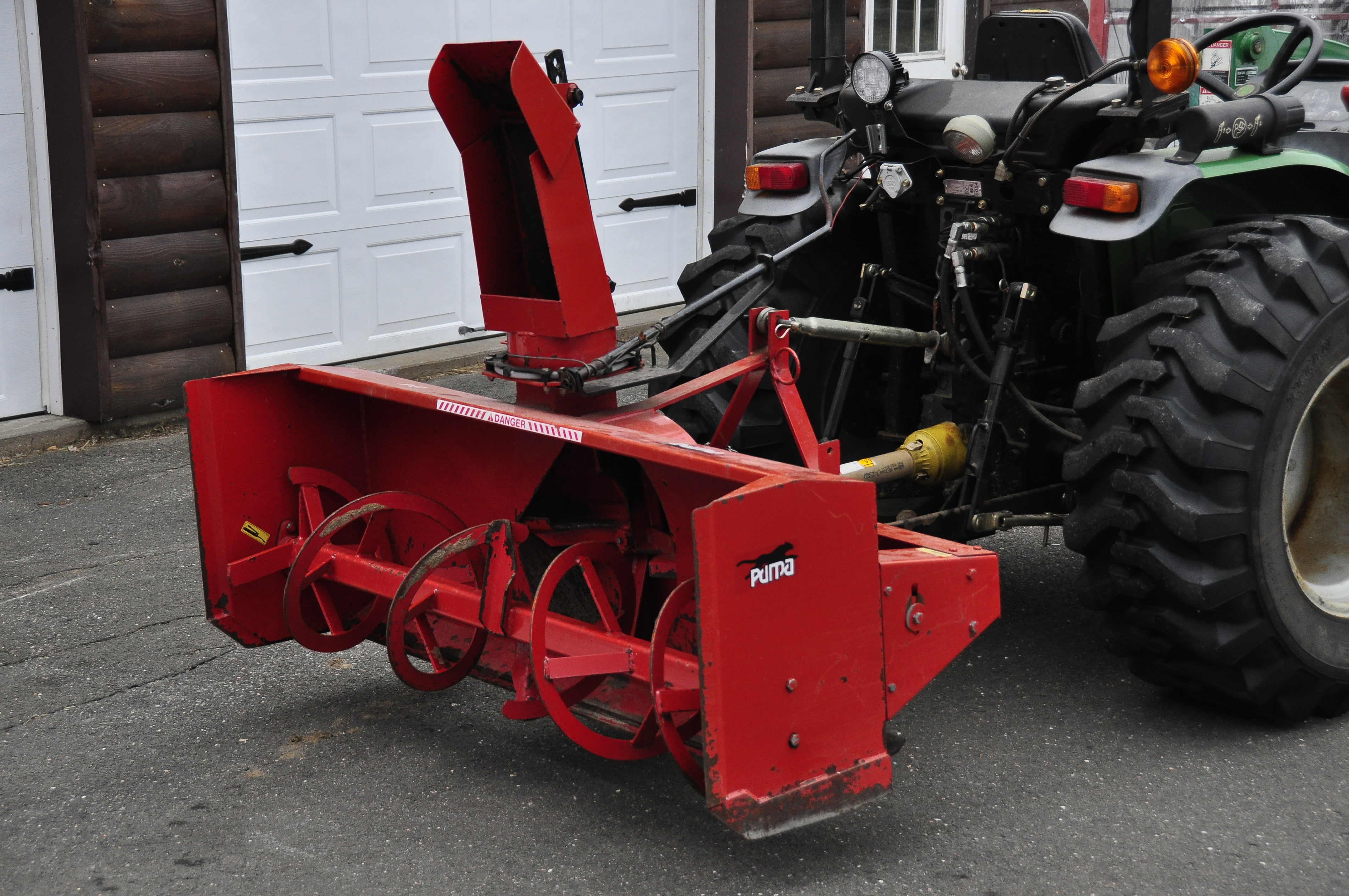

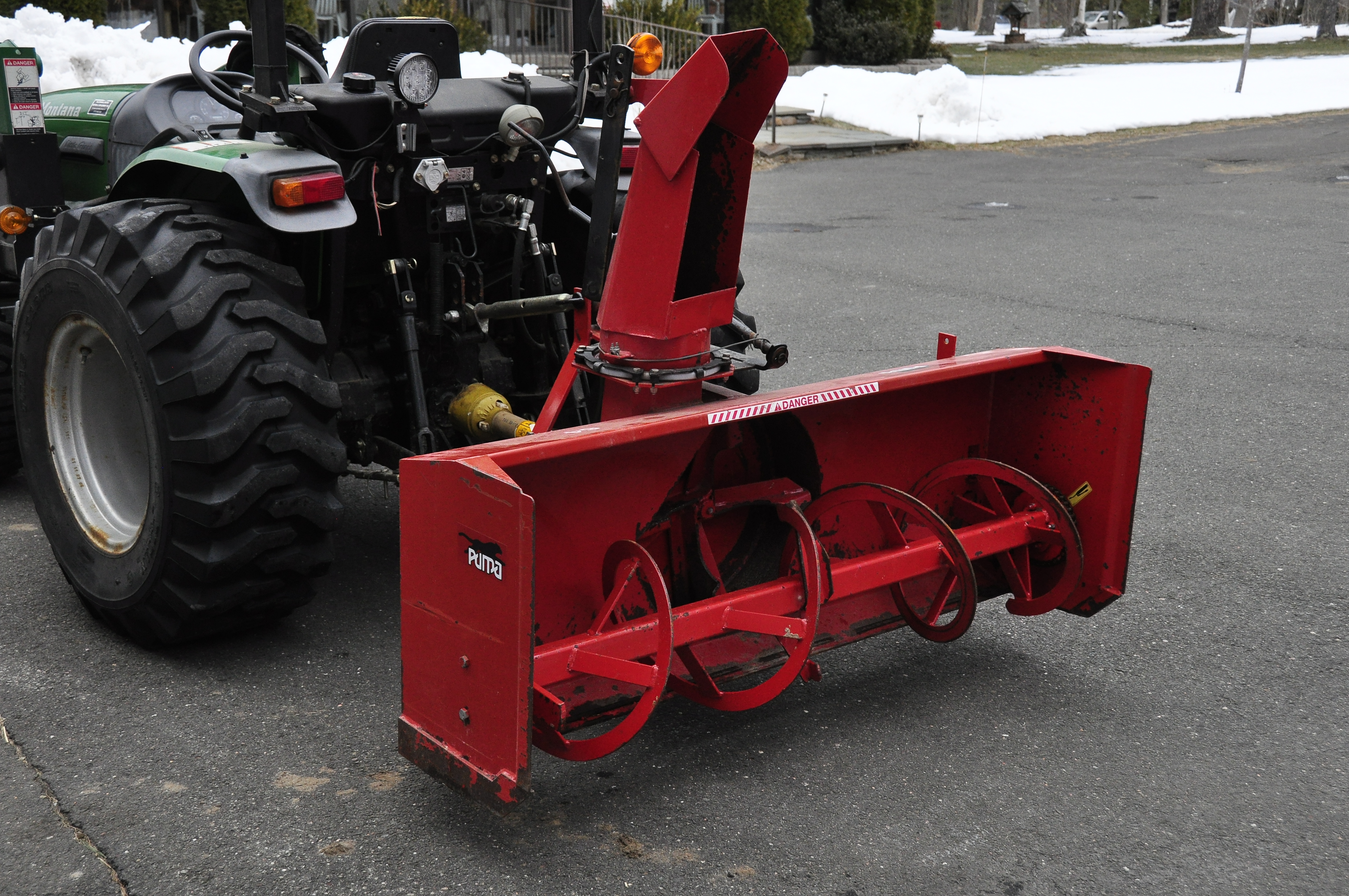

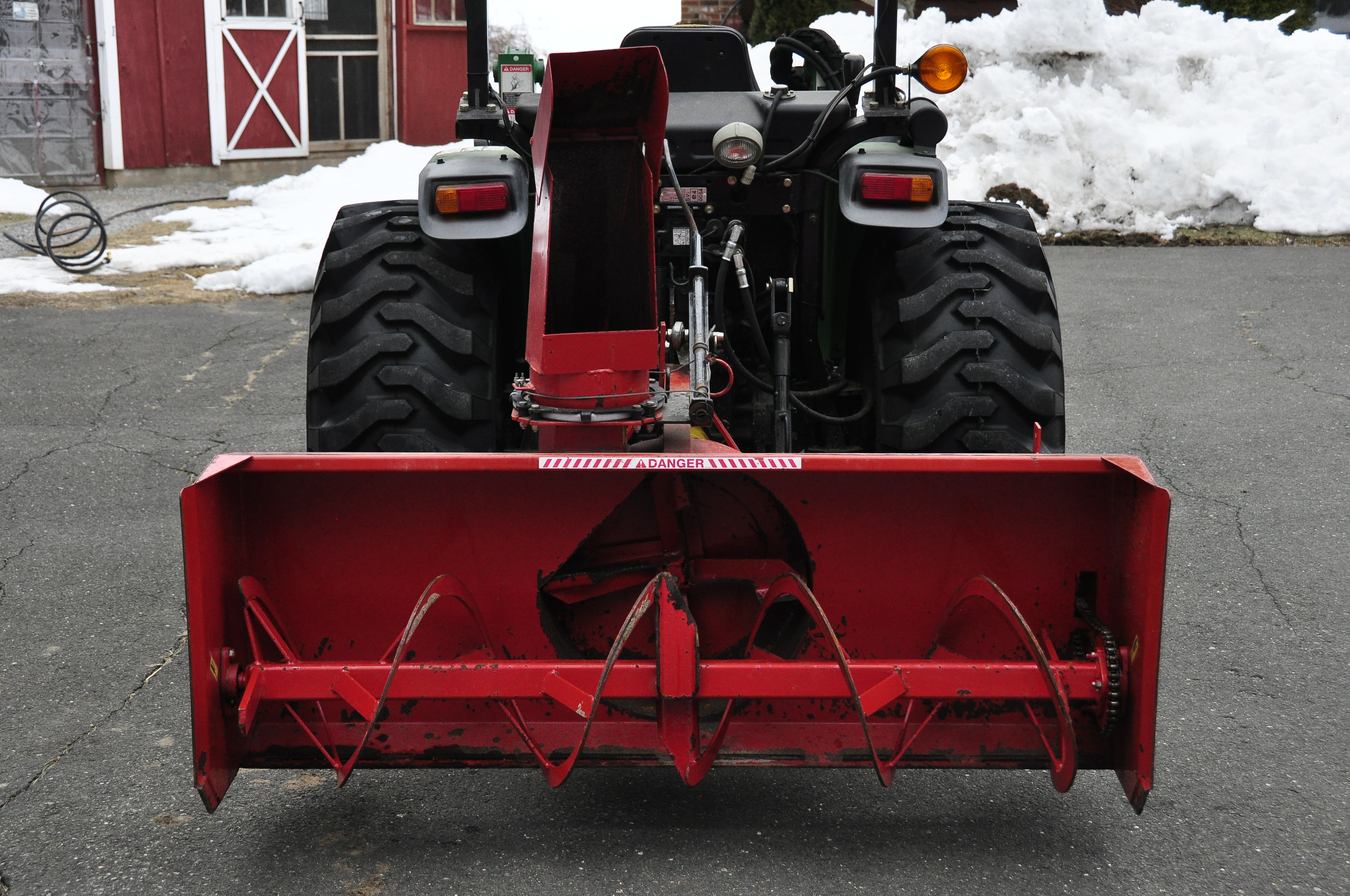

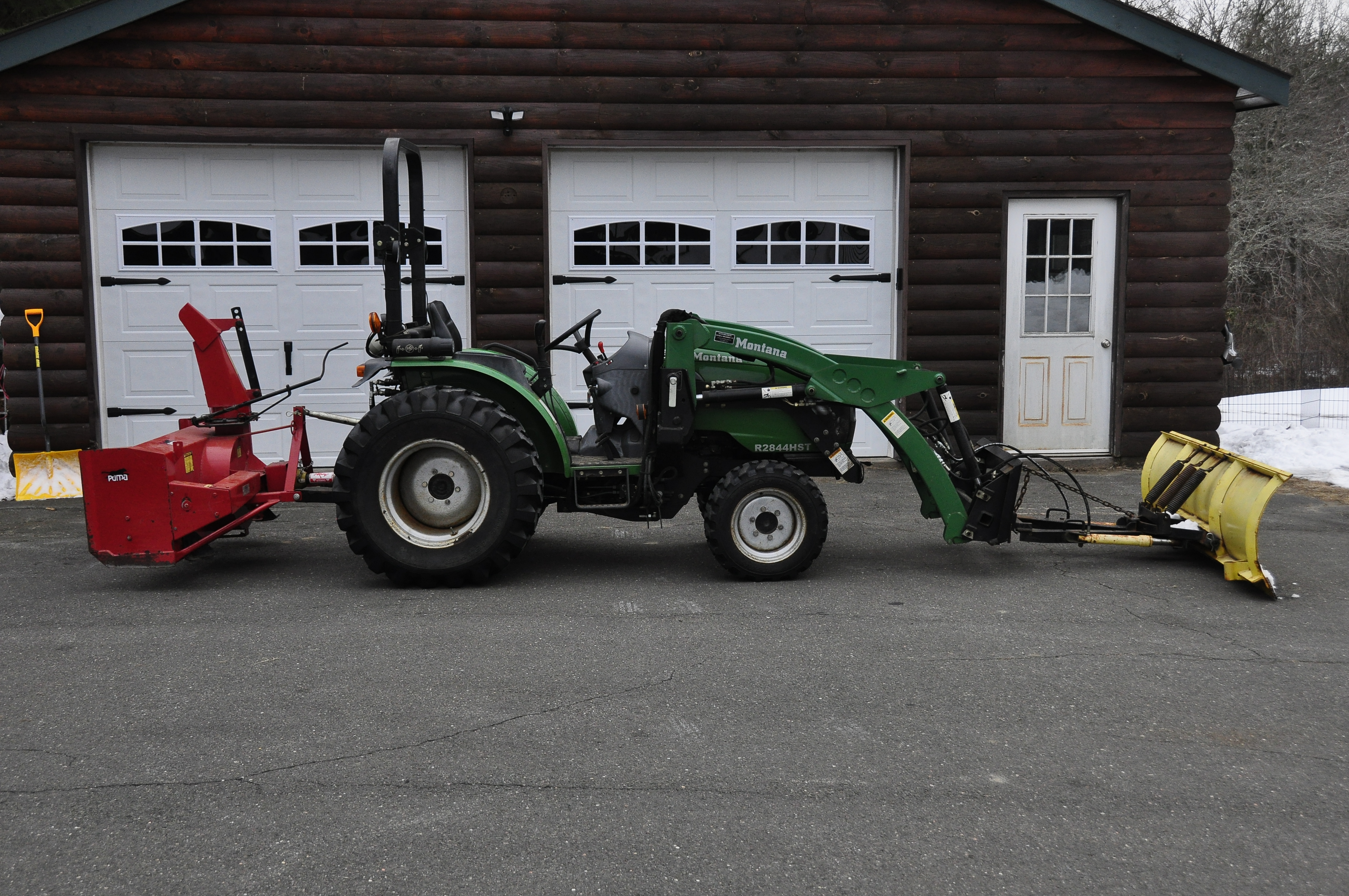

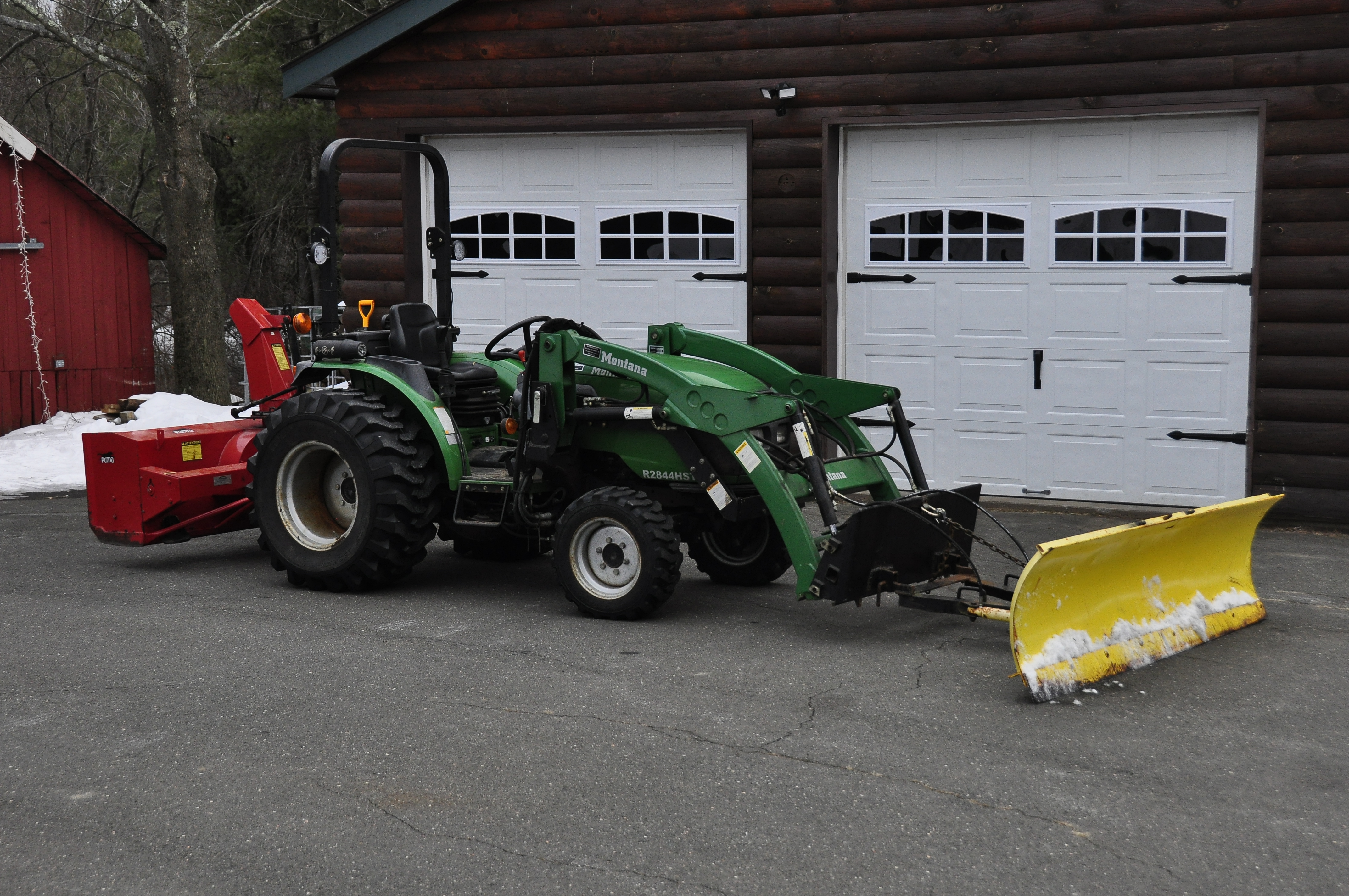

We are expecting the 4th snowstorm in 2 weeks, and I've been hunting for weeks on Craigslist, Ebay, Equipment Trader and TractorHouse for a good used snowblower. I took the week off of work, and drove 3 hours each way to upstate NY to look at a Pronovost Puma 64 blower. Was bought new in 2005, and had not been used for 5 years due to the guy buying a larger tractor. Had been stored inside, and looks to be in good shape. Had an enjoyable trip. My dad came with me, and we had a good chance to catch-up on things. Got it home, hooked it up to my tractor and everything works perfectly. Now I am now waiting for the 8" of snow to arrive tomorrow. I know I may get a sore neck from driving backwards, but my wife is a massage therapist, so she can get my neck back in shape!
This is probably the last storm of the season. My plan is to change the gearbox oil this spring and sand down the rusty edges and get some touch up spray paint and get it looking new again. Anyone have a recommendation on a paint match? Is there a trick to draining the gearbox short of turning it on its side? I did not see a drain plug on the bottom.

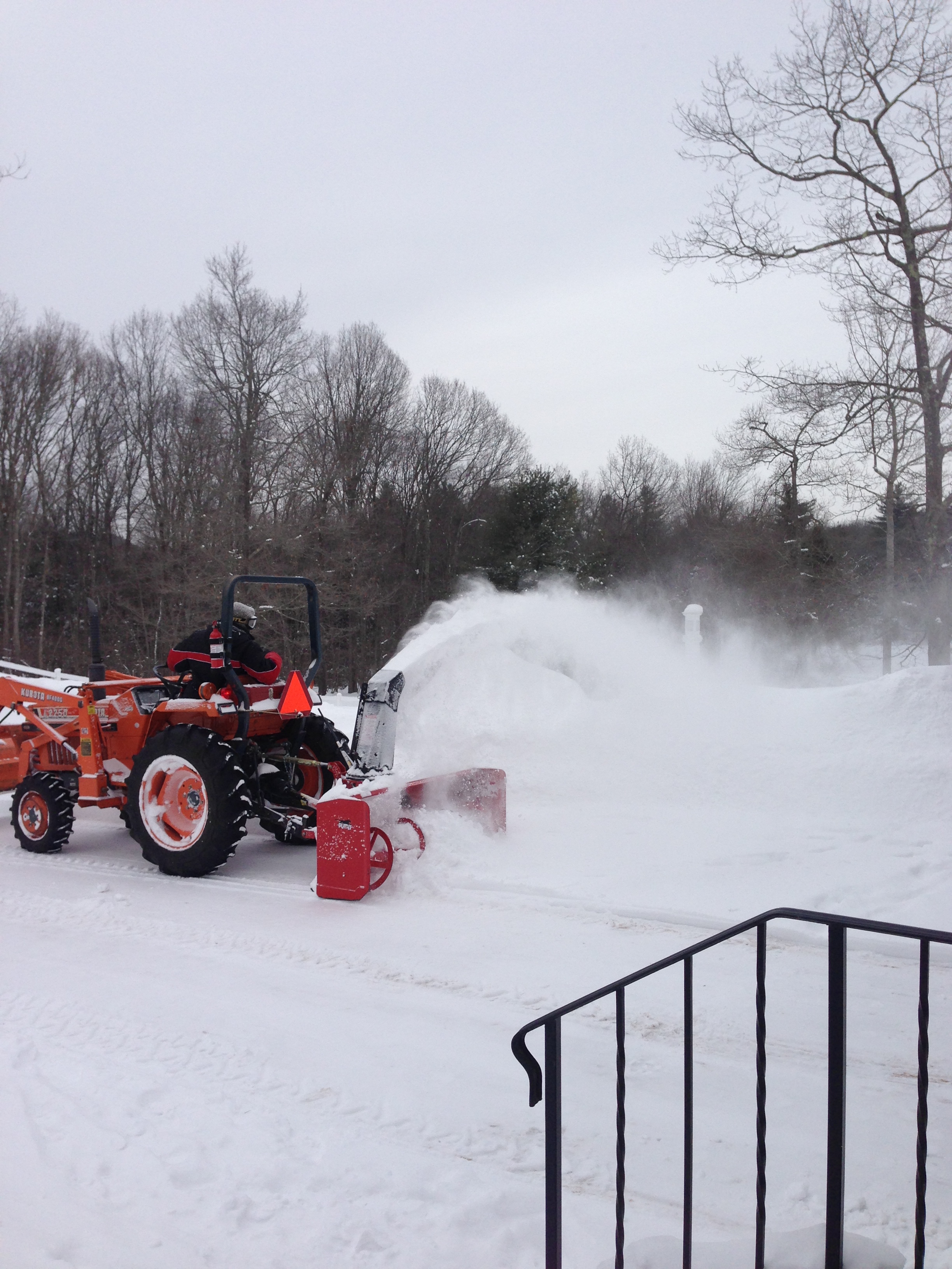

Couple pics when I had it on my old tractor:

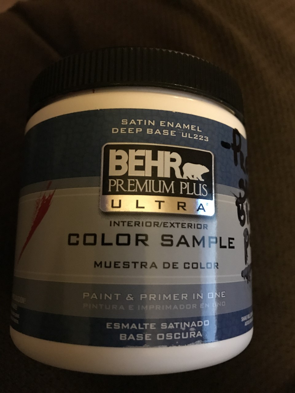

You mentioned that you were planning on touching up the paint. Not sure where you may be looking, but I had no luck obtaining factory paint from Pronovost. I was able to obtain a piece of painted metal that Pronovost was good enough to provide. I then had the paint matched locally; touch ups came out great.
Let me know if you're interested, and I'll look up the info for you.
   / Winter's Last Gasp - Just Picked Up New To Me Pronovost Puma 64 Snowblower
#9
Deerslayer, I would love the formula to match the paint, and where you had the paint made up. Not sure how much mine has faded from original, but I can some of the paint and see how it compares. I could always haul the blower to the paint store to have them match it!
   / Winter's Last Gasp - Just Picked Up New To Me Pronovost Puma 64 Snowblower #10
Ask and ye shall receive:
I imagine the formula will match very close to what you have, however you could always bring one of the bolts in to match. Another option you have is to bring in the blower chute (was not an option for me as mine came in black). But then again, bringing the whole unit as you mentioned might be fun and would no doubt turn some heads in the paint department of your local HD!! :laughing:
I have also sent you a pm.
