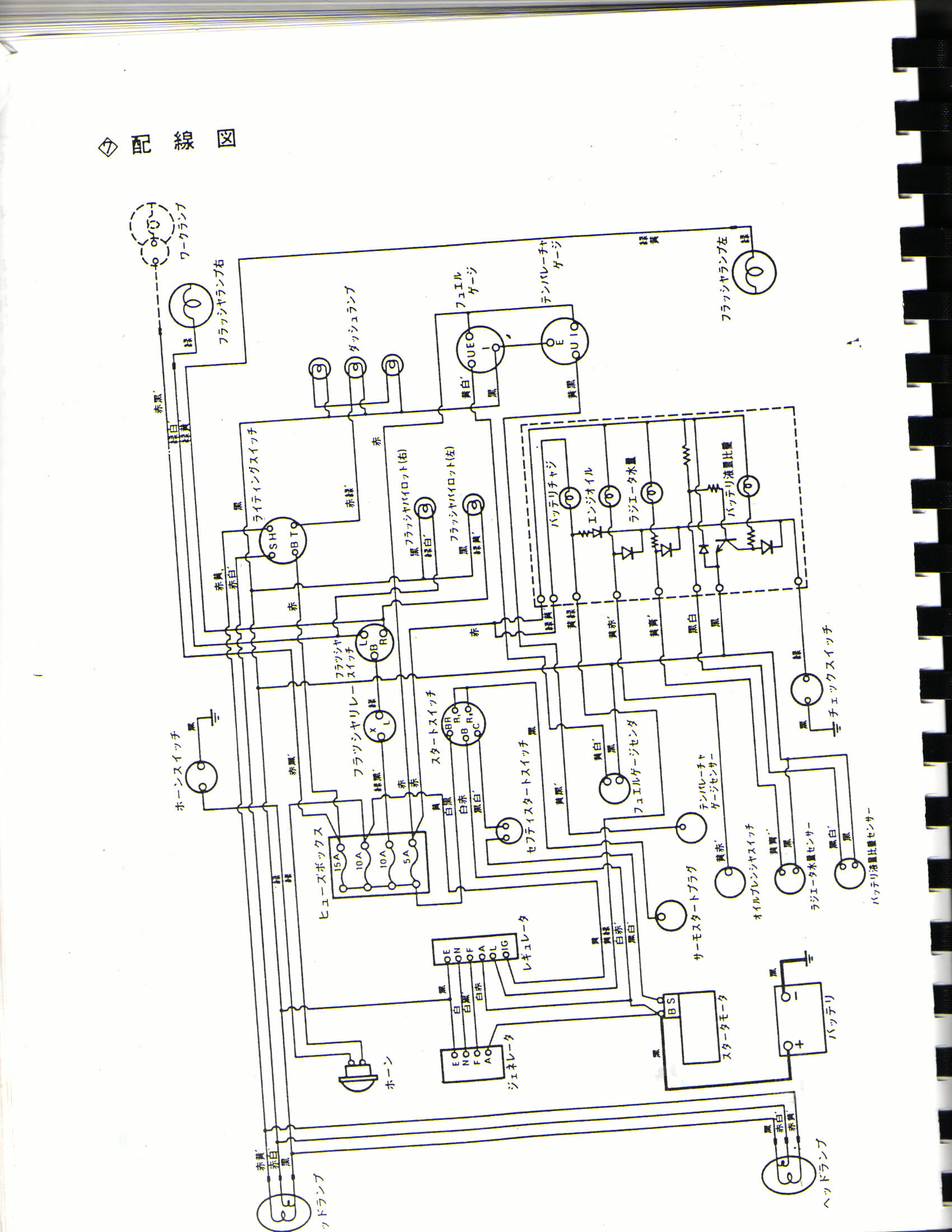

I was wondering if anyone has a wiring diagram for a ym2210bd (has gauges) that they would be willing to share with me. Previous owner made a bit of a mess of the wiring under the dash so I want to correct it. I've got a lot done with my multimeter but I have a new charging system coming in tomorrow and I want to make sure the wiring is correct before I put power to the new components. Even if it's in Japanese that's fine, I just want to trace the wires to ensure proper connection.
   / Wiring diagram for YM2210BD? #3
The 2210 and the 2000B or even D you can use also. Reference to the Ym2000 Elec. Dia. if you need to check something in English.

Winston1, thank you very much. It's exactly what I needed and I really appreciate it.
Careyo63, that's good info because I didn't know those tractors had the same wiring harness/diagram. Thanks!
