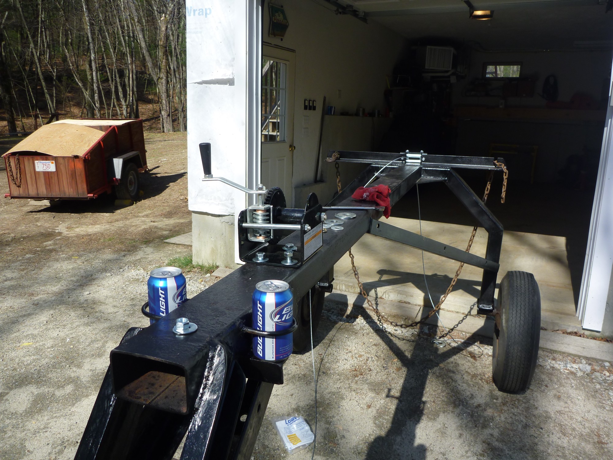

Hey guys,
I had some Basspro gift cards that were sitting around collecting dust and decided to use them on an electric winch for my log arch. I built the log arch last year and it has come in handy for the most part, the only mistake I made was buying a cheapo winch from Northern Tool. It broke the first time I used it. Since then, I have used a cumalong which really isn't all that convenient, so I decided to upgrade to ultimate laziness. :laughing:
I bought the Superwinch Terra 4500 ATV Winch from Basspro for 37 dollars after gift cards and coupon code. It comes with wiring for a permanent mount installation but I would like to make it portable.
I will weld a piece of square tubing to the top of my log arch that will accept the 2" winch mount hitch I am getting for it. I want to be able to slide it from the log arch, to my truck hitch, and back, fairly easy. My truck already has a 7 pin connector on it.
Is it possible to wire up a 7 pin connector to the winch? Or is that easiest way? If so, can I easily wire a 7 pin female end to my tractor?
Do you have any better ideas that you could suggest to me?
I'm only saying the 7 pin connector because that is what's already there, but if there is a better way to do it then I'm all ears. :D
The tractor is an L4610 if that matters. I'll post a pic of the log arch.

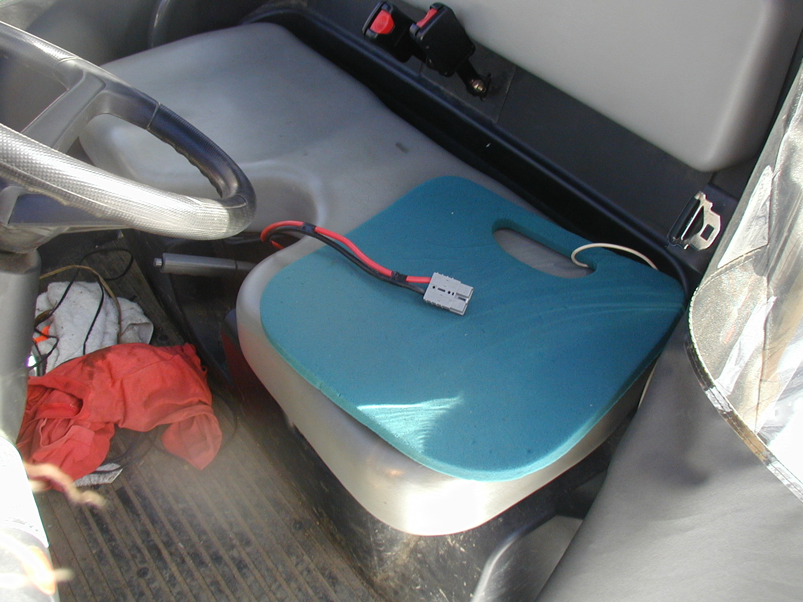

Her is a link to some ebay ones. I know someone else on this site used some off ebay. I was surprised how cheap some were. I think you ned somthing like this to be beefy to handle the amps and also, they will last better. and also have better contact area.
fork lift battery connector items - Get great deals on Business Industrial items on eBay.com!
I admit I myself used a male and female 110 volt 'regular' household connectors (Mine were used) they work fine for me. But with the new cost Its probably better to go with these.

One of the cool things about this type of connector is that there's no male or female. Both sides are the same, and yet polarity is maintained. This allows you to keep a handful of them around and you can connect them to the load side, the supply side, or make extensions. Nifty.

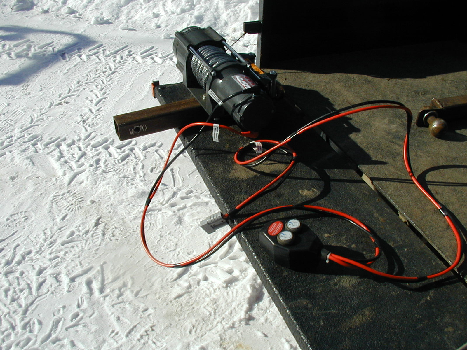

Are those the ones I would need?
I hope so, because I just ordered 3 of them :laughing: one for tractor, one for winch, and one for truck.
I might be able to get some 2awg welding lead wire from some friends, it is 200A rated so that should be fine right?

These work great:thumbsup: I've had one for years on the boat trailer. The connector should say what gauge wire it can take, since you won't be going a long distance on a tractor I'd go by that. Grainger's also sells a lock-out cover that can double as a dirt protector.
   / Wiring electric winch plug for Log arch winch #10
By using one on the tractor and one on the truck you can jump either by just plugging in.
If it was me I would play it safe and go with the higher amperage rated connectors, not much more money and you will be sure if for some reason you have a long pull or the tractor needs more of a jump start than anticipated you will not heat things up too much.
A car type battery can push out some heavy amperage for a short time when it is asked to and it can do damage if not treated properly.
I use the 350 amp connector for all battery connections as with the winch or jumping a vehicle.
