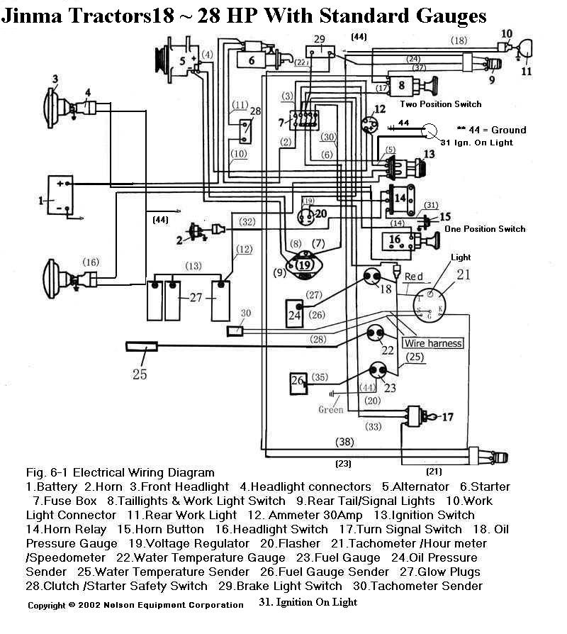

My father, who had alzheimers has disconnected the guages on his tractor and I need a wiring diagram to re connect them properly, so the tractor will operate. Any help will be appreciated.

Someone may be able to provide you with a 2430 specific diagram, but it shouldn't be necessary. All his gauges - in fact the entire instrument cluster if so equipped - should be on the same accessory circuit. His problem may be as simple as a fuse.
And most of the wires should have colored labels on either end. So if you don't know which fuse protects the gauges, note the numbers coming off the fuse panel. Then looks for the same numbers on wires under the instrument panel.

It's not the circuit or fuse, the guages have been disconnected all together, the wires have been taken off and not marked... My father thought he could remember how they go and he can't so I have to reconnect them all together.

Do the wires still have little numbers on them? If you look along the wires and find numbers then you can find a Jinma wiring diagram on a number of sites that has the number coding to guage match up. If the numbers are not there then I think you will have to trace the wires back because color coding does not seem to be a Chinese manufacturing skill:( Not sure but the Farm pro site may have the manual
   / Wiring for the guages on a Farm Pro 2430 #5
Here's a diagram I found. Hope it helps.
Ed.

Thanks Ed it did help and I got it hooked back up and running.... the little numbers weren't all there but I figured it out and got it so he could use it
