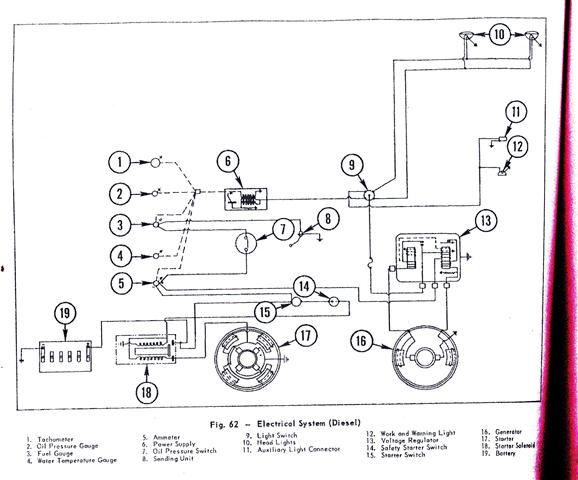

Just replaced starter on my MF 135, first rebuilt starter came back with bad solenoid and I replaced many wires before I figured that out. Now it starts fine, but won't stop! Obviously, I messed up wiring somewhere. I need a simple wiring diagram. The one in the I&T manual makes my head hurt.
Any help would be appreciated.

Here is the diagram that I have, hope it helps.

Thanks, Mur386. This diagram is the closest to my tractor I've seen yet. I did figure out my problem though, and all is well again. Your tractor looks similar to mine, except mine is gas.
