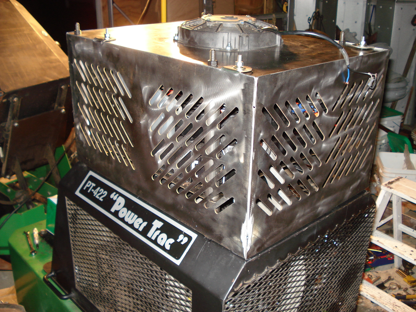

If you have the skills (e.g., welding, mechanical knowledge), I'd suggest trying to shoe horn a liquid cooled engine and mount the radiator outside the tub for better cooling.
Remember Scarg and his liquid cooled Kawasaki 29 HP conversion? He had some serious problems trying to get it all to fit in (understatement), and ended up selling it shortly after he finished. If you did that, you should probably plan on welding a short extension on the tub to get it to all fit inside.
http://www.tractorbynet.com/forums/power-trac/109459-pt-429-robin-22-hp.html
http://www.tractorbynet.com/forums/power-trac/110268-pt-429-project.html
http://www.tractorbynet.com/forums/power-trac/112869-2004-model-pt-422-modified.html
As long as you are shoe-horning a liquid cooled engine in there, how about a liquid-cooled kubota diesel....
