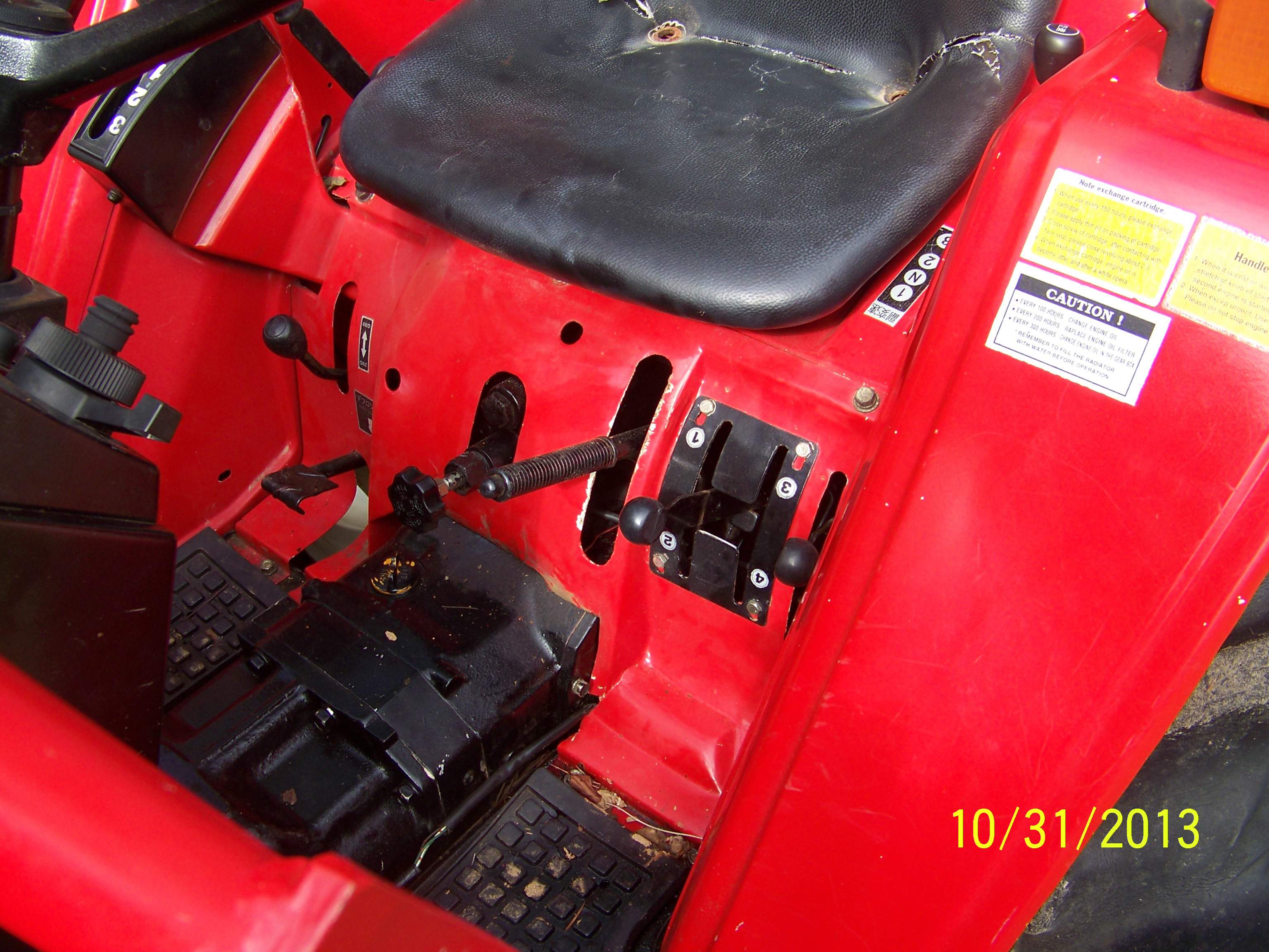

Needing advice. I have a Fx24d and last evening i was pulling a small shed across the drive way and Iit just stopped moving. Shifted range selector down to 1 and it worked fine. Retried 2 again after unhooking and it worked as it should. Hooked back to shed and moved a few feet in 1 and then lost everything. Tractor will not move in any range or gear. Any help would be greatly appreciate. Thank you

Try putting it in 4 wheel drive and see if front wheels will pull. Welcome to the forum. :welcome:
   / Wont move #3
Does PTO still work? Will it move with differential lock engaged? Check for broken power shift relief valve spring in top of transmission.

Was in 4 wheel at time. Took it out and tried and also put back in 4 wheel. Still nothing

It spins when engaged and stops when clutch is depressed. Didn’t hook anything up to see how much power is at pto thought

I suppose you have tried moving the range shifter to different positions? I believe I would also try putting a bit of a bind on the pto also. If the pto does have power then that would eliminate the clutch as a possibility. Also try Norms suggestion of engaging the differential lock.

Tried diff lock. Nothing. Will hook up pto when i get it home. Also on the range selector it should be 1-n-2-n-3. But it seems like it is only hitting 4 detents. If that makes since
   / Wont move #9
Would think yours would look like this. Should have 4 range shift speeds. Also, if you have the grandma lever (the one to the right in picture from the range handle) make sure it has not moved. 100_6507.jpg

No grandma lever.
