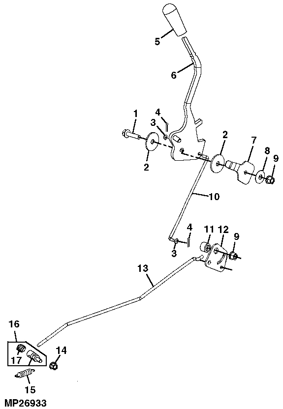

how do i adjust my 4410 so when i set the throttle, it stays at that rpm? when i get it to PTO speed and let my hand off the throttle, it backs off.
i've tried tightening the already tight bolt on the side of the throttle bracket but mad things worse, now when i move the lever the engine rpm doesn't move at all. i loosened it all the way and made snug, and the rpms dont drop back down to 600 or so...they hang at 1000.
   / wont stay at full throttle (4410) #2
Didn't I recommend JDparts to you in another thread:laughing:
Look at the picture below, you need to tighten bolt #1 and/or replace the friction washers (#2)

how do i get to that bolt/washer? what are the steps to take off the body molding to get to that area?
   / wont stay at full throttle (4410) #5
Well, if you want expertise, Kenny is the guy!
As far as remove the cowl, see the attachment. That tells you to remove several other components, but it looks like some of it is pretty intuitive.

got it. thanks guys. holds steady now.
