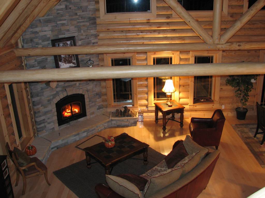

I burn my firebox 24/7 with the blower on and doors closed so it dumps heat into the house constantly. It needs to be fed every few hours and consumes a LOT of wood. I estimate that I have a three year supply given what I cut down to make room for the house and what the sewage authority pushed over for the new line. After that I'll be like my neighbor who looks for free wood all year round. The wood isn't covered so it gets wet in the snow and I don't have enough inside storage to wait for it to dry out. Drying it out consumes heat and lowers the overall efficiently a noticable amount. However...it puts off enough heat so that the furnaces don't run at all during the day and the one on the second floor doesn't run at night unless the fire goes out.
So far it's definitely worth the effort and if you have the time to invest you can save money.

Mavrik02,
Beautiful house you have there.
Kevin
