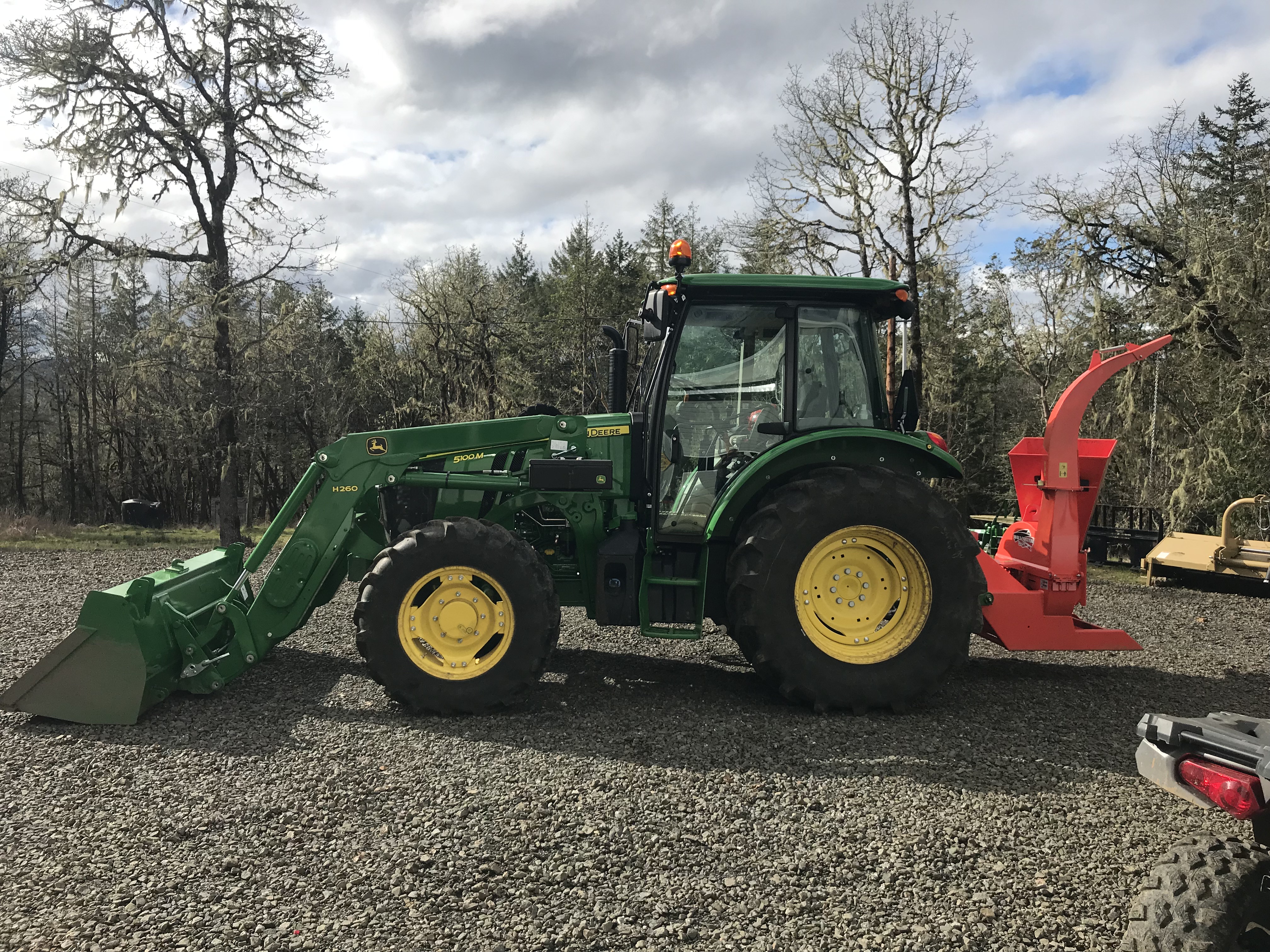

I have a Wallenstein BX-62R which is essentially the discontinued version of the 72R. I run it on my Deere 100HP tractor. It works great for chipping fir, oak, and pine. Green wood chips better than dry (less shear bolts breaking). While piling and burning is easier physically, a huge plus for having a chipper is that I can work year round. If I had to do it over again, I would definitely consider a hydraulic feed version, but that's not to say that a gravity feed doesn't work well. It's just much more physically demanding.

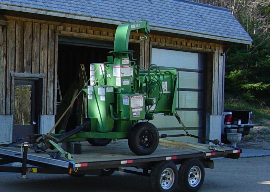

The brush bandit is 12". I am thinking about putting an autofeed on the thing. Looking for a suitable tach with alarming outputs. It would be a neat project. Albeit, yet another one! For larger material, which drags the under-powered tractor down, it would avoid having to stand there and operate the feed manually.
A hydraulic discharge chute rotator would also be a nice option.
I think it needs more safety stickers.
