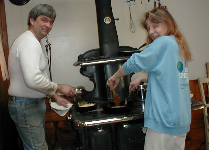

we have a prize herald here in the new old house and let me tell you i love to cook on it. last night breaded chicken, brocoli, and a noodle package dish. the stove likes small wood so get a little splitter. i split on the porch and keep hand fulls ready to go. put a damper in the smoke pipe and remember to move the pots around to vary the cookin temp.. have fun and good eatin.

Woodmills1,
Thanks for the reply and the pic. Looking at all the utensils hanging on the wall I would guess you cook a lot on the stove. I figured I would use this mostly on the weekends.
The stove came with a pipe flue damper but I was not going to install this as the stove itself has 4 air control valves. How come you recomend one?
