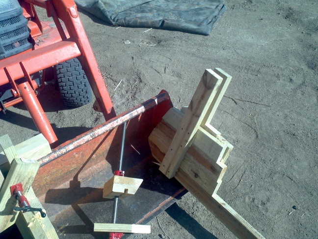

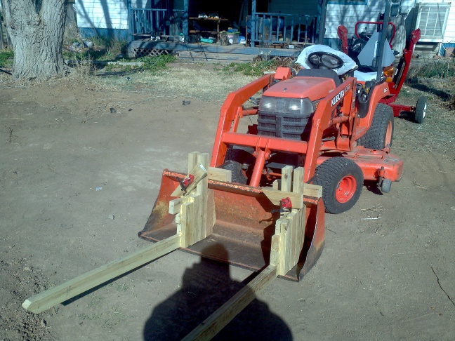

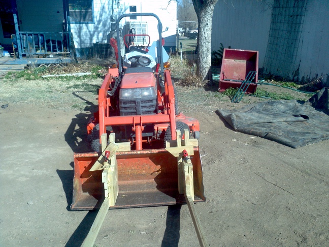

I have been debating pallet forks and have been suffering from sticker shock on the combined price of forks + a quick attach system. Knowing that I was not going to figure out what I wanted soon I came up with a set to use now. It would help me decide on if I would be happy with fixed width forks.
They are constructed of NOS twisted construction grade 2x4's glued with lots of polyurethane. I jointed most of the glue surfaces flat. They are not centered because I did not want to remove the level indicator on the bucket.
Pros
I have maxed out the lift capacity of the loader using them without breaking.
The are attached to the loader using 2 pipe clamps and can be attached or detached in a minute or two per side.
Cons
Butt ugly but I was not going for looks.
Do not like the forks in front of the bucket idea.
The forks are too tall to go into most pallets. I plan to plane them down a bit.

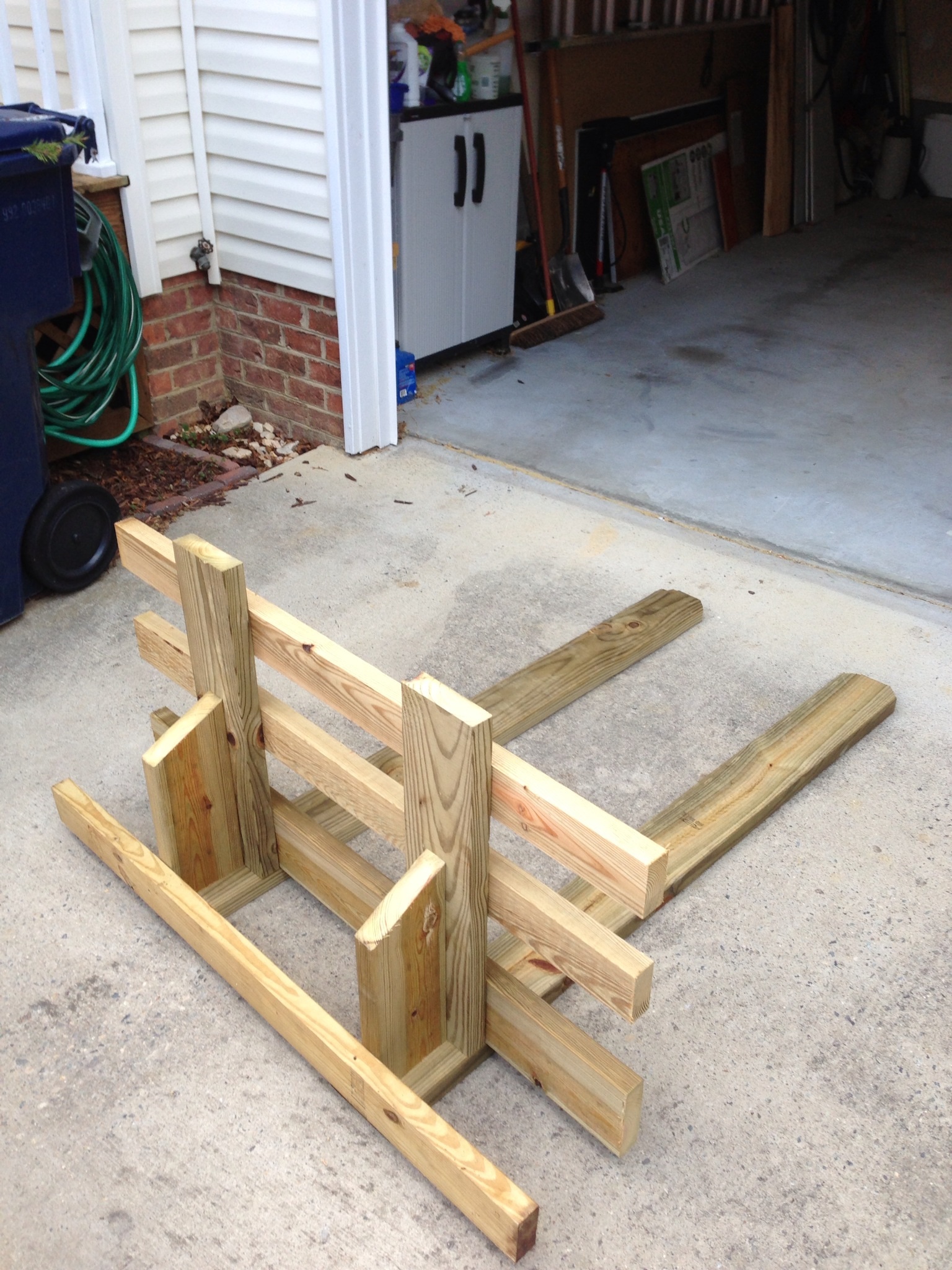

I did something similar for my B when I needed forks ASAP on our house job site. They have worked great. I plan to beef them up with angle iron when I get a minute.

Yours look nicer. I built mine as a way to explore my use of forks prior to buying. I planned to trim off the longer boards with the band saw but it is just looks. I tested mine past what the tractor could lift. No problem with strength.
I have been building a pond in the back yard and setting railroad ties along the edge. The quick on/off thing with the 2 pipe clamps makes it a no brainer to install and remove as needed. Still I want a basket like set of forks and a quick change some time. This one is good enough for now.

LOL what can I say. Maybe you should have glued them to the bucket ;) It took a little head scratching to figure out this attachment method. So far it is rock solid. For the forks to come loose it would have to rip the lip off the top of the bucket for about a foot on each side.
