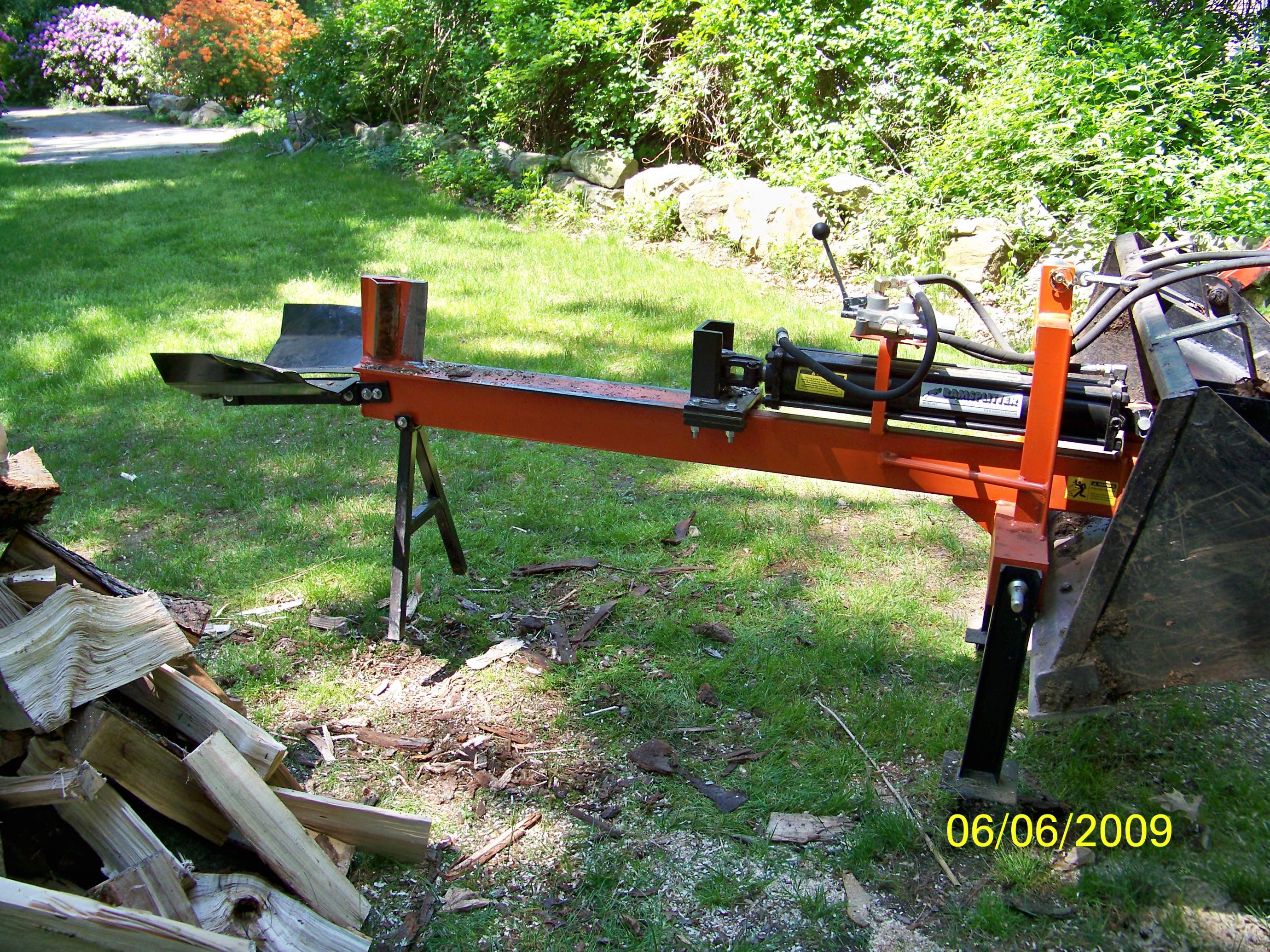

I have had this 3Pt unit for 8 years - used to be ramsplitter - I added legs and a tripod leg, 4" cylinder and 4 way head use this on the front of my B21 with 15' lines connecting to the BH ports.
I lift and cut about a 1/2 cord using the BH then swap the lines in 2 minutes and split. The 4 way wedge doesnt split above 8-10" diameter. I run the tractor at 12-1400 RPM and the return time is just enough to get another log.
