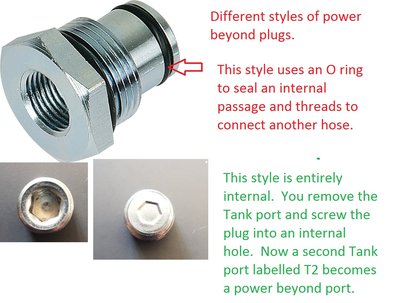

Your plumbing is completely wrong!!!!
First, your first valve in line needs to have a power beyond circuit. This is usually an optional sleeve or plug which you buy and install. Since your latest valve is the newest, see if you can buy a power beyond kit for it.
The power beyond option is to feed or provide an IN or Pump port for the second valve in line.
You should never use an OUT port of one valve to feed another. OUT or TANK ports are only designed to handle around 450 psi and when the second valve calls for pressure the first valve's pressure on its TANK port will greatly exceed its rated pressure.

Firstly, if you want to add another valve bank inline with the first valve bank, the first valve bank must be fitted with a power-beyond sleeve, and the first valve bank must have an integral relief valve built in or one connected externally to the "P" line correctly.
Why both components?
The tank port of the first valve bank must be free to allow the relief valve to relieve to tank without back pressure, and to allow the returning oil from any operating cylinder connected to the first valve bank to return to tank also.
Now the power beyond sleeve.
This externally fitted sleeve in the first valve bank virtually allows high pressure oil from the pump to continue directly through to the second valve bank without interfering with any relief or returning cylinder oil in the first valve bank, freely able to go back to tank via the alternate "T" port.
