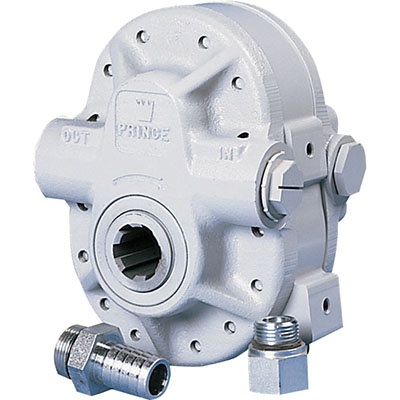

I have a splitter that runs off the tractor pto that I would like to beef up it wont always split some of the big wood I get .
All of the pumps I have found run at faster rpm than my pto , do they make a 540 rpm or even a 1000 rpm 2 stage pump for a wood splitter?

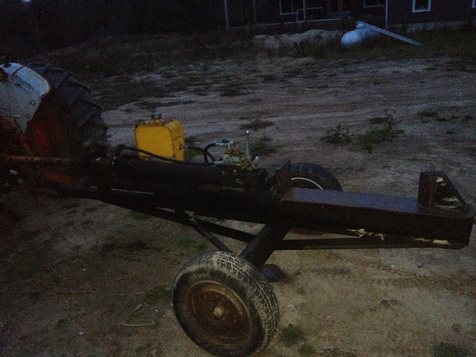

The splitter is made like a trailer with the pump being powered with a pto shaft from the tractor.
I will get a pic in the daylight tomorrow
   / Wood splitter rebuild #5
It will be interesting to see what kind of pump setup you have. I am guessing that because you dont have a normal pto pump mounted on the pto shaft, you either have a gear box to increase the pump speed, or you have a large cuin pump, turning at low rpms, to power the splitter. Is this splitter homemade or factory build.

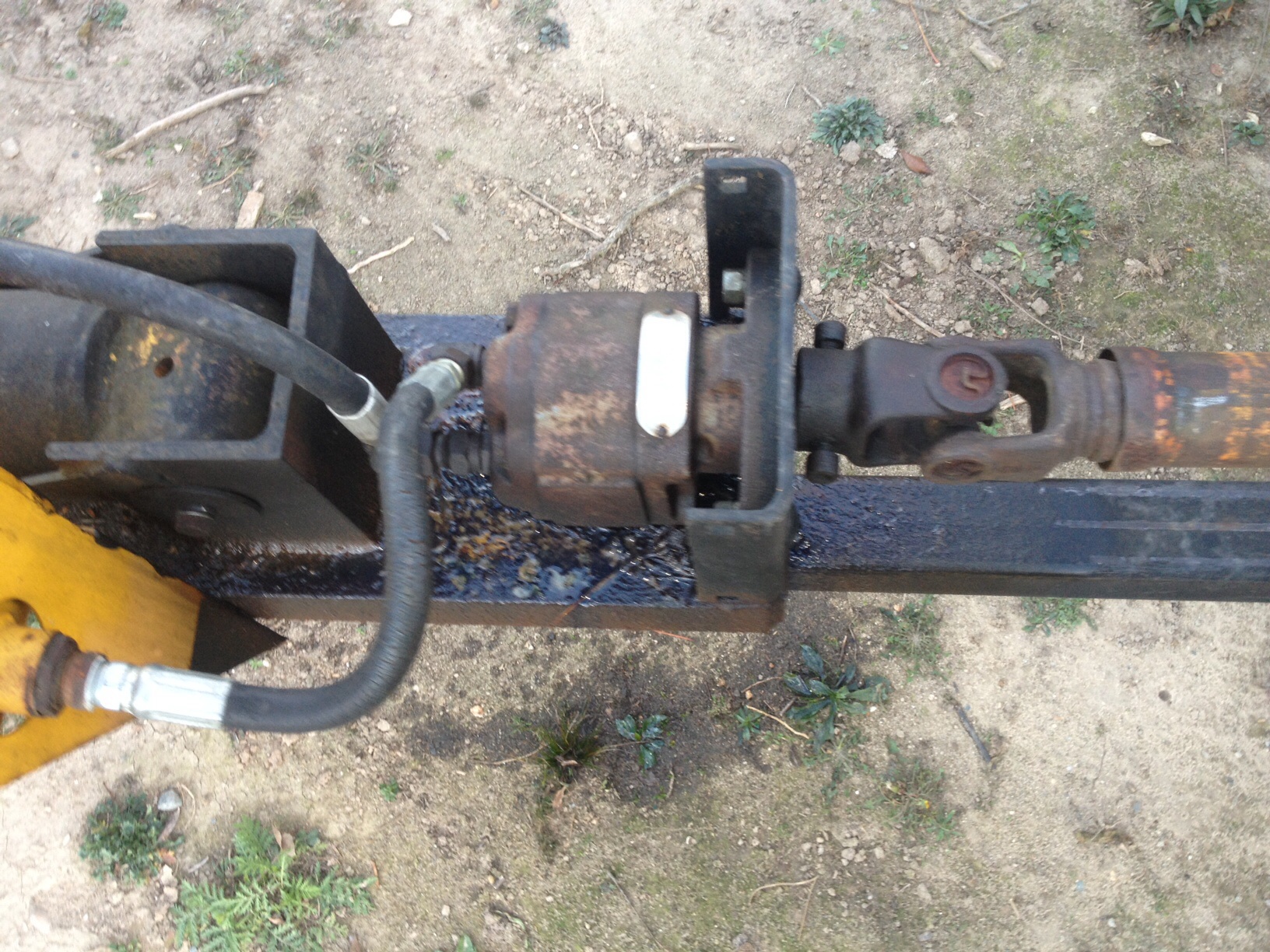

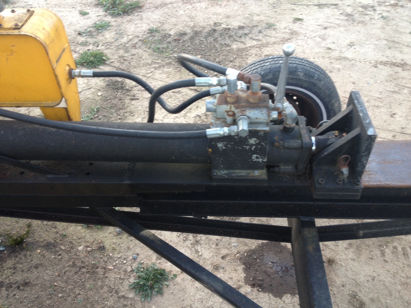

Here is a photo of the splitter
   / Wood splitter rebuild #8
I cant make out anything about the pump, picture to dark. Best uneducated guess is the pump is possibly off a dump/garbage/plow truck, or some other sort of equipment. At any rate, the rpms the pump turns is only going to effect the speed the cyl cycles. Force is going to be the pressure the pump can generate against the area of the cyl's piston. I noticed the wedge on the spitter is a spreader type of wedge. If the splitter is only having problems splitting the crooks and knarly wood, you might consider changing the wedge design to a thin knife type wedge. The knife edge wont pop the wood apart, but it will slice thru those knotty pieces easier than trying to spread the pieces apart.
#9
I think the pump did come off a garbage truck, could not read any of the info on the tag
   / Wood splitter rebuild #10
If you want more power, you need to put a gauge on it and see what you are running now.
I wouldnt even consider increasing pressure without replacing all them hoses. And even then, if you are already at 2500-3000psi, there aint much power left to be had.
Its hard to judge in the pic, but it does look like a smaller cylinder. Maybe 3" or 3-1/2". If so, thats small for a splitter. I have a 4" and 2800psi and a knife wedge, even then, stringy wet elm sometimes dont split and I have to reposition a few times.
And as has been mentioned, spinning it faster isnt going to gain any power, only speed
