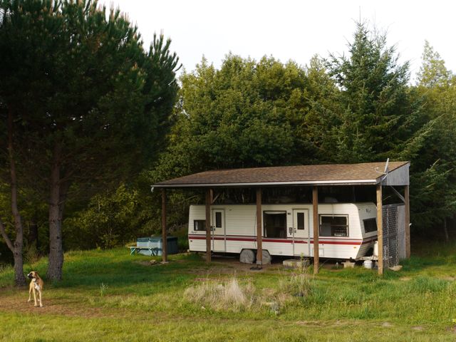

We have a retired travel trailer (28') on the ranch that is used for worker housing. I am considering a small wood stove for heat, as we have an unlimited amount of small firewood (1-4" branches from our 'thin & release' work) available. Has anyone done this? What stove do you use? Any particular recommendations? Did you run the flue through a window, or straight up through the roof? Any suggestions or tips would be appreciated.

Not exactly the same situation, but my uncle and aunt in VA live in a "converted" trailer home, which has an addition on the South side and the whole thing has been roofed over and extra insulation added in the attic. A few years ago, my wife and I bought the smallest EPA rated wood stove, it was made by Century and Menards was running a fall special for $250 for the stove. The stove pipe and class A chimney cost more than the stove... I also had to get a ceiling "thimble" to provide the correct clearance to combustibles where we passes through the trailer roof. The flashing takes care of that interface where one intersects the main exterior roof, just the hole has to be cut to allow for 2" Min clearance to combustibles. We installed that stove in 2 days from start to finish.
It has worked out great for my uncle and aunt. They burn about 1 cord per winter and still have their oil furnace as backup. You will have to do as we did, and build a proper floor protector. We welded up an angle iron frame, laid in 2 sheets of cement board, then tiled the top surface to provide both a thermal break and a fireproof surface around the stove, since small embers will fall out every now and then when loading wood. It also spreads the weight of the stove on the floor.
For a travel trailer it is a little hard to imagine where you would put it. Because of the clearance requirements, it ideally needs to go right in the center somewhere where people can walk around it. You need to look at the clearance requirements to single wall, double wall (stove pipe) and the stove itself. In many cases the clearances may be 16". If the people managing the stove are not the brightest, you have to cover all the possibilities or your trailer will be going up in smoke. The question where to stage firewood will be another important point.

I was a fireman for vol. fireman for 10 years, we saved a lot of houses but we NEVER saved a trailer. IMHO a wood stove in a trailer is a trailer fire waiting to happen. I advise against it.

Without a doubt, no shortcuts can be taken on the install of the stove or the flue, or else the prolonged exposure to heat will finally result in ignition of material that is within the clearance zone of the hot parts of the stove. If ones attention strays for a few minutes too long, the flue temperature will peg at close to 1500F (visibly glowing). This is one of the biggest risks when simple people do not understand the dangers of an untended stove.

I put down a pad from concrete blocks, set it away from the wall, made a sheet metal insert for the window behind it to run the flu pipe out and up.
Turned all the way down that thing screamed! I even put a box fan to circulate the heat.
I tried it for a couple weeks only burning it when I was home and awake. It was still scarry dangerous. I took it back out and sold the stove!
I would not trust employees manage a stove like that.
