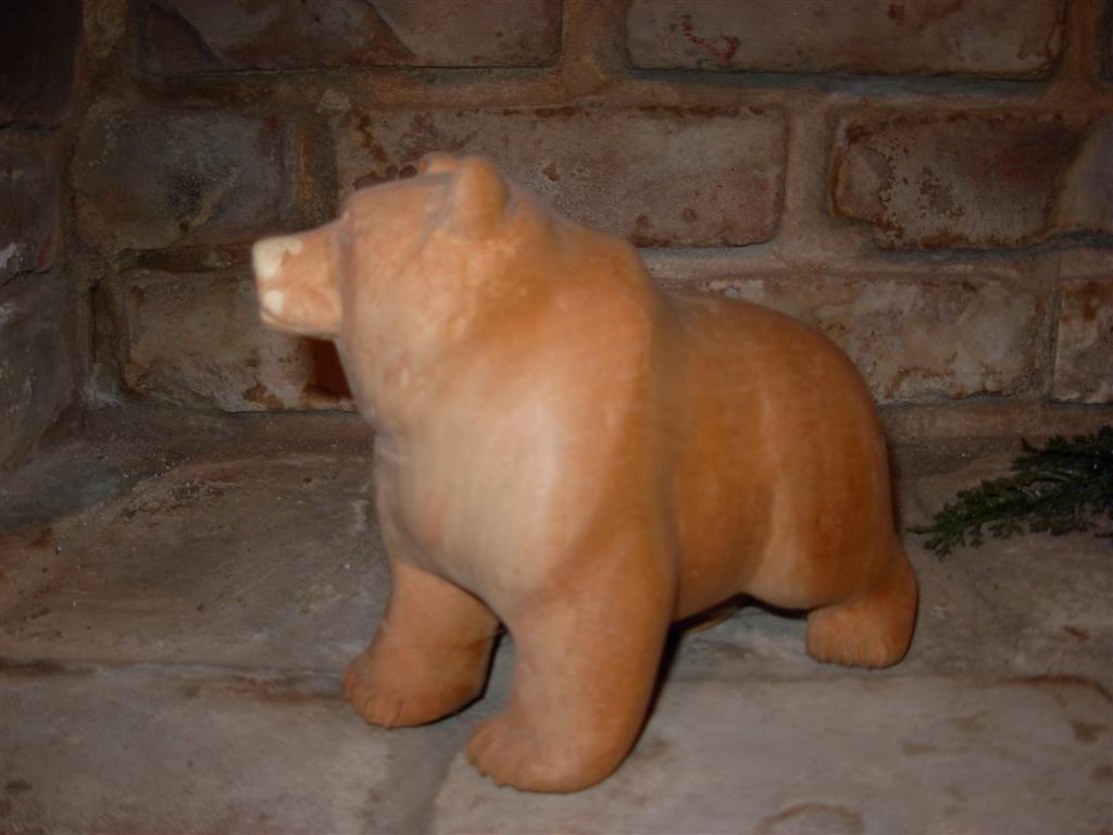

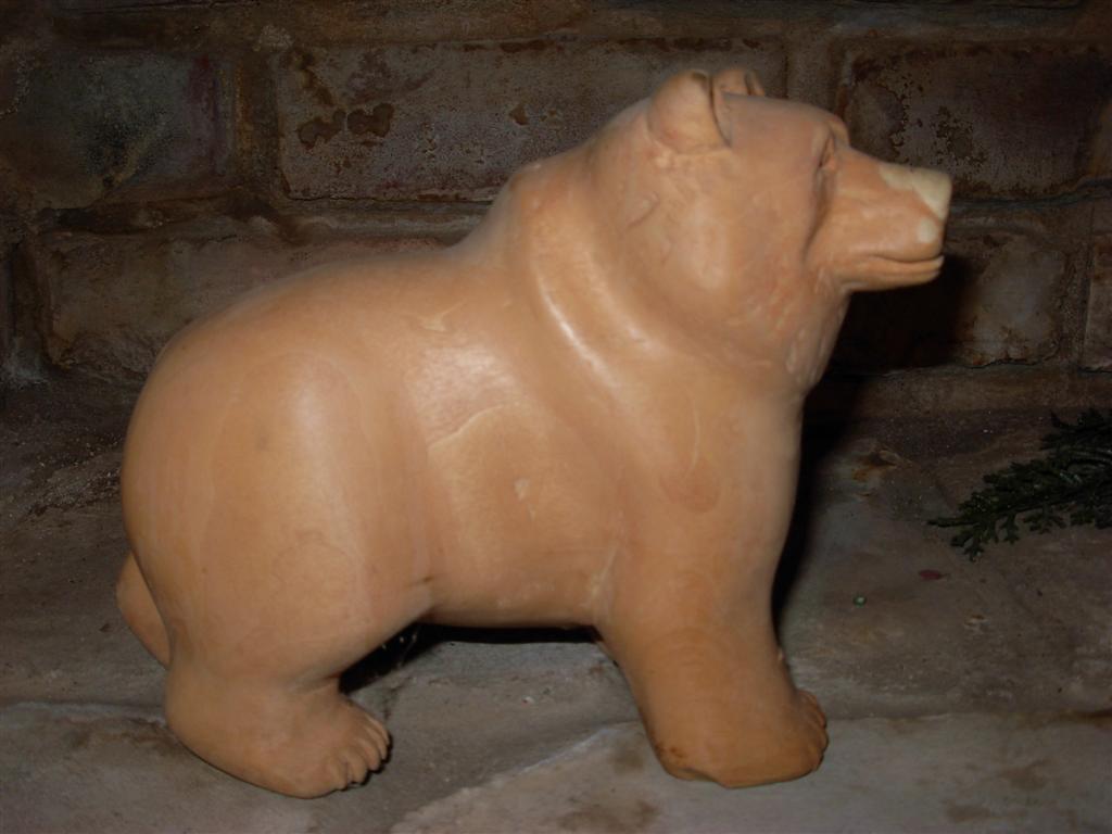

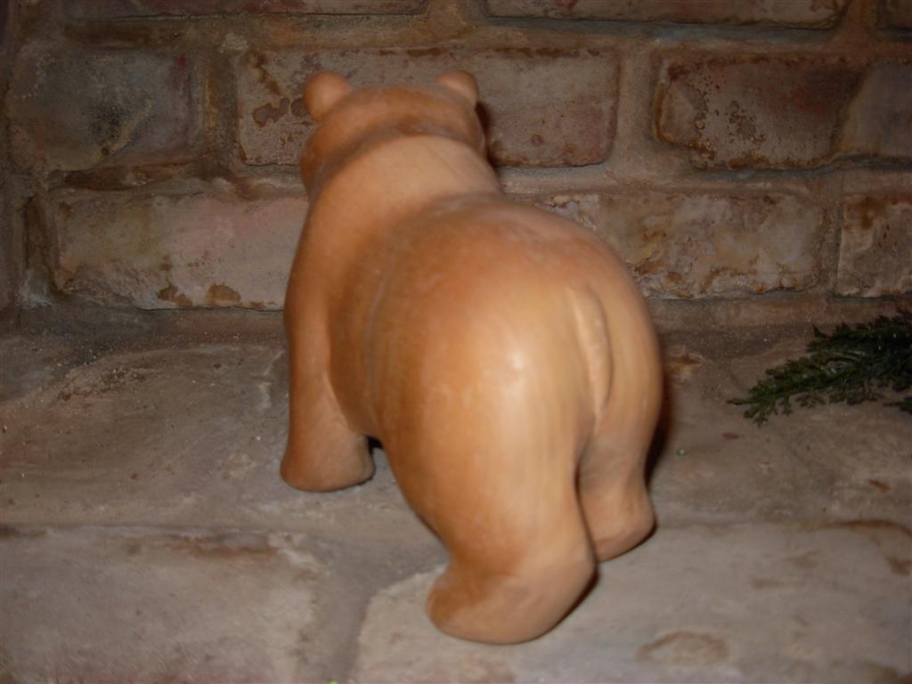

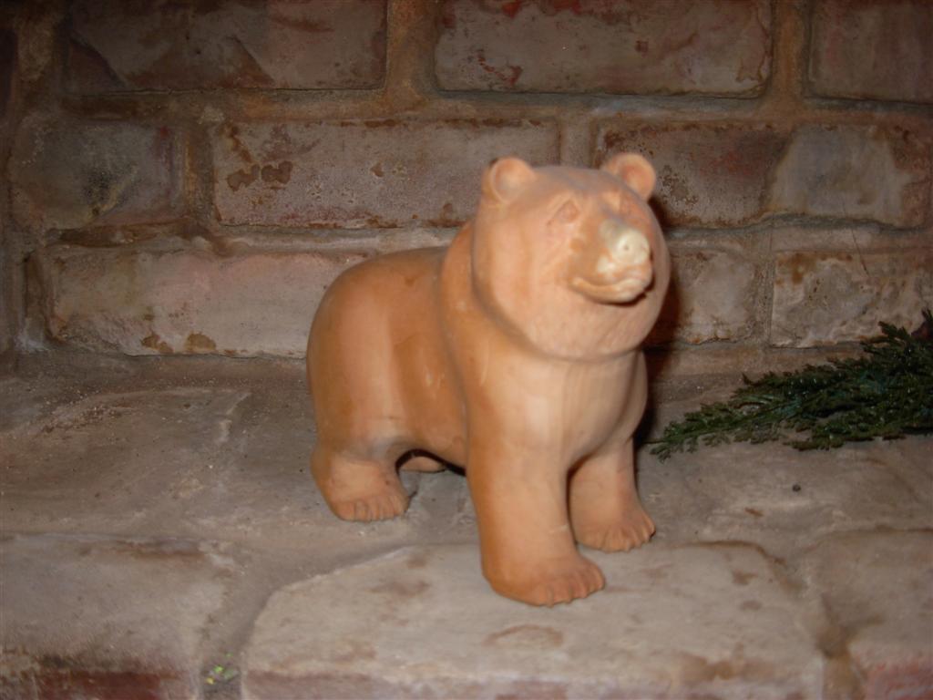

I've not used any of these for carving but poplar would be easier to work than oak or maple, I know nothing about hickory. The wood I used for carving was Bass wood it is softer and its grain doesn't fight you like some woods will.
I used chisels, I'm not sure where they are anymore. I think some people also use dremal tools. I guess you would call that sculpting more then carving.
I only have one piece left, the other I gave away. This one I messed up the nose and I cheated a little with wood putty.
I did this one in 93. I would consider myself just a beginner and probably not much help.
