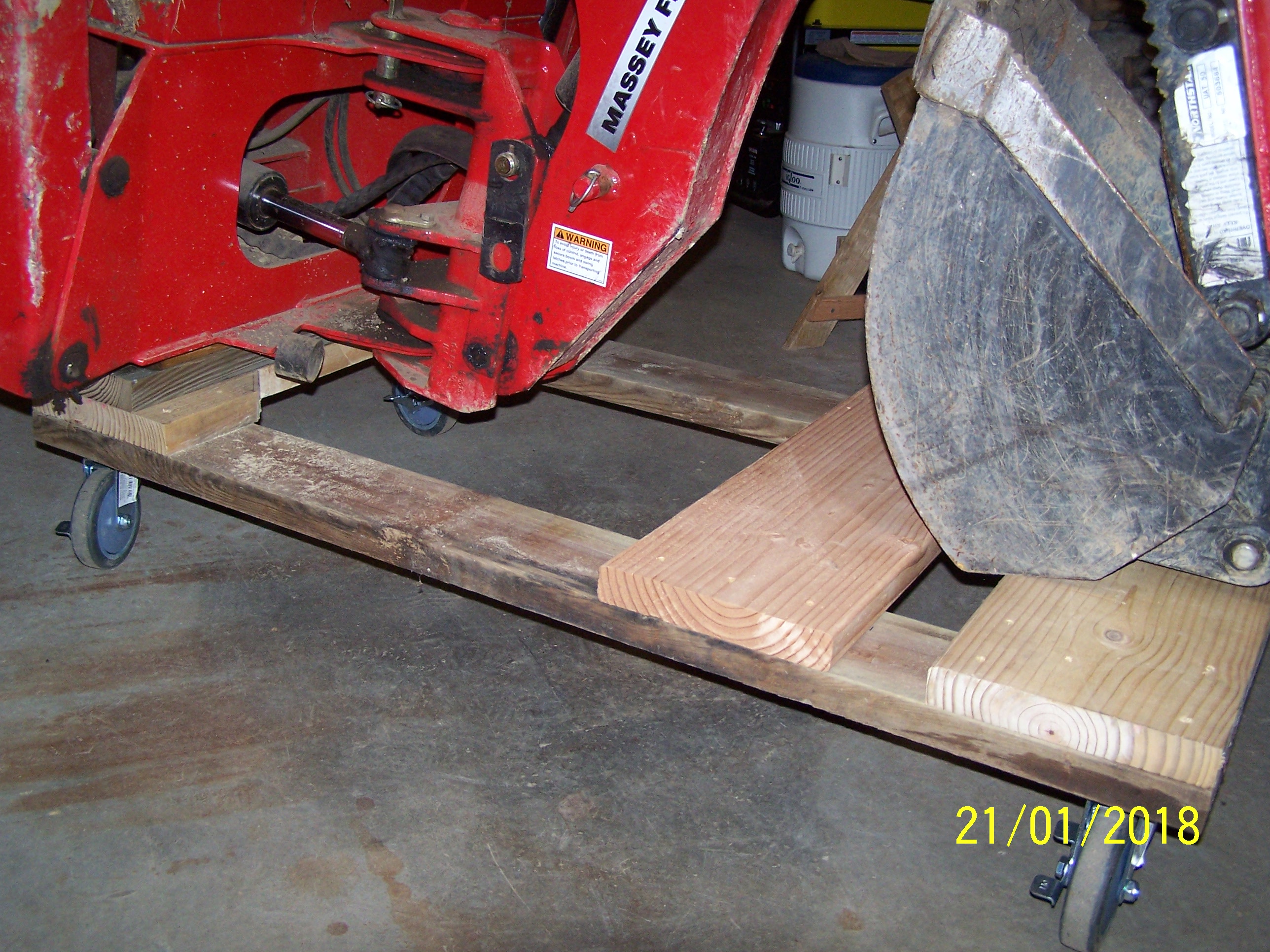

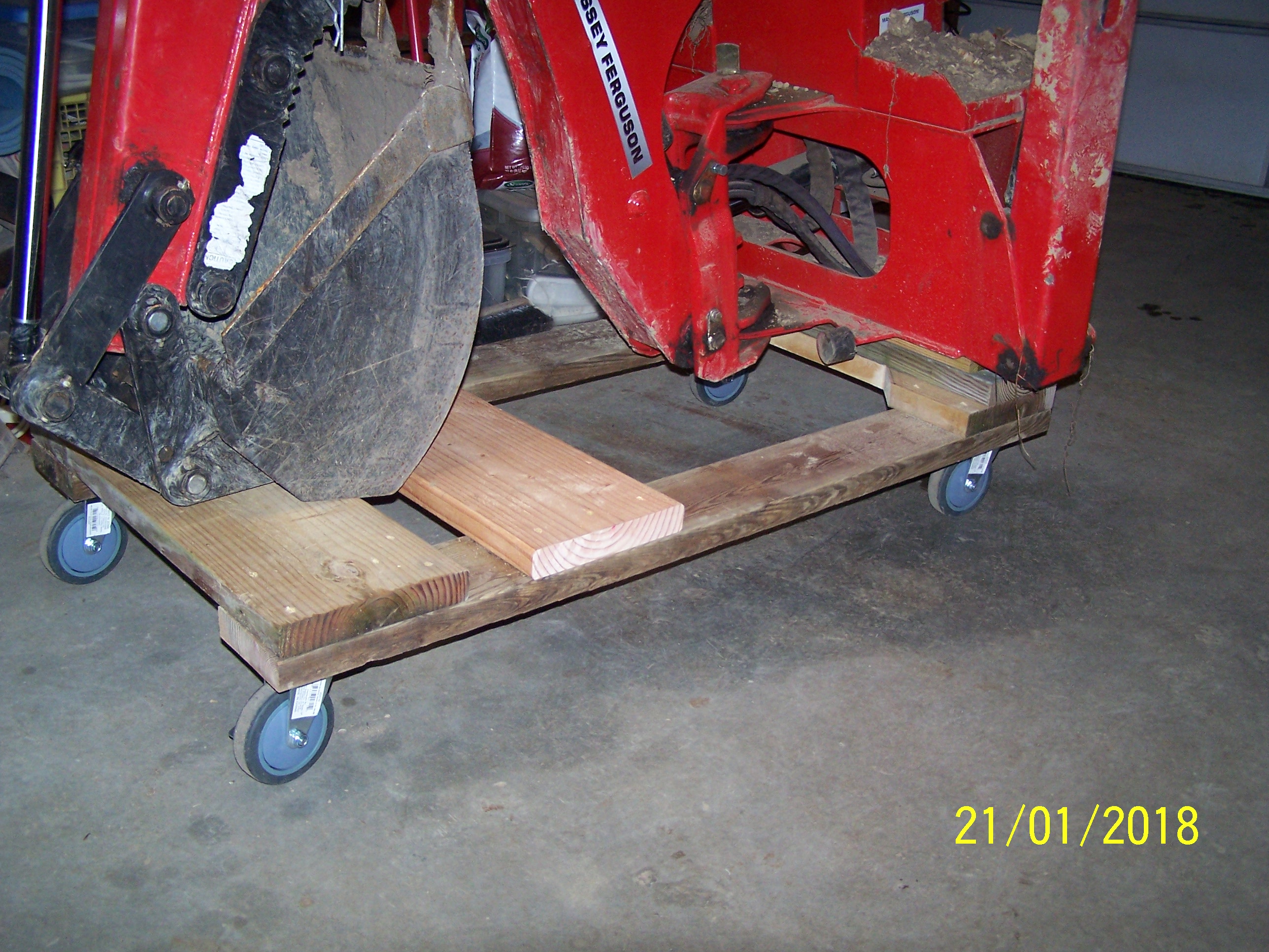

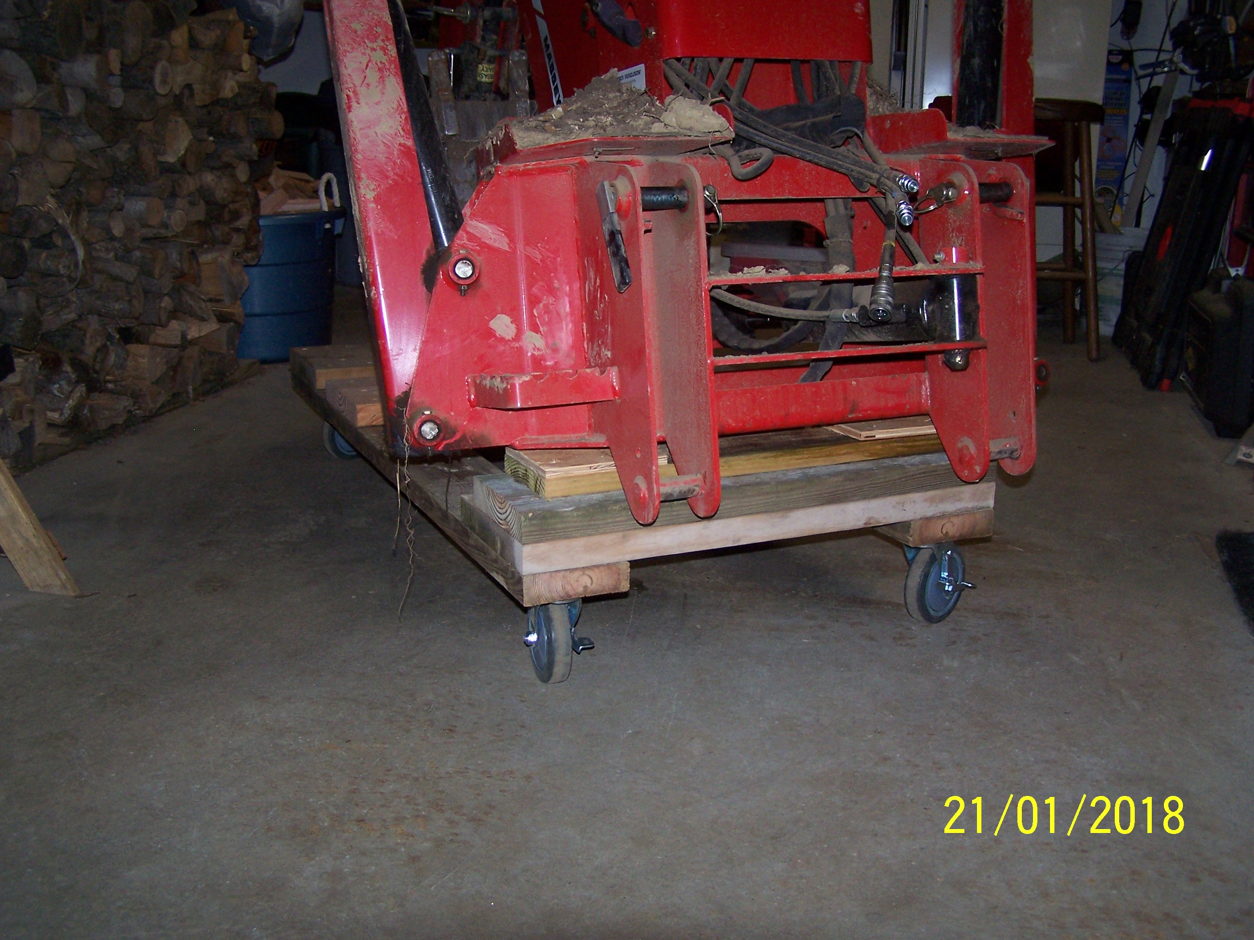

Been wanting to do this for awhile, finally got it done.
It ain't pretty, but it works.
Had a gift card for Tractor Supply, picked up 5 inch wheels and some bolts.
Reused some lumber from a deck I rebuilt, and some scraps from different jobs.
The dolly is 28 x 54.

Looks like a winner to me. As long the casters at heavy duty enough, you got it.( keep in mind when I do something, I tend to overkill things)
   / Wooden Backhoe Dolly #3
Very nice!
