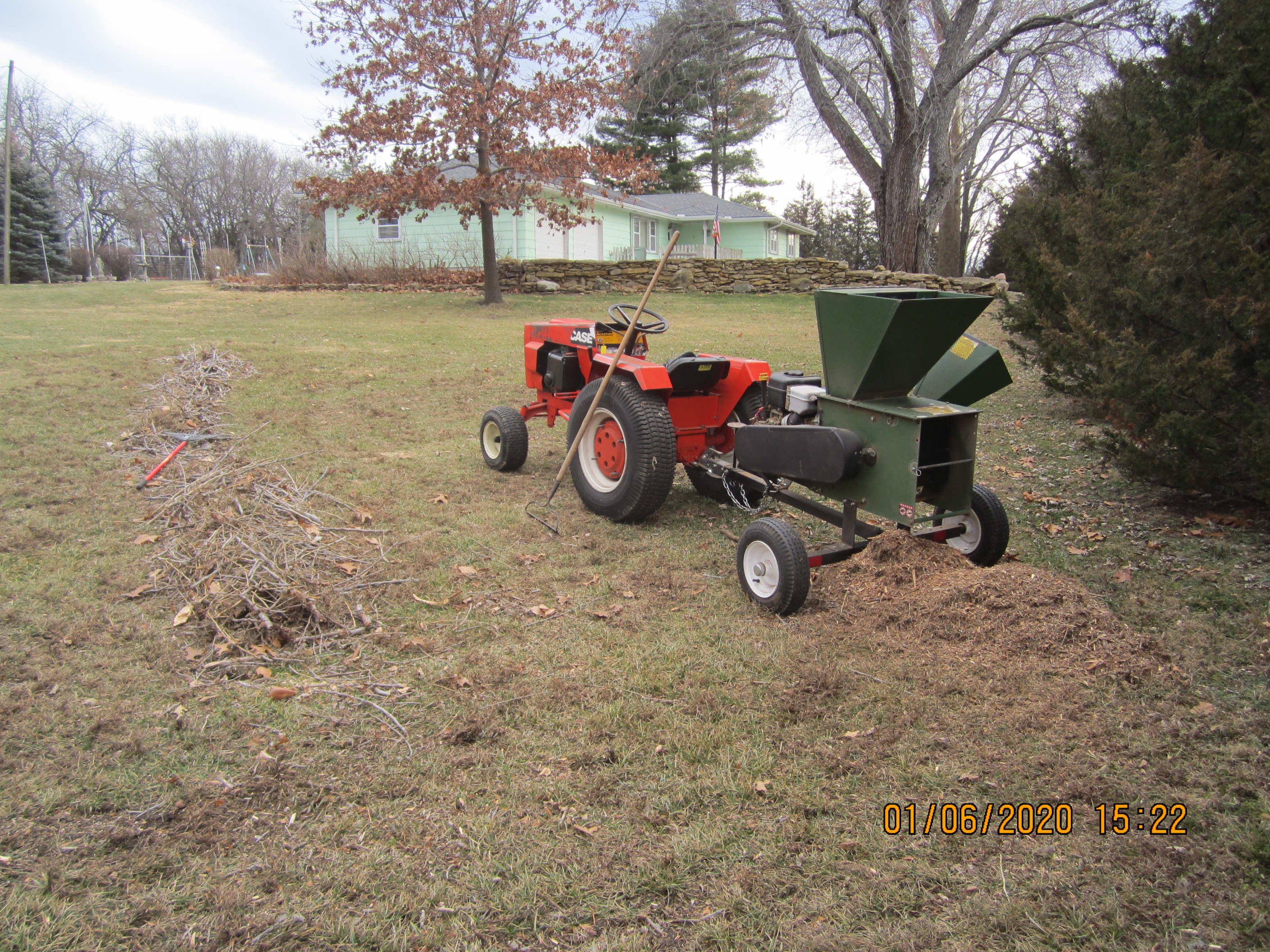

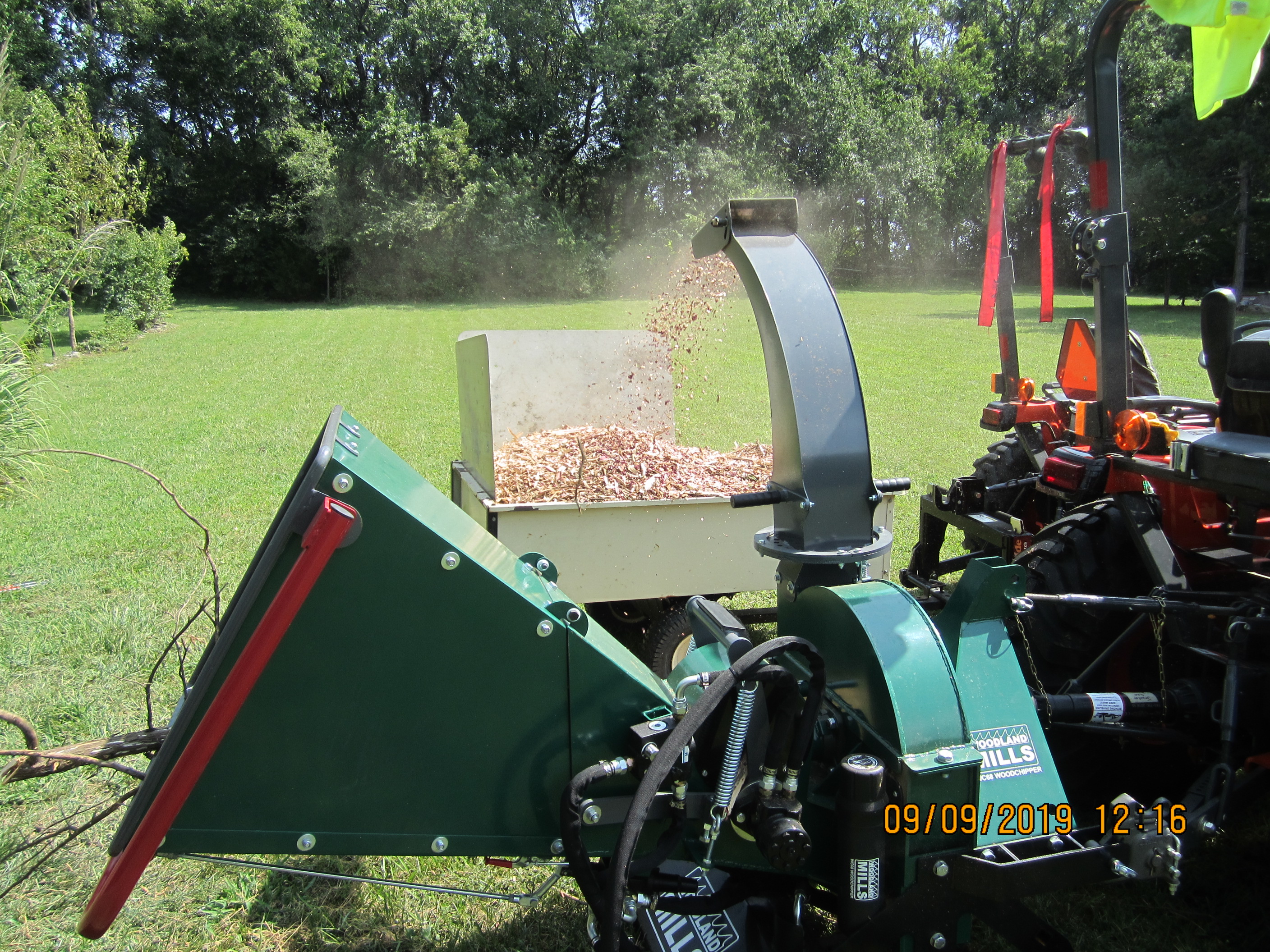

I use the Woodland Mills WC68 on both of my Kubotas (19.5 PTO HP). They handle the bigger stuff with the hydraulics turned down a bit. The WC 68 is great on handling larger volume jobs, especially with the hydraulic feed.
But I also have (for 11 years) a MacKissic stand alone chipper/shredder that I use on smaller chores and find it just right for smaller jobs.
Both companies have been real good on customer service and make really good equipment in my experience.
Cheers,
