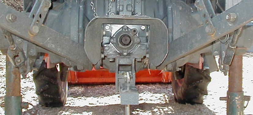

I got my L4200 as a transport system for a Woods 9000 backhoe, and have never removed the backhoe. The backhoe is on a subframe mount. I am going to start running 3pt implements, but it looks like the backhoe rear mounting plate uses the 3pt hitch arm mounting holes. If that is the case, I suspect that going from backhoe to 3pt is going to be a serious time-consuming PITA. Does that sound right?

Hello JayC...
Hope you finally get the 3pt licked... It is way too handy, but then so is a BH, I have always wanted to put one on my L4200, but with a cab it presents a bit of a problem...
Here is a picture I took years ago while I was changing from AG tires to big Turfs.
Hope you can see where the 3pt arms attach, if not I'll shoot another picture for better view...
And YES if the subframe is infact using the 3pt mounts it is going to be an itch to switch back and forth... Good luck, KennyV

Thanks for the pic, Kenny. You are truly 'the man'.

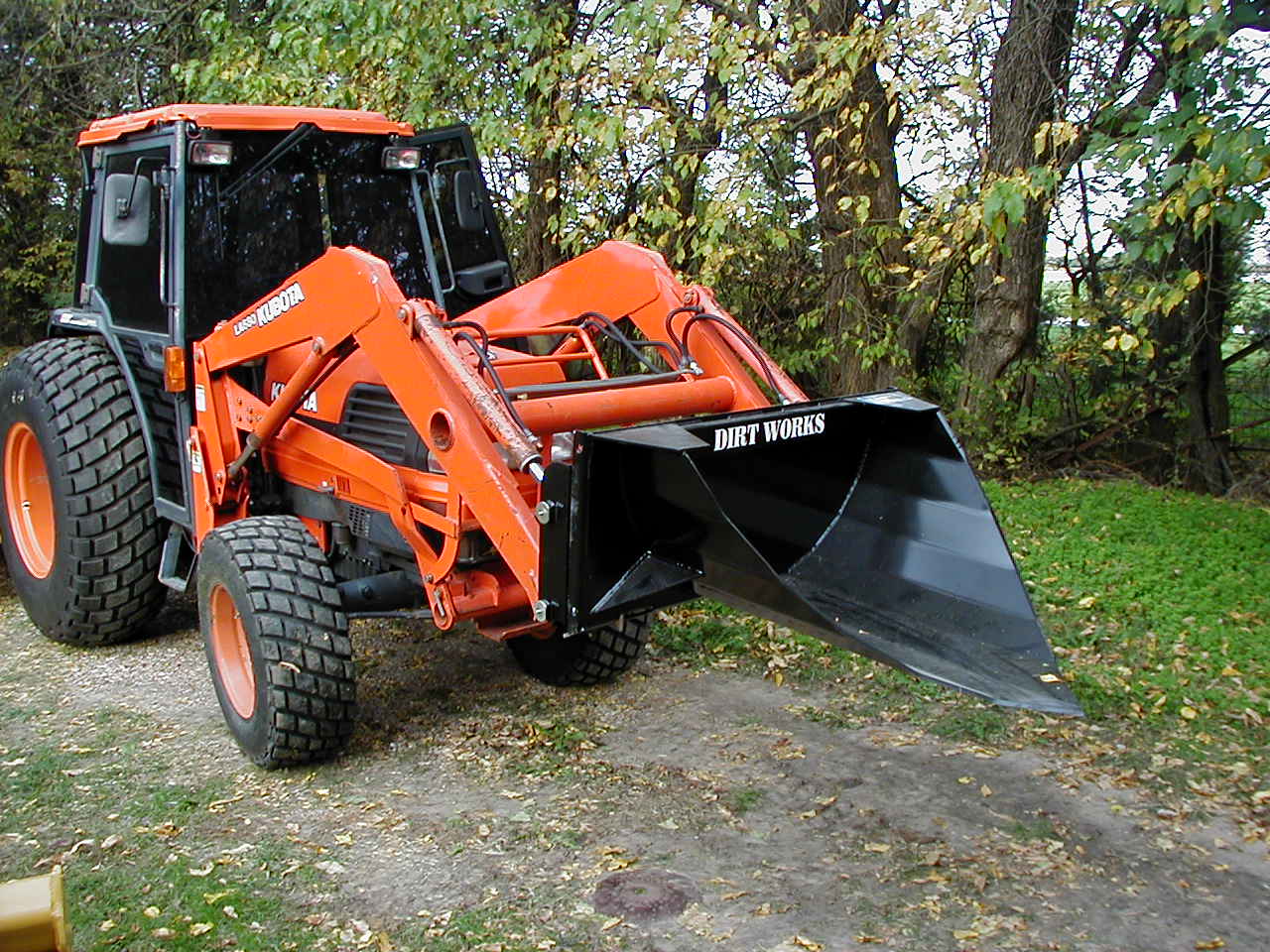

Know just what your saying... no matter what you have on, you are going to need to switch to something that is a pain ...
You can spend about a grand, to put a skid steer adapter on your loader;
SS adapter around $5oo
pointy bucket (like the attached picture)around $400
SS plate on your existing bucket about $100...
Then you could dig up the medium size boulders, and start a collection of handy SS attachments.
Even then you still have to swap attachments... it's just a lot quicker & easier. KennyV

I've thought about one of those SS adapters - a friend of mine with a new Kubota is always trying to talk me into it. The coolest setup he runs in a 3pt hitch adapter, so he can run any 3pt implements (just backwards), using his FEL arms.
I downloaded a manual from Woods, and it might not be too bad - I do have to remove the rear bracket, but it looks like I just have to loosen two bolts, then pull two pins to remove the thing. That might not be so bad.
