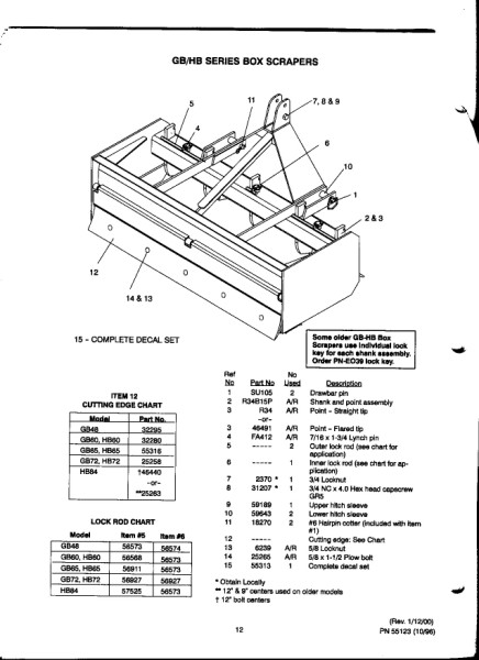

AlanB,
Here's a JPEG scan from my HB owners manual. It lost quite a bit of resolution when it was "resized", but might be readable. If you want a better resolution version, PM me with your e-mail address and I'll send the original JPEG (about 300k).
I don't know if this is a similar set-up to your BB. Mine has wedges (parts #5 & #6...outer and inner lock rods) that are held in place with lynch pins (#4). If you squint enough, you might be able to make it out.
Hope this helps.
~Rick

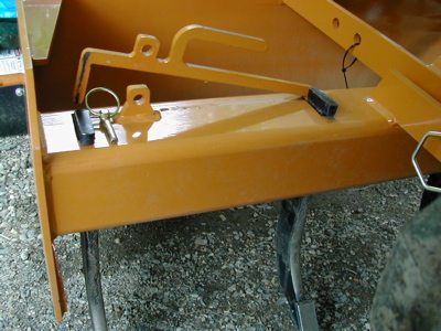

I don't know if your GB is the same as my HB,but here is a pic. of the bracket that holds the teeth in.
   / Woods, BB, Teeth #5
</font><font color="blue" class="small">( I don't know if your GB is the same as my HB,but here is a pic. of the bracket that holds the teeth in. )</font>
Yes, the GB is essentially the same as your HB in this regard - my GB 60 uses the same style wedge bracket and a lynch pin to hold the rippers in.
