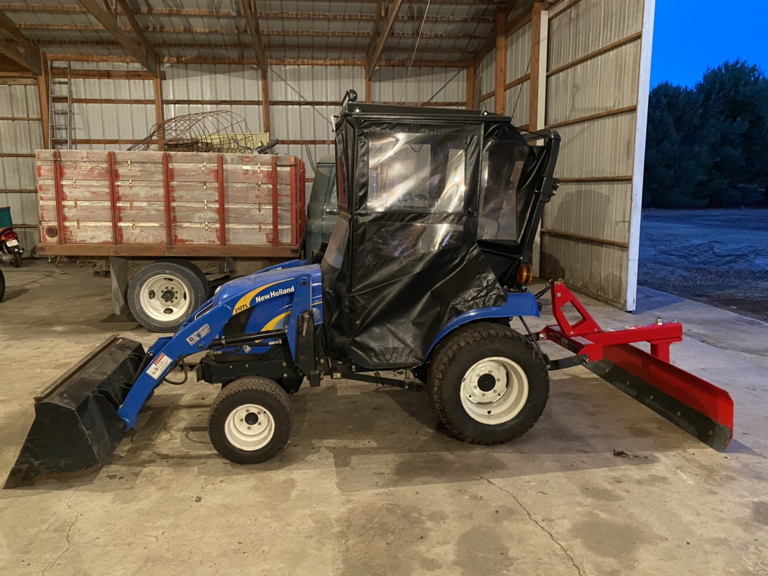

I have a NH T1110 that I plan to do some light dirt work and gravel driveway grading. I was looking at the Woods RBS60 blade for this work. Anybody have a Woods Blade? any feedback?

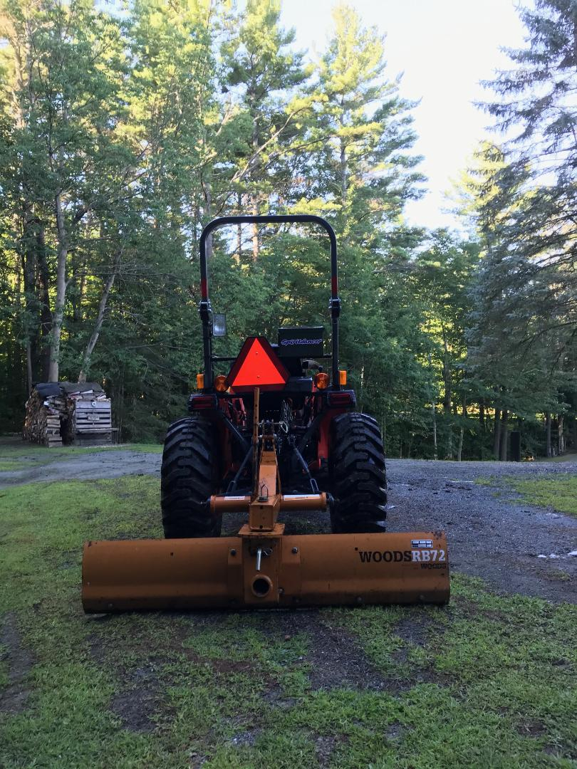

I have Woods RB72 15+ years. done lot grading snow plowing etc. etc. even tangle with metal mailbox post trees no damage to Woods indeed (y) just wish I had gotten offset Woods blade at the time.

Thanks for all the replies so far. As a couple of you have noted this tractor is quite lightweight and so is the blade I picked. Tractor weight (minus the loader and MMM) is around 1500, and the RBS60 blade is quite light at 160ish pounds. Is 60" blade right sized for a 28 flywheel HP tractor, or should I go up to a 72"? I have a front mount blower that works very well, and the only snow removal I would do with the blade is to back up to the garage/shed and drag it away for easier blowing. Width to the outside of the rear tires is right at 50".
As far as buying a used one, the new 60" woods blade is ~600 and the used ones I'm finding locally are $400 or so. My local Case IH dealer is 5 miles away and would deliver.

I bought a RB72p blade last week and was able to spend about 4 hrs working my driveway this weekend. I’m glad I got the 72” for the application. I was easily able to pull the 72” blade full of gravel in the straight and angled positions in 2wd.
I found this new 2019 blade at a dealer that used to sell Massey tractors, but had stopped, and they held the 2019 pricing and threw in the parking stand.
