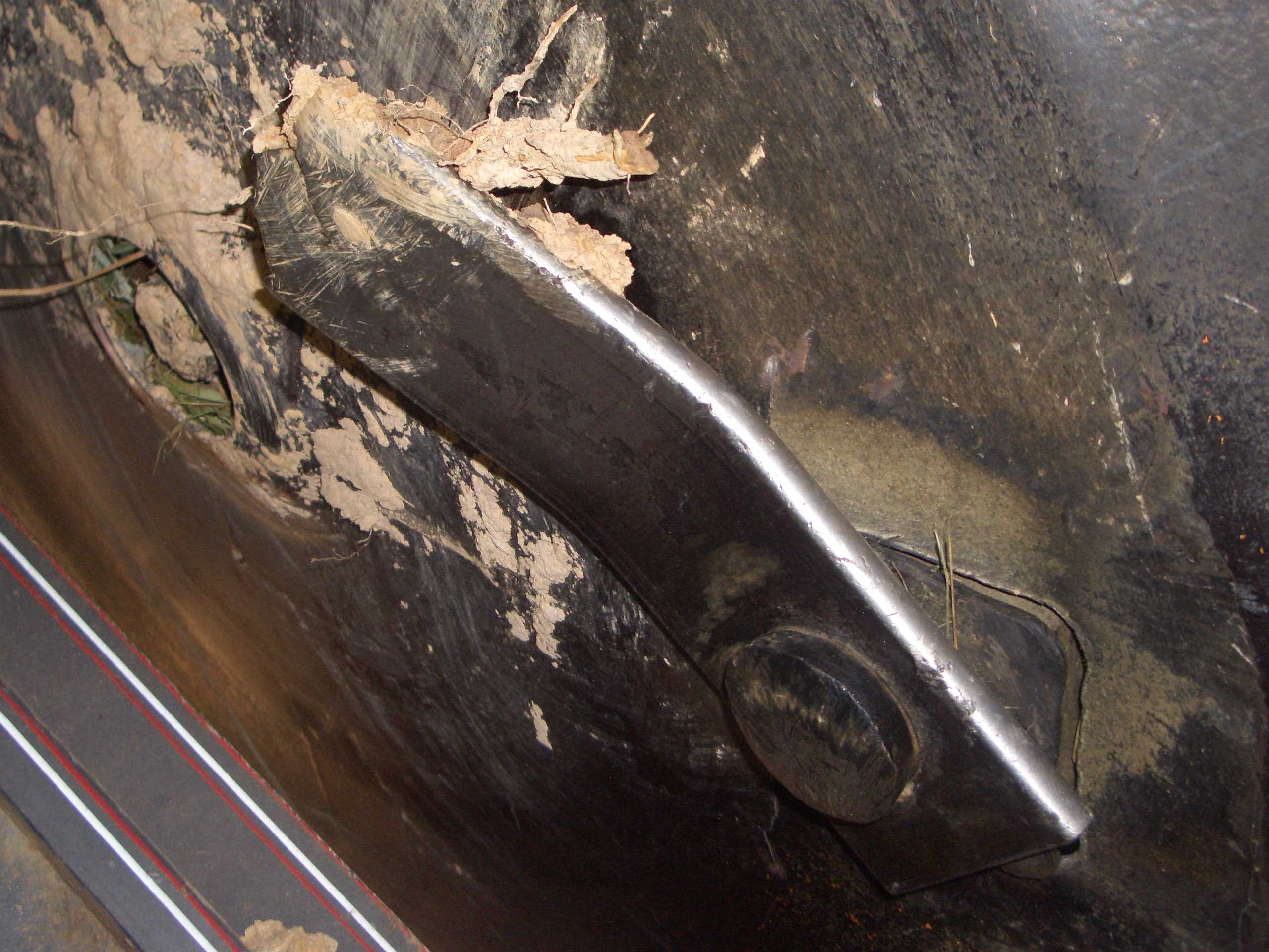

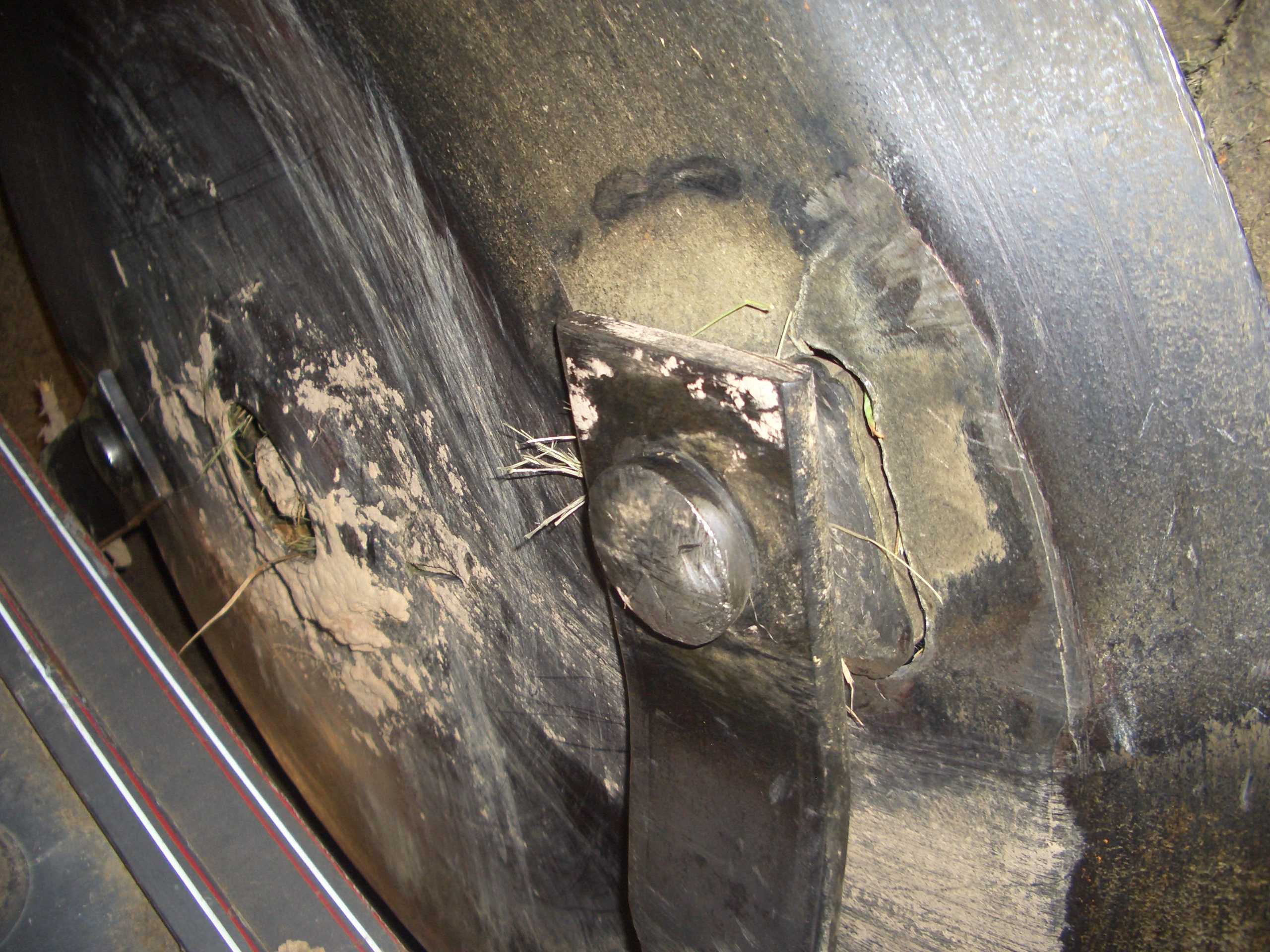

Anyone have this issue with a medium duty Brushbull? I was cutting tag alders over the weekend and heard a loud Whack!! and she started shaking to beat the band. At first I thought it was a blade spun back and pinned by a branch, but when I looked it was a blade snapped in half. Now that's happened 3 times before and with all the rocks and stumps we have, it's expected. What wasn't expected was when I dropped the blades out, the stump jumper pan had broken all the welds to the blade bar and was all flippity floppy. A couple pictures are attached of some of the damage. The broke part of the blade also mangled a baffle on the way out.
So had to drop the blade bar and fix it up. Every weld was either broken or torn out of the 1/4" thick pan. Naturally, the pan was bent too. The old heat and beat method got it pretty straight, but for some reason the holes for the ripped out metal didn't fit the metal. So had to grind and fit them back and then weld up the broke parts and the cracks. Painted it up all nice and replaced it this morning. Now if the blades would get here, I still have a couple days of brush whacking to get to!
(oh, didn't take any pictures of the "after". Too busy doing it to run and find the camera, sorry)

hi i have the same problem with mine ,i own a woods brush bull 840,3pth its taken a beating and the stump jumper has also to the point of breaking the welds at the same place as yours and also breaking the weld completely at the hub . the blade bar hub which holds everything to the gear vertical shaft. i have done lots of welding on this machine to the point it is out of balance and have repaired the hub twice .the metal where the welding for the hub is to stressed and the welds are the same on the stump jumper ,basicly its junk .i bought a whole new stump jumper tired of welding on stessed metal the price is not cheap,thru my woods dealer approx. $600.00 for the pan and 2 new seals this is the last time , if it happens again its history ,im going to another brand, but to be fair to the machine ive beat the h*** out of it ,mowing very heavy and steep ground cutting an average of 3" and sometimes 4" material. ive been hard on it but the way i look at it i make $$$$$$ mowing filth but the machine costs me $$$$$ when i work it this hard its a 2002 yr and its on its way out if it goes again. ive never had any problems with paint or the gear box etc........ have broken several bolts and replaced with grd#8 just my .02cts have a good 1.

I would not try repairing the rotating components you pictured. For safety sake replace all the damaged parts. If that thing come apart at high speed it can do you some real damage. You're lucky the blades you broke didn't get you.
You must be cutting the same junk I do! If it can be pushed over, it gets cut. I did find online places that have the "cross bar assembly 57060" for as low as $340. With the weight of it, I'd be afraid of the shipping cost! I spun it up without blades and it was smooth as silk.
I'm not worried about that. If all the welds fail, the pan is still held in place by the blades and blade pins.
