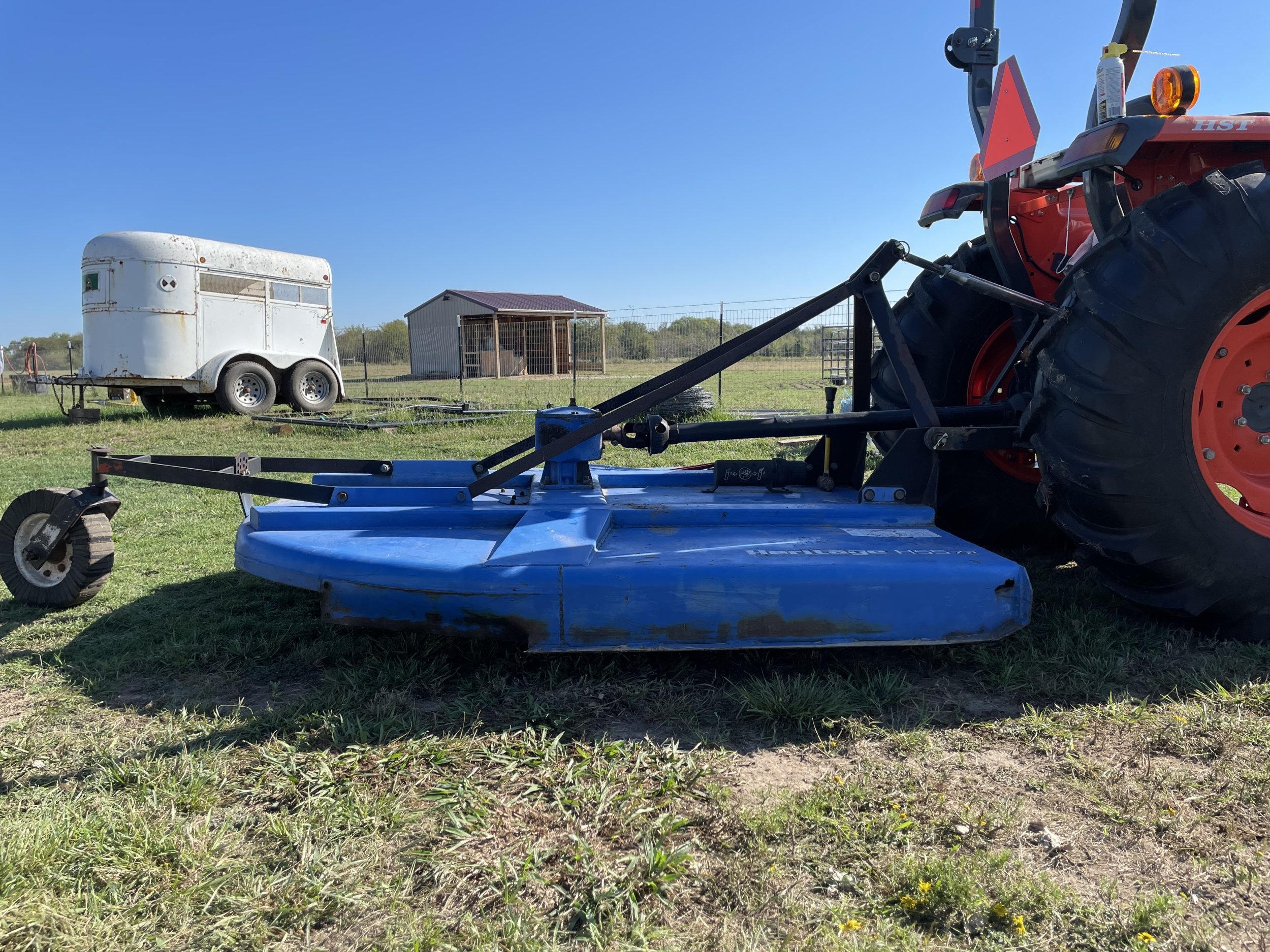

I bought a used Woods Heritage HSS72 and it looks like someone has done a custom setup on it. I need to put things back in their original position but don’t have any pics. Anyone know where I can get a free manual for this cutter or is willing to look at pics and tell me what to do?
With this set up, 7” is about as low as I can cut and keep the deck on a good plane (front about an inch lower than rear). The issue seems to be at the top link where it connects to a pivot arm and the height of the tailwheel.
Any suggestions?

Well, this is embarrassing. Just as I clicked to post I figure out that my top link is extend about two inches too long. Once I adjusted the tl all I had to do was raise my tailwheel. 🫣
