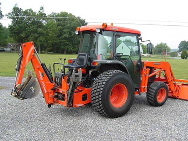

Kendall, I see no problems with a Woods loader on your Kubota. The Woods company make very good equipment. I have 3 pieces of Woods equipment and wouldn't trade them for another brand. As far as backhoes and Kubota cabs, my woods hoe works great with my 3430HSTC tractor. You just have to get the right mount.
Bill

That setup looks beautiful Kubotabilly. I love it!
I am currently talking to my dealer about adding a Woods backhoe to my Kubota that is arriving in a few weeks. (That will make it about 8 weeks since my order. Kubota says there is a tire shortage. The tractor is built waiting for the R4's. Figure that).
I got the idea for it from guys like you here on TBN where you have mounted 3PT and sub-frame BH's to Cab Kubota's. I never did understand why Kubota never offered it. Maybe they see they are missing business.
BTY, I would like to hear more about the option of attaching it to the front of the tractor with a quick attach!
