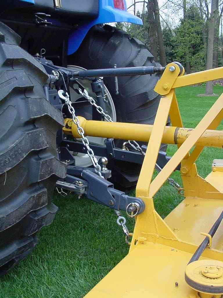

Buy it, it is worth $250 and likely much more if it's in decent condition.
If you are concerned about the lower link front support, try check chains - photo attached.
