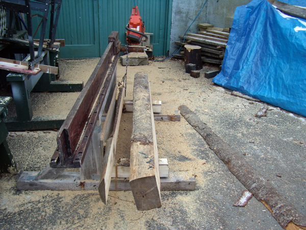

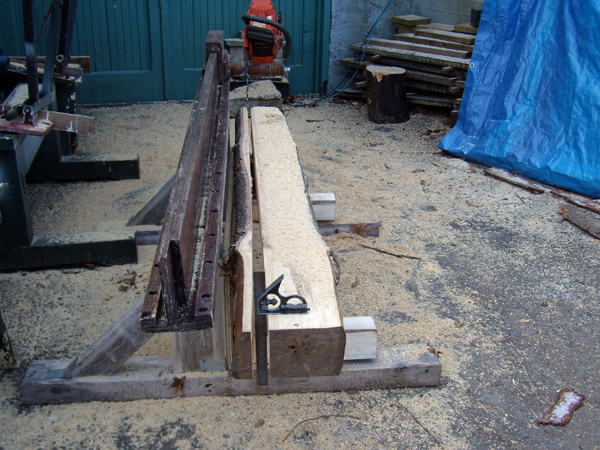

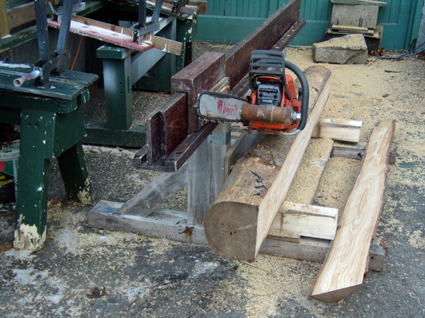

You can get an attachment that clamps to your bar and uses a 2x4 for a guide for about twenty bucks. Use a rip chain [ some are better than others] and go slowly. Should work.:thumbsup:
My home built chainsaw mill.

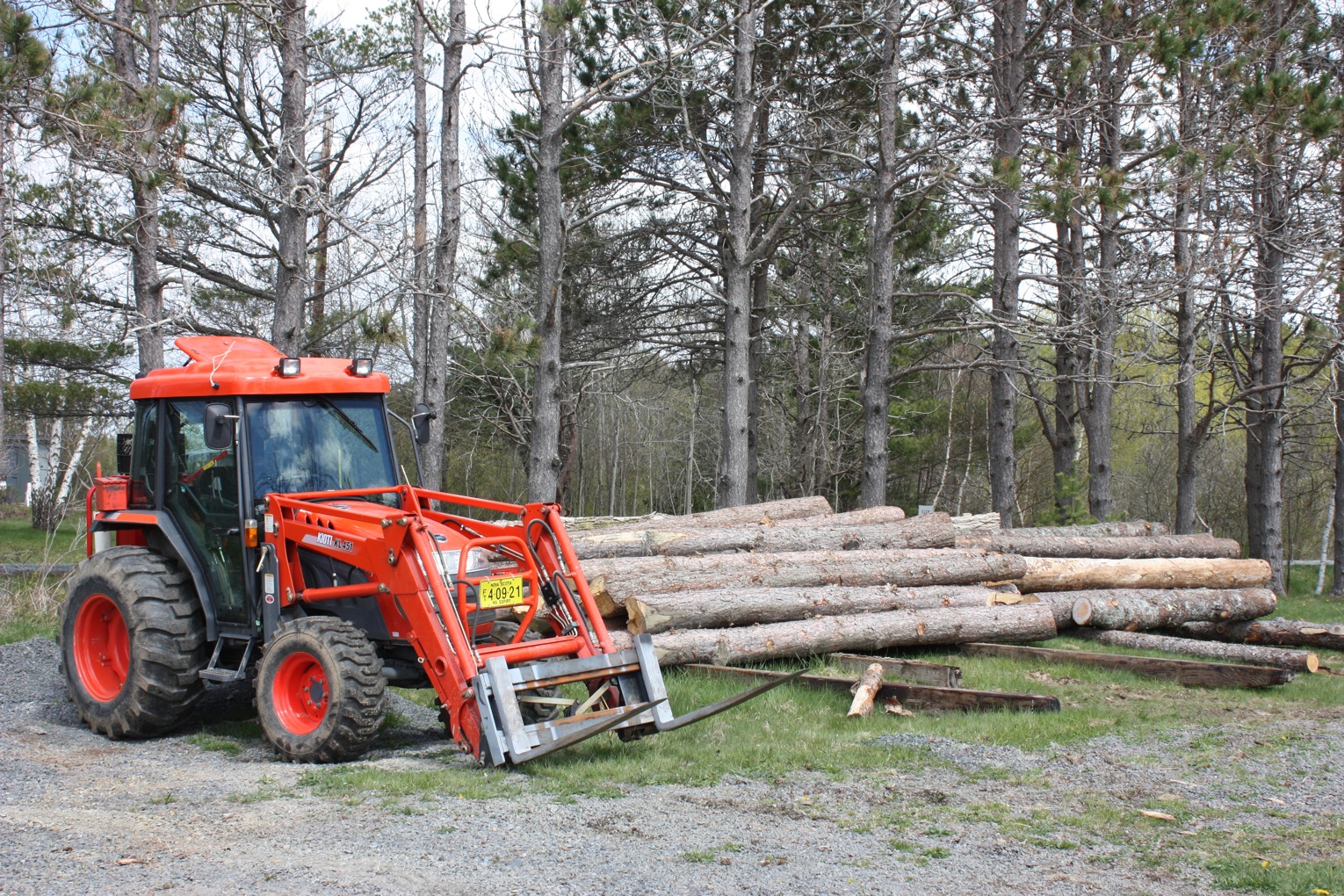

My good buddy has been harvesting locust for "projects" and I keep telling him about the challenge to work it. He is adamant to use the stuff. Most of the logs have been sitting for 10+ months. We will A: see if the mill can saw them, B: see if he can wok with the stuff or C: (which I like) firewood for the next 2-4 years. 1st photo shows a bunch of jack pine, second photo show pile of locust to the right in image.
