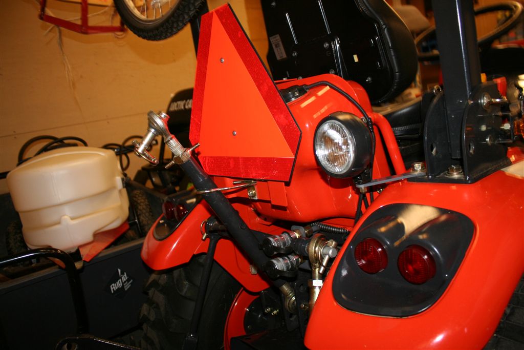

Here is my first work light. I found these rubber cased work lights at Princess Auto for $6. I bought 2 but I only have one installed right now as I still need to mount my SMV sign and I'm not sure if this one will stay in its current location.
Power is from the factory wire harness under the Remote Hydros. Power is only supplied with key ignition is on. So I installed a switch inside the rubber boot of the light. Simple setup but it works.

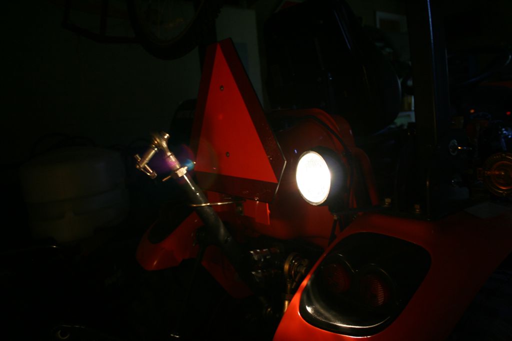

Very nice! Now we need a picture at night to see how well it works. :D
I need to install some rear work lights on my cab this year, hours of snowblowing after work in the short winter days means lots of night time work.

I have yet to see the headlights myself! I'm up too early for work to stay up that late. Will have to wait a month or so for less daylight hours.
/ Work Light - CT230 #4
Don't worry, the loader cross arm takes good care of blocking the headlights usefulness. :D
I'm putting lights on the front of the cab too!

You guys might already be aware of this, but the Kioti factory rear work light with the bracket (actually two, depending on how you want to mount it to the ROPS) is ~$20 from Michigan Iron & Equipment. Works quite well and includes a switch mounted to the light, and proper pigtail to match the factory wiring of course. I'll try to remember to snap a picture.
Thanks for that information, Josh. Didn't know that. I'll check them out. How long did it take you to install them?
/ Work Light - CT230 #8
The install is cake-at least for a CK20S (CT 122). Remove two bolts that attach the right side of the ROPS structure to the tractor, slip this bracket in place and reinstall the bolts. Add the light to the bracket (one more bolt) and connect the two slip-on electrical connectors.
A 10 minute, 1/2 beer job.
The alternator on my tractor says 50 amp, which seems to be stronger than other brands I researched (JD, Kubots). Should be plenty of output for just about all lights. I'm not sure what it can output at idle, though. 50 amps at 14 volts is 700 watts (wattage = voltage * amperage).

I don't have the P/N but Bob @ Michigan Iron can get you setup 517-625-4590, just tell him which model equivalent Kioti tractor you have.
I finally snapped a couple of pictures, see attached. Couldn't get a picture of the wiring because the tractor was backed up to the wall and I was running late for work!
Josh

Josh it looks great. Does the light swivel from side to side?
/ Work Light - CT230 #13
It sure does. And the kit included another bracket which would mount on only the rear of the two bolts and would allow the bracked to swing as well as the light.
