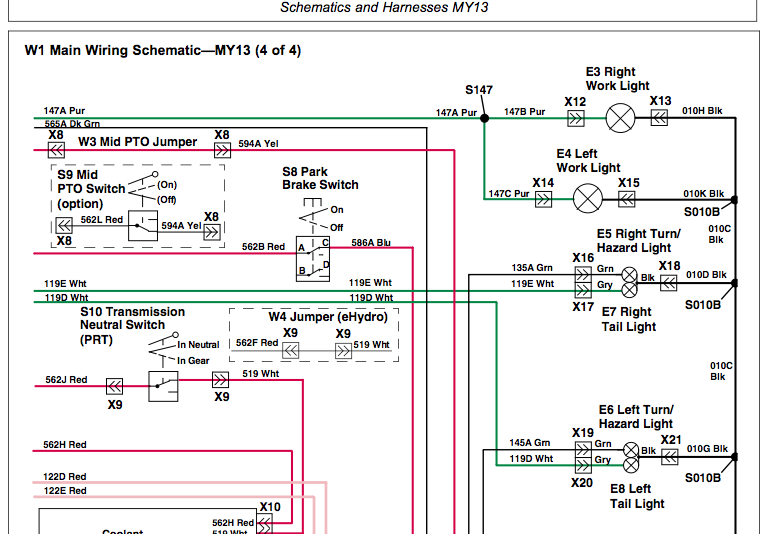

Howdy, hoping someone can point me toward the color and location of the leads for the work lights on a ROPS 3720. I thought i had read some where that they are just sitting somewhere in the rear of the tractor waiting to be tapped into.

Prolly a connector tied up there too.. and I'd look to the left of the seat at the rear (facing the rear).

when you say facing the rear, do you mean looking backwards (i.e. to the right if seated and driving ?
   / work light power feed for 3720 open station #4
"facing the rear" meaning looking at the rear... not the front.
Sitting in the seat, to the left.
That is where mine was located. Doubt the 3720 is different, but could be.

   / work light power feed for 3720 open station #8
   / work light power feed for 3720 open station #9
So it looks like there may be two connectors for adding the rear work lights.. maybe that will make it easier to locate them.. ;)

thanks for your replies, did not realize they had been made,
i ended up just tapping into the power feed for the taillights- works fine but probably not ideal, this does allow the option of combining flashers with work lights which i believe i could not do using the stock set-up
I never did find the work light feed, need to take another look, with all the stuff for 3rd 4th and 5th hydraulic hook-ups its a bit crowded it that area
