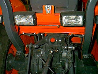

Plowing at night has always been a problem. I mounted a pair of 3''+5" halogen lights to the tool-box
of my L3010. I tapped off a spare hot lead at left rear of tractor,ran all wiring in flex tube inside tool-
box. The weather proof switch was mounted on right fender. Lighting is more than adequate. The lights
also pivot up/down to suite job.

Those look like they'd be very bright.
