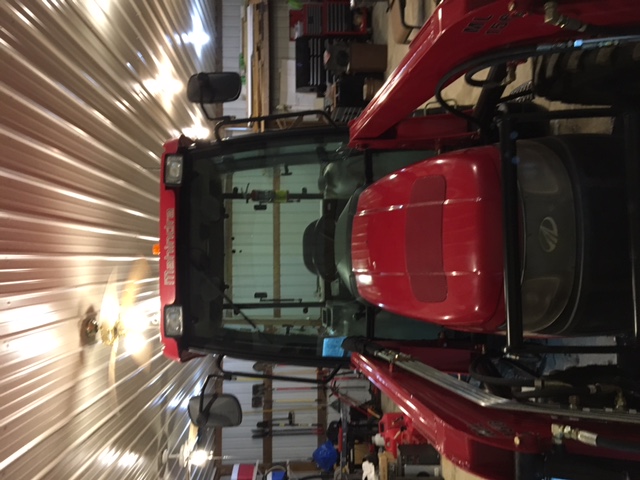

New to the board and loving my Mahindra 5010 Cab. Not so in love with the 4 work lights (2 front and 2 rear ) on the Cab.
Anyone replace these with LED versions? If so, where did you get them?, any suggestions?, and where they easy to swap? Pics would be great. front work lights .JPG

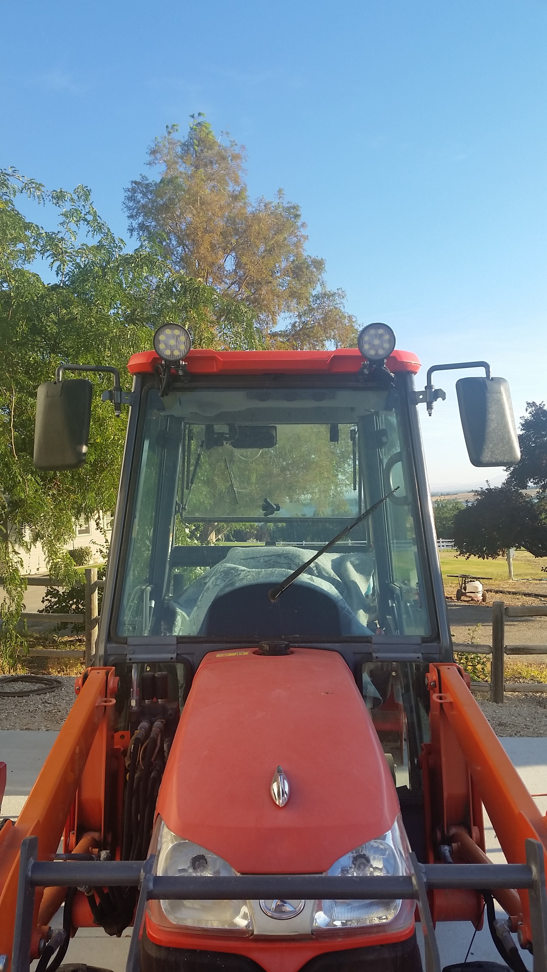

I replaced my front work lights and installed rear work lights (where they didn't exisit before) using 27 watt LED lights. Each unit puts out 2600 lumens. The light output is hard to believe.
I used units I got from Northern Tool & Equipment when they had a big sale and paid $20 each.
My tractor had the wiring located in the cab so all I had to do is cut off the connectors already on the wiring and crimp on new connectors to the wiring and the lights so they matched. Then its simple to plug in to make the connection. I had to make brackets for the rear work lights and modified the brackets already in place for the front work lights.
The pics show the setup I put together.
