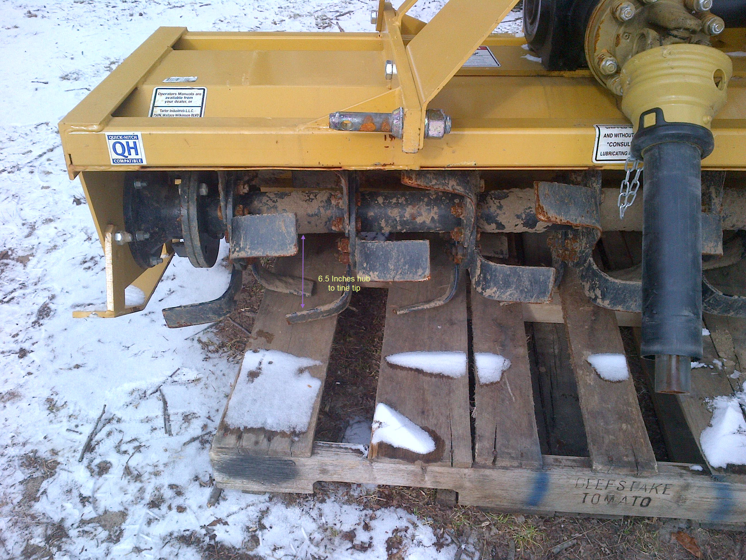

If they would advertise truthfully, you only get approx 4 inches in new ground the first pass with any of these tillers with the same tine scroll diameter. Measure from the tip of you tine to the axle. That is max depth you can get with a couple passes in most soil. Ken Sweet

You're right. Been using a KK 60" tiller for years. 4-6 inches depending on speed and soil type.

I have the CountyLine tiller made by Tarter and its built off the same plans as the KK tiller was for TSC... Or so I was told...
From tine tip to hub is 6.5 inches, but on first pass the skids will not let it go that deep.
I just got mine and have yet to use it but have used tillers on big garden tractors, and in my experience you need 3 passes to get advertised depth.

I always thought they counted the measurement From the top of freshly tilled soil, which is lofty to begin with, to the bottom of the ground being tilled. That's the only way to get the numbers they flaunt because the tiller cannot mathematically till that deep based on the "tine-to-the-axle" measurement as Ken Sweet mentioned. It's sort of technically not fully a lie because the tiller digs itself in on successive passes so the unit can go below grade. Typical advertising.
In practice, I try to break the ground with a cultivator if hard and then till shallow first and then deeper. A staedy diet of compact and dry clay is more abuse than I want to endure.
   / Working Depth of KK Tiller #9
I think that in second and third passes the tiller will dig itself in until the top of the torque tube is level with what would be undisturbed ground. This would make for about 8" depth. I think the tiller depth is also limited by the volume of soil that can be pushed between the top of the torque tube and top of the tiller housing...
