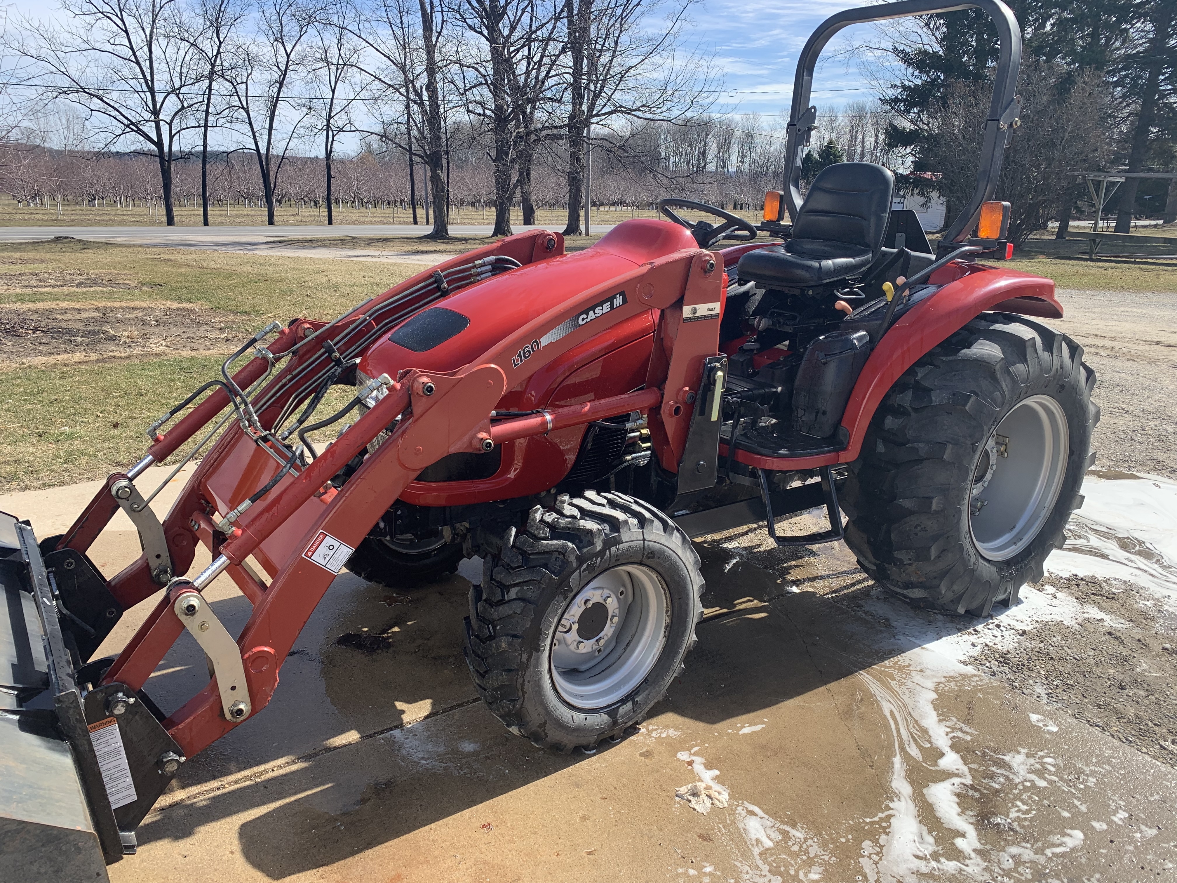

I’ve got a 2004 CIH dx35 which is a twin to the NH tc35D made from 2000-2003 . In 2004 NH changed to tc35da model. According to tractor data the DA models were few hundred lbs lighter . CIH dx35 were identical to tc35D but made tiil
2006.
It appears the oil thru breather issues were all confined to the later A models.
I’ve only owned mine couple years , changed out the glow plugs, 2 of 3 were bad . Not to bad to get to .
Little bit I’ve used it , like it a lot very easy to drive, comfortable to operate, great ergonomics. Very nice operating and stout loader for 35 hp tractor.
Mine has 680hrs , engine nice and quiet.
