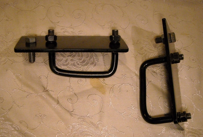

I wanted to mount some worklights on my ROP and with all the posts about welding or drilling the ROP will void its certification, I designed a clamp on mount. The ROP on my BX2660 measures 1-1/2" x 3"
I searched a short time for a small 3 inch inside measurement shackle bolt but could not find a perfect match.

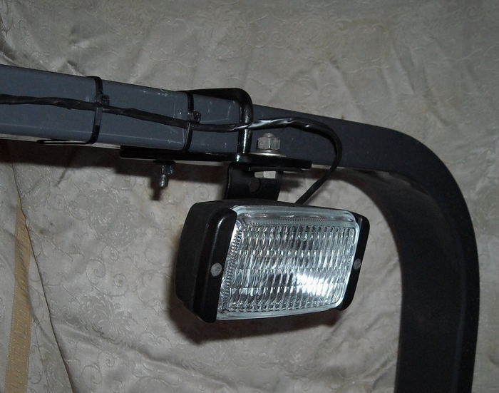

No problem, I'll just make one. Took some 3/8 steel rod, bent it in the shape I needed and threaded it. I then cut some 3/16 plate to 3 inches by 6 inches and drilled 3 holes. Two holes for the shackle bolt and one for the worklight mounting bolt. I made three of them thinking I would mount three worklights. I mounted one rear facing light hanging down from the top of the ROP for the snowblower.
The one light was enough light for snowblowing, plus I do not want to strain my alternator with more lights than absolutly necessary.
I now have two extra light mounts and hate to just throw them in my metal scrap bin. If anyone is seriously planning on mounting worklights to their ROP and like my design, you may have them.
Only have the two, so first come first served. Just reply to this thread and state if you want one or both.
Please do not give out your personal information on here. I will send you a private message for your mailing address.
