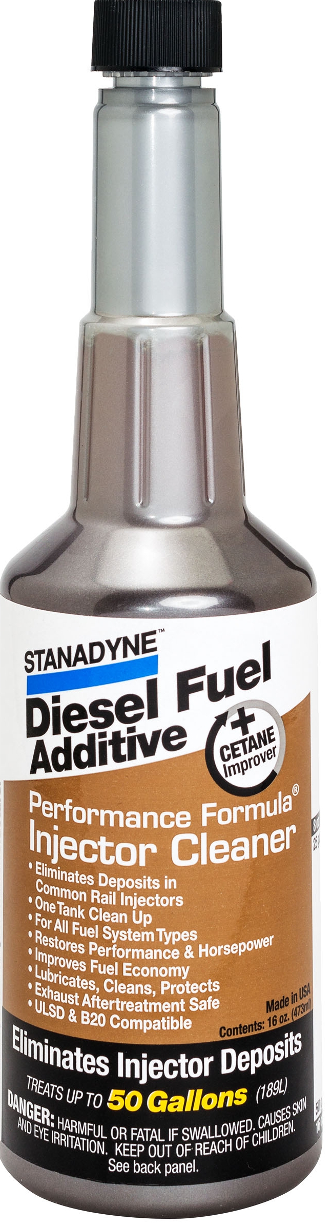

Well..... I *guess* I fixed it. :confused: I poured a couple ounces of this stuff in my fuel tank. test.jpeg Before I fired it up, I remembered reading in another thread where someone said check the vent on the gas cap. I figured what the heck, so I took the gas cap off. It has a little liner that comes down in the middle with a hole and then there's a groove in the threads so air comes from underneath. There was some kind of trash completely filling that groove, so maybe it wasn't venting properly. I cleaned out that groove, fired it up and it ran fine the rest of the day. Go figure. :thumbsup: I do think I'm not running it hard enough though to clean out the DPF so I'll use the cleaner I bought when it gets here and I'll run it at a higher rpm. I let it idle a lot and I only run it at 2K rpm unless I'm using the PTO and then I run it where the line is at 2400 rpm for pto devices. I guess I should run it all the time at 2400 and not let it idle so much. Anyway, thanks for the suggestions!

Stanadyne is widely respected...good stuff!
You should consider using it regularly.
   / Workmaster 33 won't run
I was until I started treating the whole drum with the Diesel Kleen. Probably wouldn't hurt to run the Stanadyne through periodically as well.
