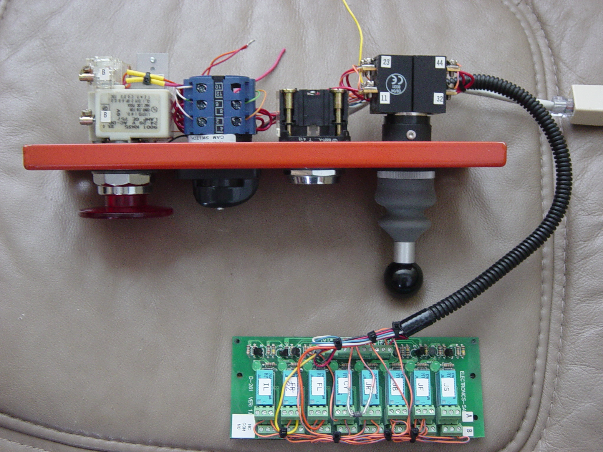

And if it's not, I would love to see it, or them. I had nothing to go on for ideas, in building this.
I have used many splitters, and never liked a one. So I built my own. Some components were Wallenstein, surplus items.

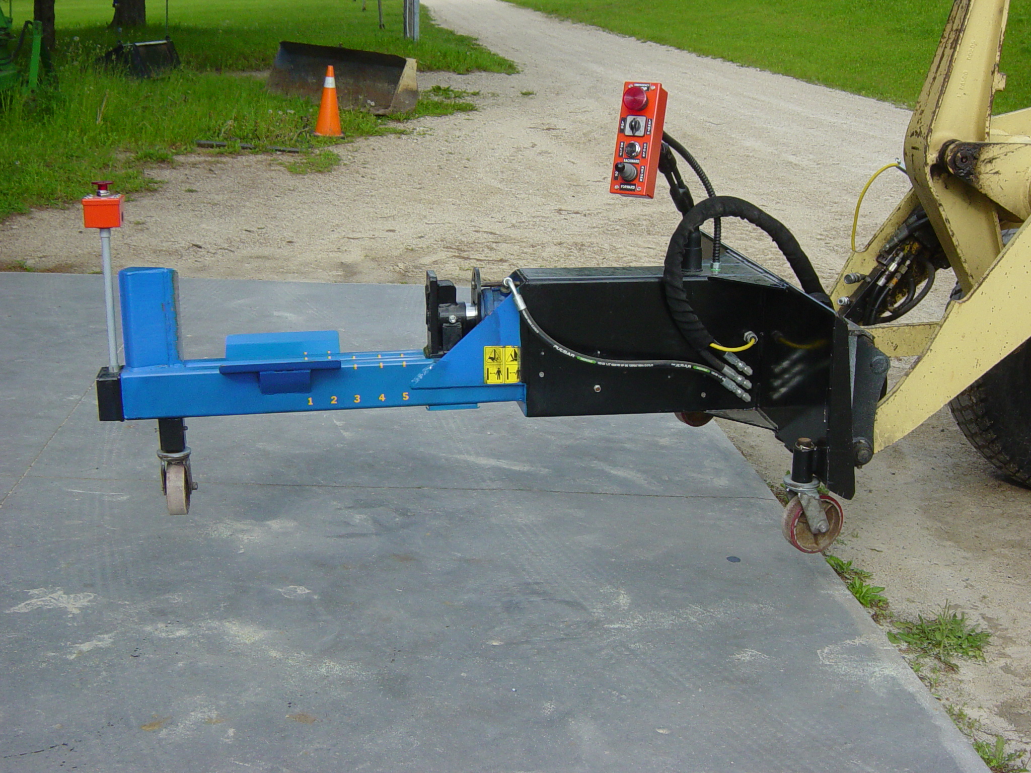

Splitter Finished.JPG FINISHED!

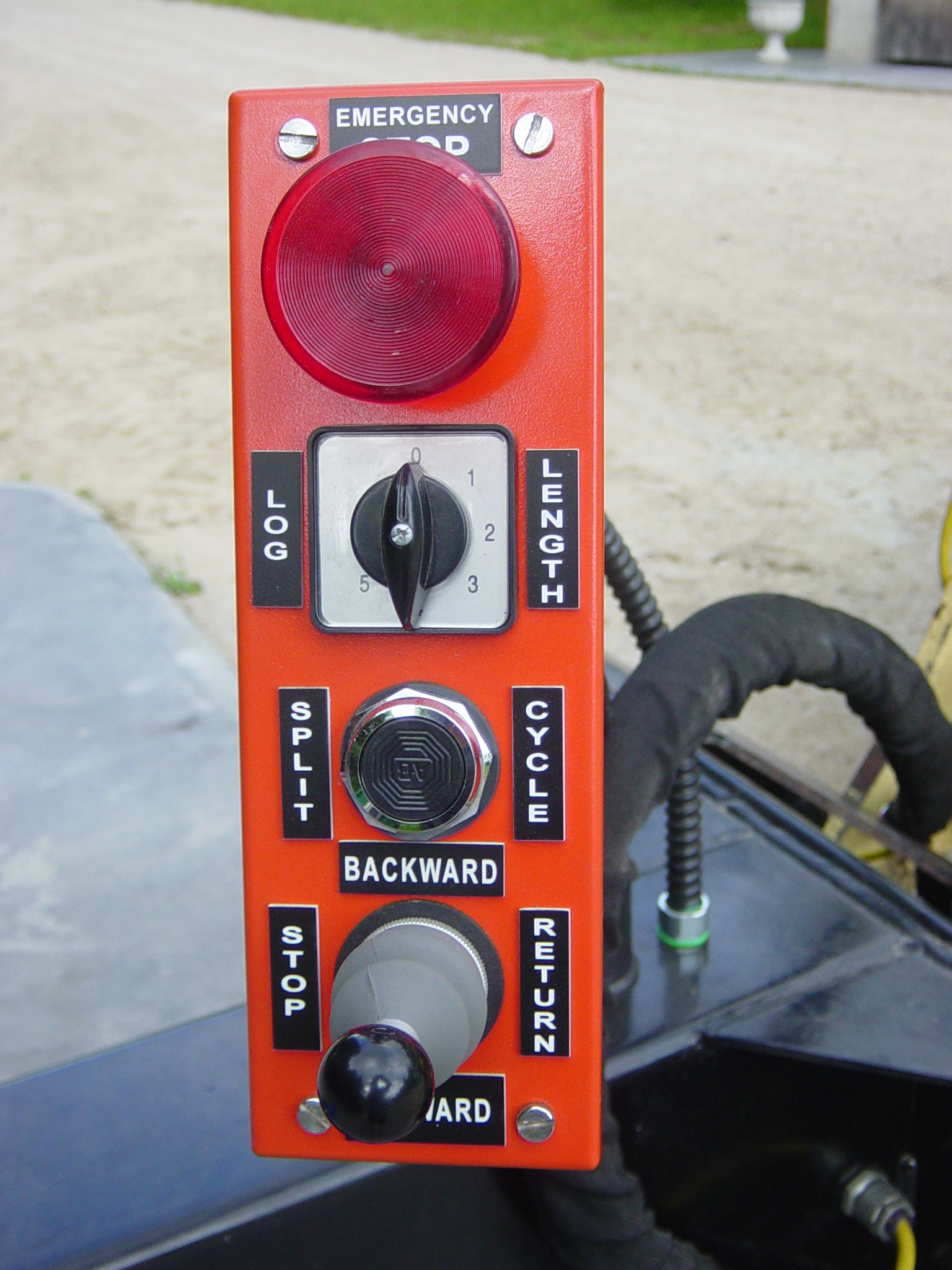

Splitter Control.JPG Moveable Control Console. Pretty much shows features.

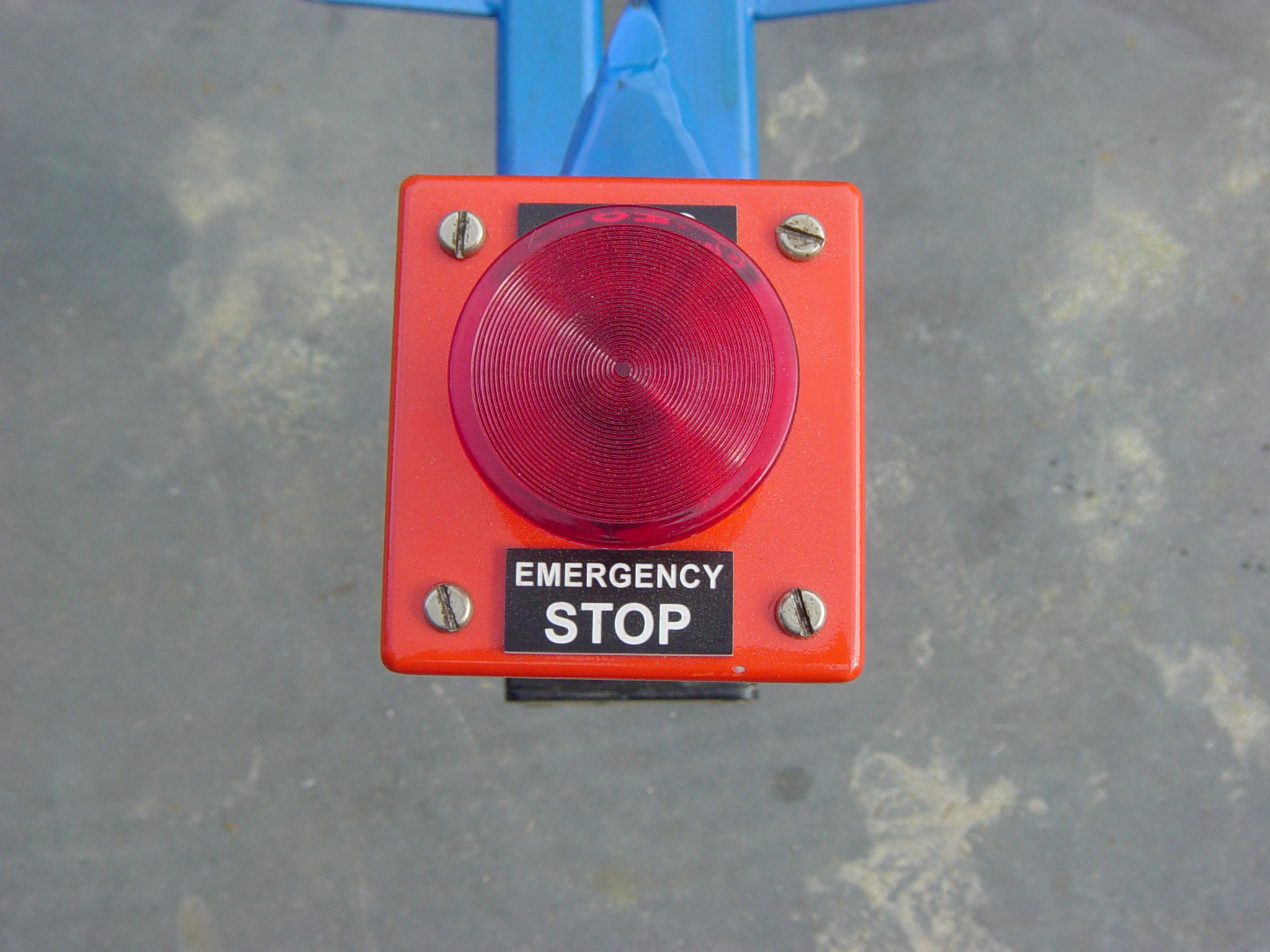

Splitter E Stop.JPG Far side E-Stop. Buttons Illuminate to Indicate Power and Alternate when the RAM is in motion.

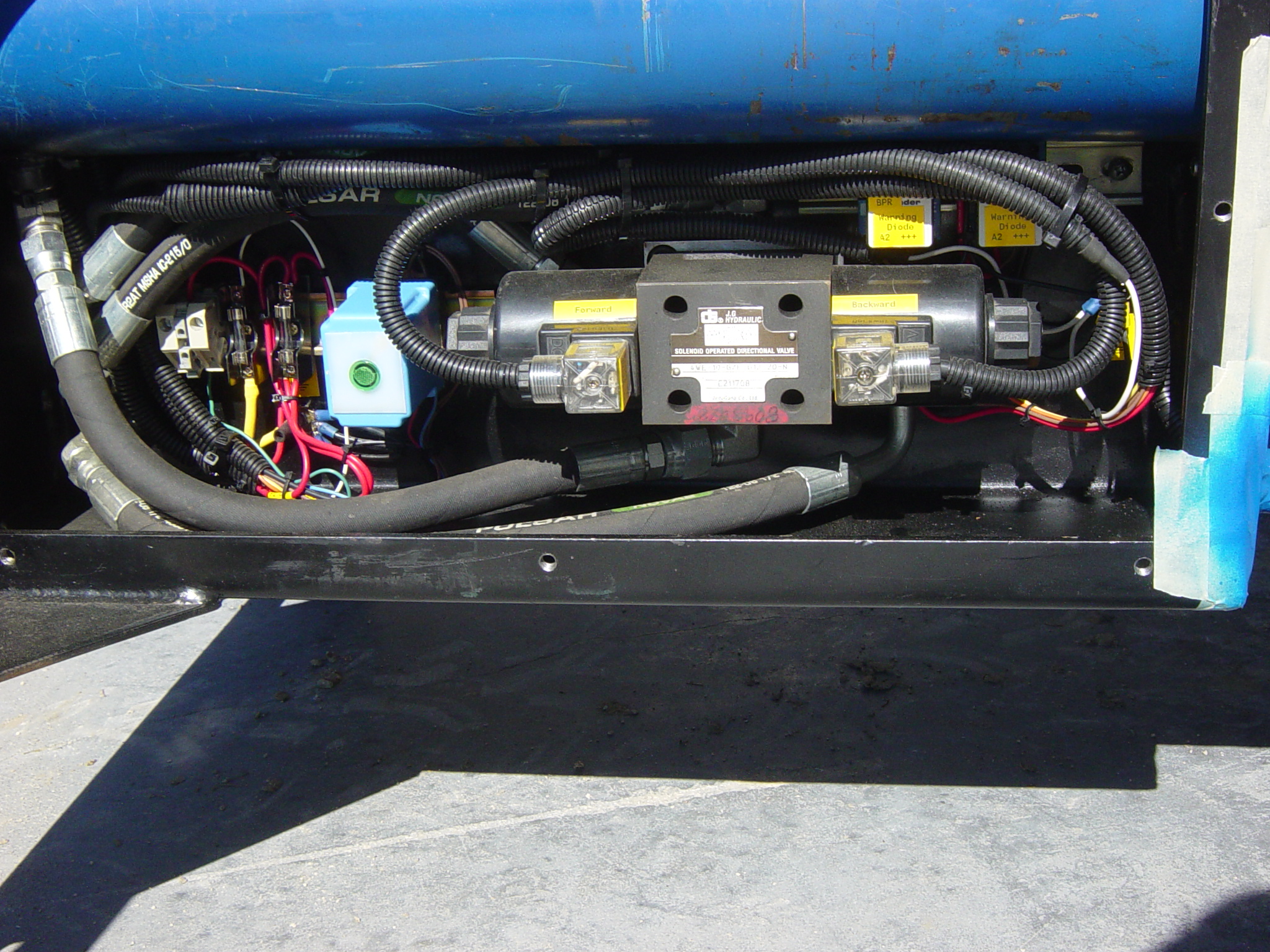

Splitter Main.JPG Main Equipment Cabinet. I would have liked to put ALL electrical control equipment in one oil tight box, but ran out of room.
DSC04806.JPG Relay Logic Board, that I had to put in console.
Unit Goes ON or Off in Seconds, Scaffold Castors can come off. A woman can move the thing around for storage easily.
Loader is just purring away at just above idle. Can't stand noisy splitters.
Button does split cycle. Never liked standing there like a bump on a log, when I could be stacking wood.
Variable back stop positions. This has proved to be more usefull and a time saver than I anticipated. Joystick can over ride this at any time.
Joystick mimicks any other splitter if required.
Loader can adjust height as desired. It could go vertical, but with the wedge at the end, would not make much sense. Those are the components I got, but would put the flat plate at the end if I had to do it again, for vertical splitting.

As a Controls Engineer, I love the electro-hydraulic control scheme. Brilliantly unnecessarily sophisticated. Very nice, professional; I'm envious. The only borderline negative thing I have to say about it, is your e-stop on the end sticks out like a sore thumb and IMO is begging to be knocked off by a stray piece of wood. I might be wrong. Time will tell.

I sheared the end E-Stop off on the first trial on a very large log! The PVC fittings are not glued and can move it out of the way, but I should think of some other approach.
The controls are all industrial, and mounted on a flexible arm, so some impact should be absorbed.

Log tables would be some sort of flat surface on each side of the beam so that when you splits a large round, the halves don't fall to the ground and have to be lifted back up to be split again. Mine seem to save a lot of lifting.

Most of the good splitters (wolf ridge, timberwolf, wallenstein etc) have tables available, you can look at them for ideas. I added one to my horizontal/vertical type and it's a huge back saver. I need a table on the other side too. Since yours is a push through your table would be on the other side of the wedge. I wish I had a horizontal push through with a table and lift but I got mine cheap and it works (in horizontal mode, vertical is pretty useless).
What's the difference between "return" and "backwards"? Return goes all the way back with one touch and backwards is momentary?
