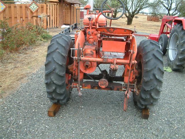

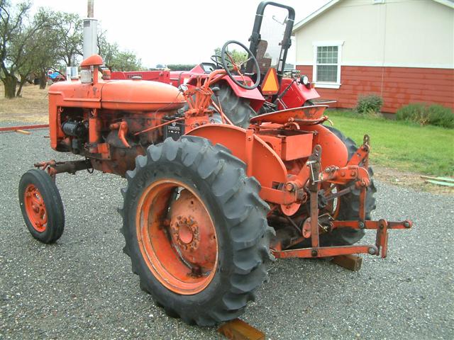

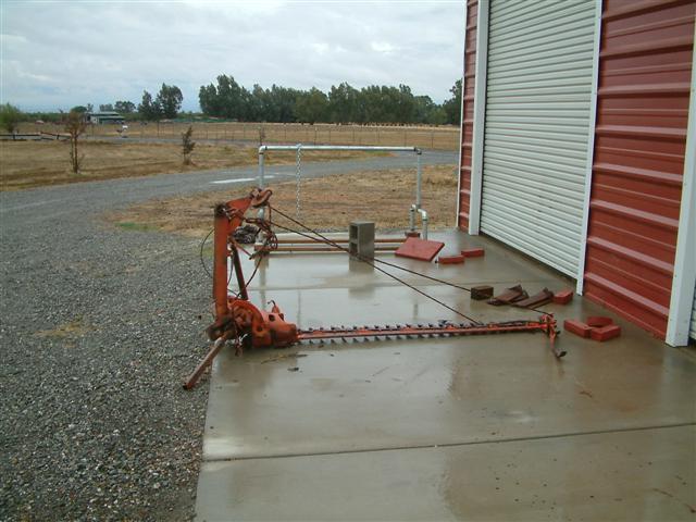

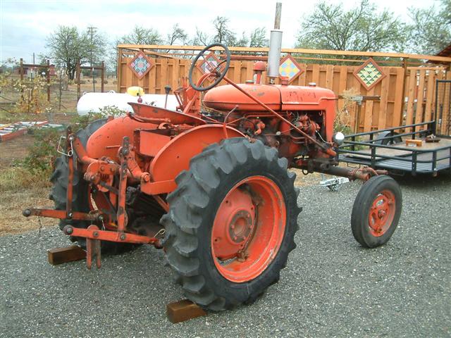

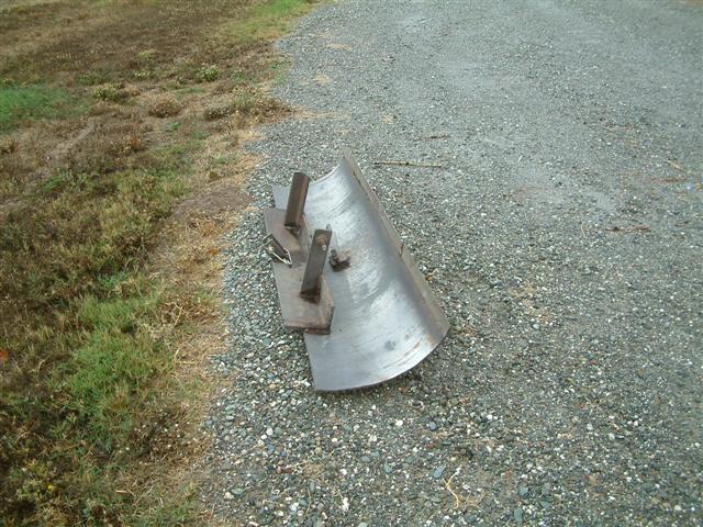

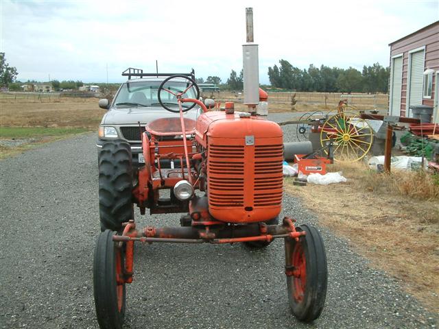

I have a 1951 Farmall Super A tractor (19 hp engine, 16 hp pto) that I bought for $1300 off craigslist including a mid-mounted 6-ft sicklebar mower and a 5-ft wide scraper blade. It has a hydraulic 3-point hitch--somewhat unusual for a Farmall of this vintage which usually had a 2-point hitch. Caltrans owned this tractor (for mowing highway ditches) and added an aftermarket 3-point hitch to this one.
DSCF0126 (Small).JPGDSCF0127 (Small).JPGDSCF0128 (Small).JPGDSCF0129 (Small).JPGDSCF0130 (Small).JPGDSCF0131 (Small).JPG
A little tractor like this will do the jobs you listed--maybe not as quickly as a more powerful tractor. YOu could probably bush hog your two acres in 3 hours or so.
Parts are readily available and not overly expensive.
You don't have to spend a lot of bucks for big horsepower if you shop around for deals like this one.
Go to YouTube and check out the videos on Super A's like this one to see it do it's stuff. Then decide if you need more hp to work on your food plot.
Good luck.
View attachment 217388View attachment 217389View attachment 217390View attachment 217391View attachment 217392View attachment 217393
Good luck.
Wow I grew up with one of those, I think ours was a 49, but not sure, I have never seen one before with a 3pt. our was a 2pt of course. I think I first drove it when I was about 8 or 9, first gear only, Dad set the throttle. I can still remember every little detail about that tractor, from the pull ring for the choke on the left to the starter pull ring on the right, and the little zinc ignition switch by the one and only fuse. Ours had some cultivatar tines in the middle that were hydraulic operated. Those pics sure bring back memories.. Thanks.
