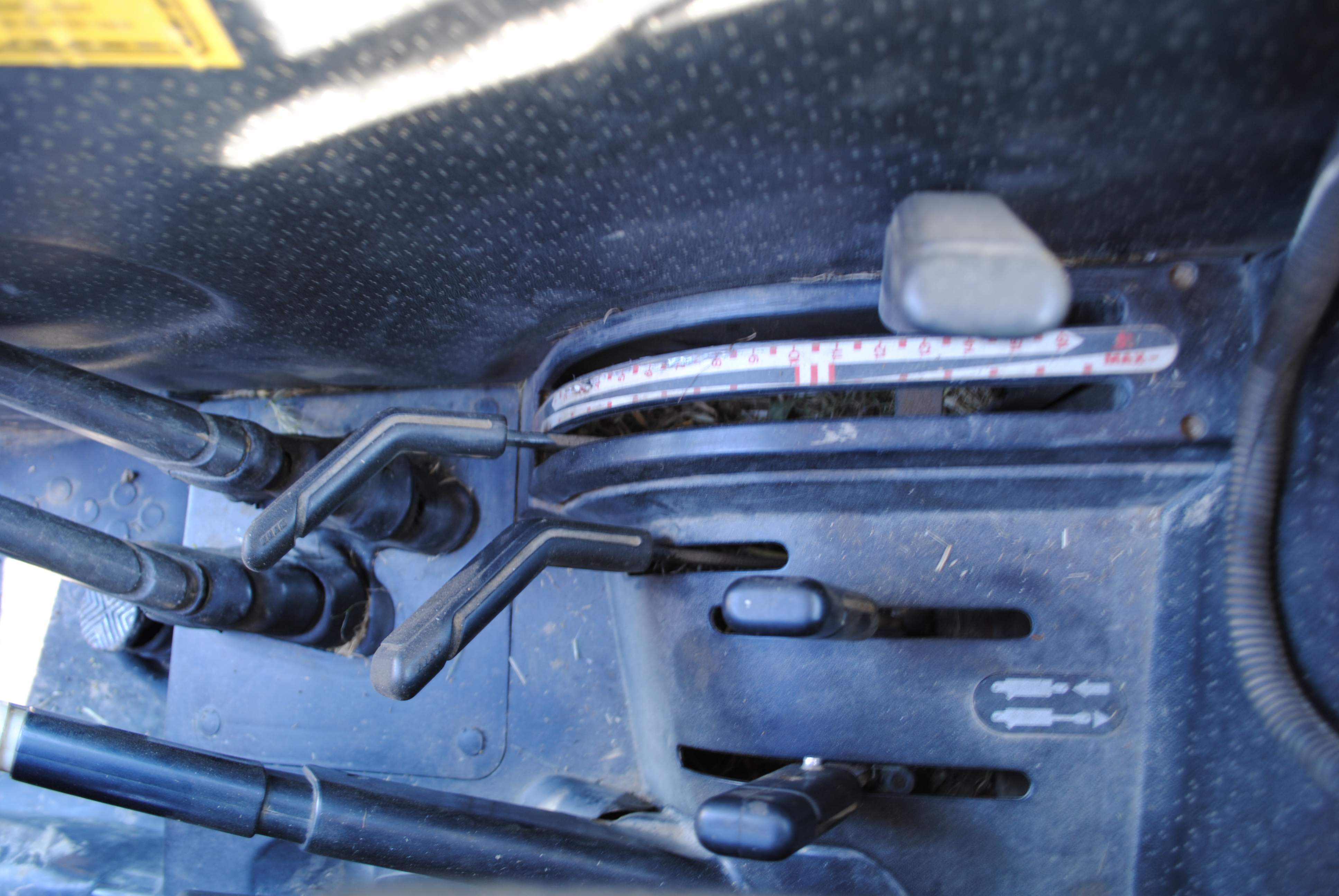

Would anyone be able to tell me the different levers in a Fiatagri tractor?
If so please reply, I'm talking about the levers on the right side with the hitch, liftarms clutch brake etc.. I need to know which is which

G'day post or send me a pic of the levers you are talking about and we will see how we go

I was wondering if you received an answer to your question re the levers on the Fiatagri tractor. We have just acquired an 80 90 Fiat - the 3 point linkage will raise but will not lower - could it be something to do with the lever settings. We didn't get a manual with the tractor and like you we are not sure what the levers are?

Put weight on the 3 pt. and see if it goes down. Most just use gravity, no down pressure.

Most 90 series tracors have a black plastic thumblatch on the right fender, It is a return to depth feature that raises the lift to full up, and operates independantly of the two three point levers. It has a cable that leads down to some linkage on the right side of the lift housing near the rockshaft. Have you tried cycling this latch?
