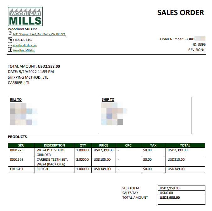

I like it very well but by the time I paid import tax, storage and shipping I still paid $2000 but I did get the extra bits.
Right at $3000 now with some extra bits and shipping.
